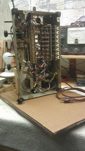

I want to show you the neat little fixture that I started using while doing this radio.  Just go to your local home supply store and find one of these 12 inch turntables.  Then add on a large enough piece of plywood to support the most common size radio you will work on.  Being able to spin the radio easily and work on it from all directions is a real time saver!
