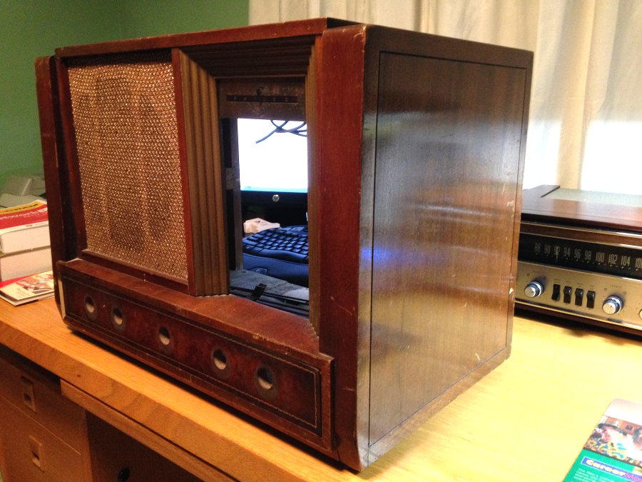

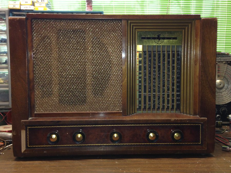

The next project:
[Image: http://www.philcoradio.com/images/phorum...e00001.jpg]

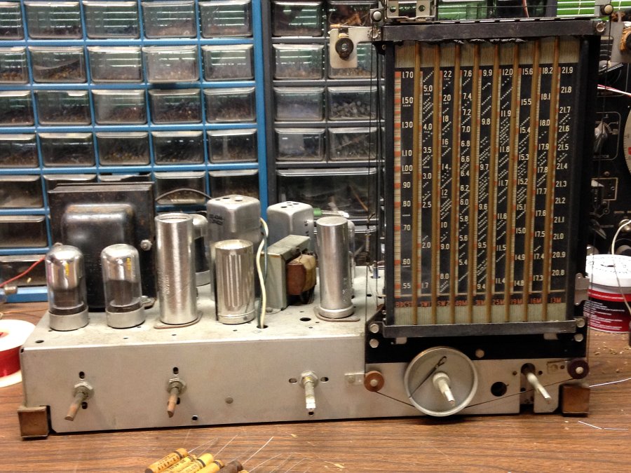

My Philco 53-960. That's just the empty cabinet; here's the chassis.
[Image: http://www.philcoradio.com/images/phorum...e00003.jpg]
I'm on a Tropic kick lately; I've decided to get as many of my Philco Tropic (and Tropic-like) sets going as I can while I have lots of free time to do so.
The 53-960's roots lie in its nine-year-older ancestor, the 42-760 Tropic. The main difference between the two is the addition of a "49 meter band" which actually covers the 49 and 41 meter bands. Plus, the 53-960 has a separate radio-phono switch; switching to phono mode is part of the function of the band switch in the earlier Tropic versions.

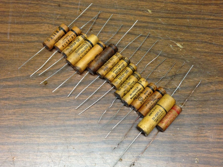

The first job was to restuff a set of paper capacitors.
[Image: http://www.philcoradio.com/images/phorum...e00002.jpg]
Many of these caps are courtesy of Phorum member Kekoa; thanks again!
I decided it would make things simpler if I had a set of restuffed caps ready to go into the set when I began working on it.

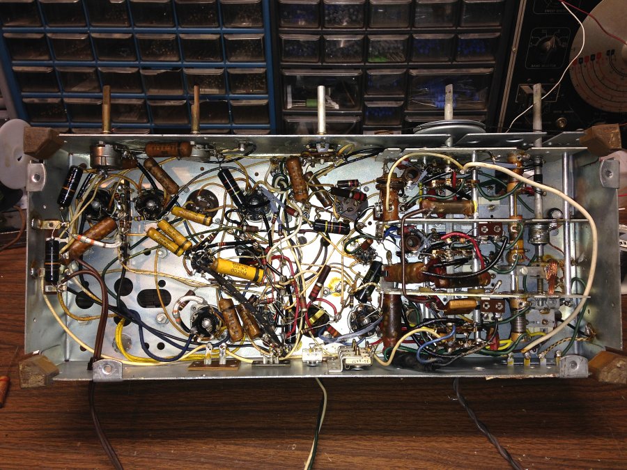

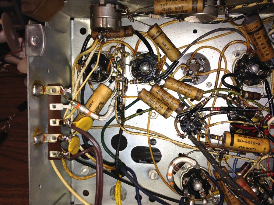

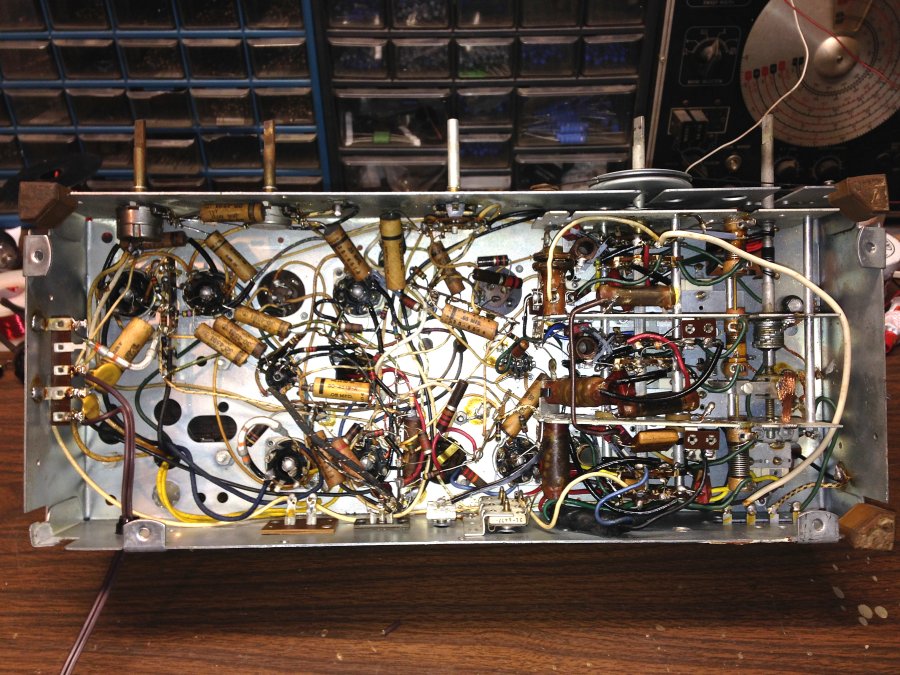

Let's look under the hood:
[Image: http://www.philcoradio.com/images/phorum...e00004.jpg]

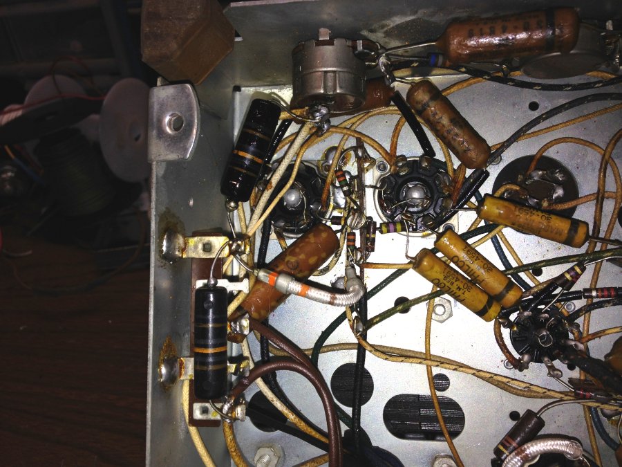

Mostly paper caps, along with a few of those bumblebee caps which the guitar guys love but due to their age, really are no longer any good as capacitors.
Look close - two of those bumblebees are being used as line bypass caps!
[Image: http://www.philcoradio.com/images/phorum...e00005.jpg]
Those will be replaced with X1/Y2 safety caps.
Several hours later, every paper cap has been replaced:
[Image: http://www.philcoradio.com/images/phorum...e00006.jpg]
I only replaced a few of the resistors. If I need to replace more, I will do so.

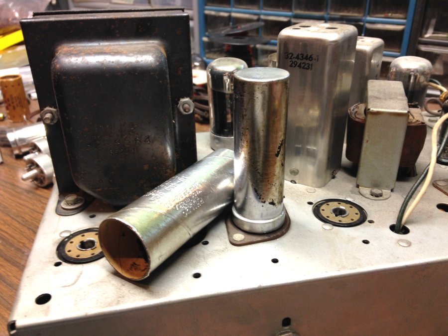

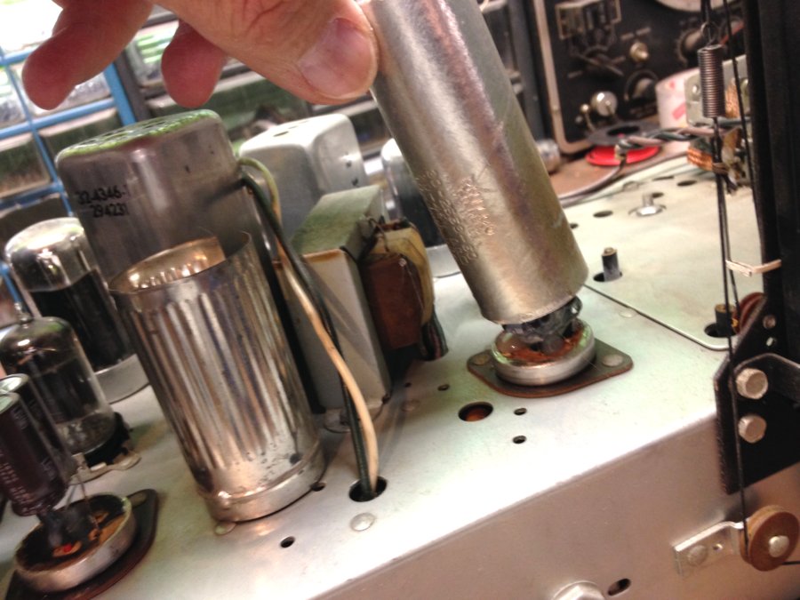

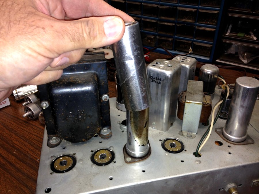

Not much progress the past two days. Yesterday, I removed the cover from one of the electrolytics:
[Image: http://www.philcoradio.com/images/phorum...e00008.jpg]
[Image: http://www.philcoradio.com/images/phorum...e00009.jpg]
I had to use a heat gun to melt the tar underneath, which held this cover in place, until it softened enough to allow removal.
I also have a 53-960 parts chassis; one of its electrolytics also has a cover over it like this. Using the same technique, I also removed that cover. My plan is to use these to cover both electrolytics once rebuilt.

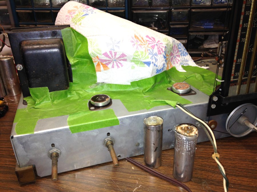

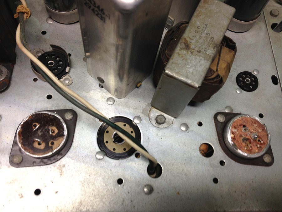

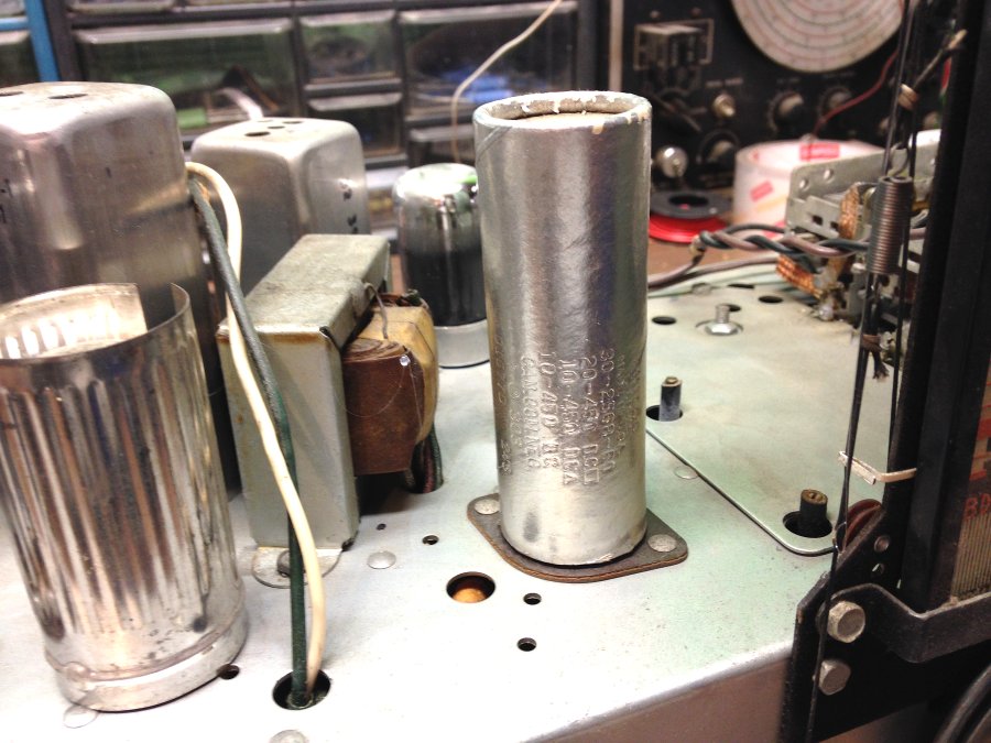

Today, I tried to mask off the area surrounding both electrolytic cans. Then, using a cutter wheel on my Ryobi "Dremel" tool, I cut the tops of both cans off:
[Image: http://www.philcoradio.com/images/phorum...e00010.jpg]
Despite my attempt at masking off the surrounding area, some aluminum dust still managed to get through the tape and paper towel. I used a can of compressed air to spray air over the entire area, top and bottom. I hope I was able to get all of it off (and out of) the radio chassis.
The next step was to drill holes in the bases of the old electrolytic cans for the leads of the new electrolytics:
[Image: http://www.philcoradio.com/images/phorum...e00011.jpg]
The holes were drilled from the bottom, so the positive leads will be going right against the proper solder terminals on the base of the old electrolytic cans.
I forgot that the two 10 uF sections are connected in parallel in the electrolytic to the left in the photo above - so I drilled one hole that was not needed. That's OK. I will be using a single 22 uF to replace those two 10 uF sections.

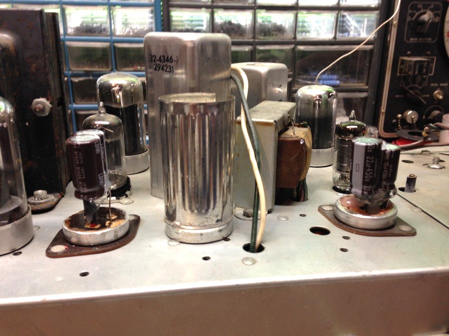

Electrolytics have arrived!
So this afternoon, they were all installed...
[Image: http://www.philcoradio.com/images/phorum...e00012.jpg]
The metal can probably would have fit over the top of the two 22 uF caps on the left...but I don't think the can would fit over the caps on the right.
But that's okay...I had planned for that...
[Image: http://www.philcoradio.com/images/phorum...e00013.jpg]
Now you can see why I wanted two of those capacitor covers - which are thick paper with what appears to be thin aluminum foil over the top.
[Image: http://www.philcoradio.com/images/phorum...e00014.jpg]
[Image: http://www.philcoradio.com/images/phorum...e00015.jpg]
Now all of the new electrolytics are neatly covered...and it looks like a factory job.

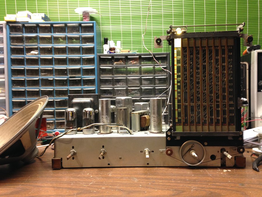

[Image: http://www.philcoradio.com/images/phorum...e00016.jpg]
So this evening while waiting for 18,427 updates to install on what is now a new, clean Windows 8 system, I decided it was time to give the 53-960 a try - and it came to life with no issues at all.
I tried it out on AM, both SW bands, and on the 49/41 and 31 meter spread bands, and heard stations on all of those bands. It really sounds good with its 10 inch PM speaker, too.

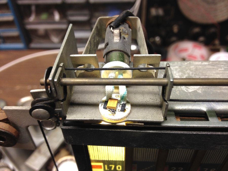

Notice that the dial lamp is nice and bright? That is no ordinary #44 lamp...
[Image: http://www.philcoradio.com/images/phorum...e00017.jpg]
This is a special 6 volt AC/DC LED lamp with flexible leads. Just the trick for this radio's dial, and the illumination is excellent. It's an Ablaze Premium Ghost Buster 1-SMD LED lamp in Warm White, from Pinball Life.
http://www.pinballlife.com/index.php?p=product&id=3108
At 89 cents in quantities of 10 or more, they are priced low enough that they are well worth considering for our vintage radios...and they should last much longer than a typical 44 lamp while using less current. I had bought a few of these several months ago, and I felt one would work perfectly in this radio. I think I was right
