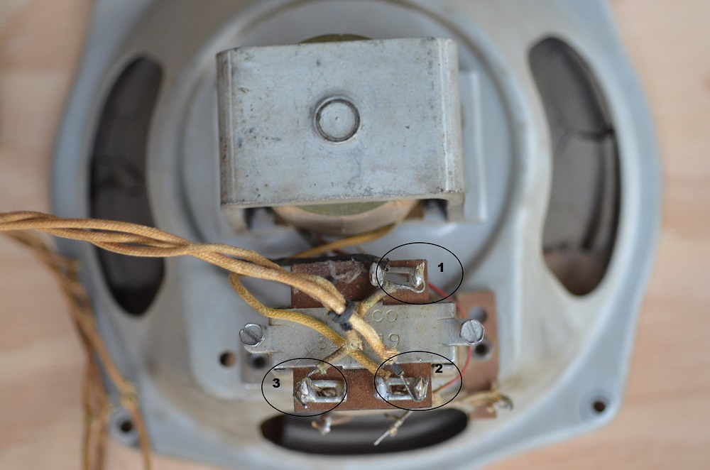

I have a 640-B that upon removal from the cabinet i lost the orientation of the speaker wires.
would you guys be able to look at the pictures below and let me know how to re-orient them?

Well, first off, the photos shown are not of a 640. Probably a 620 or 625. Model 630 and larger all have speaker sockets; 620B and 610B tombstones have hard-wired speakers.
A 640 speaker would have four terminals above the audio output transformer on the speaker; this one only has three, so it is a single-ended output, which also points away from a 640.

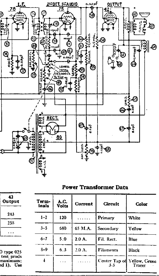

so here's the section of the schematic that shows the transformer and mentions the center tap.
the components are listed as follows:
62 = output transformer
63 = voice coil and cone assembly
64 = field coil and pot assembly
71 = power transformer
do you mind walking me through identifying things?
Ok
The three wires are likely to be:
1. The end of 64 field coil that goes to cap 66 and rectifier filament and power trans pin 6.
2. The second end of 64 FC that goes to one end of the audio xfmr primary (connects to 42 Screen Grid)
3. The other end of audio xfmr primary (goes to plate of 42 tube).
Now.
Mesure ohms between any two prongs.
Write down the resistance. It can be:
1. 1.1 kOhm
2. 400 Ohm
3. 1.5 kOhm (sum of the above).
Now. Choose the combination that gives you 1.5kOhm.
Mark the pins A and B.
Measure from any of the two to the third pin which you mark as C.
Lets say If it is 400 Ohm it is your auio primary and then
pin A is your 42 plate
pin B is your FC rectifier end
Pin C is your FC connected to audio xfmr primary.
Connect
A to 42 Plate,
B to The end of 64 field coil that goes to cap 66 and rectifier filament and power trans pin 6, and
C to the Screen Grid of 42.
