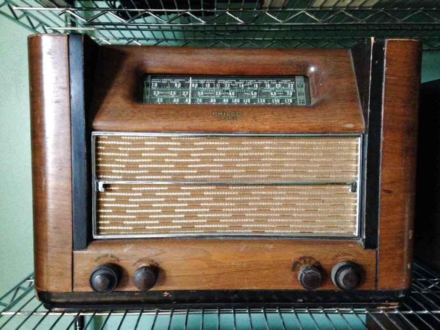

This is the only Philco I am aware of that has a chrome grille! I'll post a photo when this set is done. Right now, it needs grille cloth. I have some that I have been saving for this set, and it will be installed in the next few days.

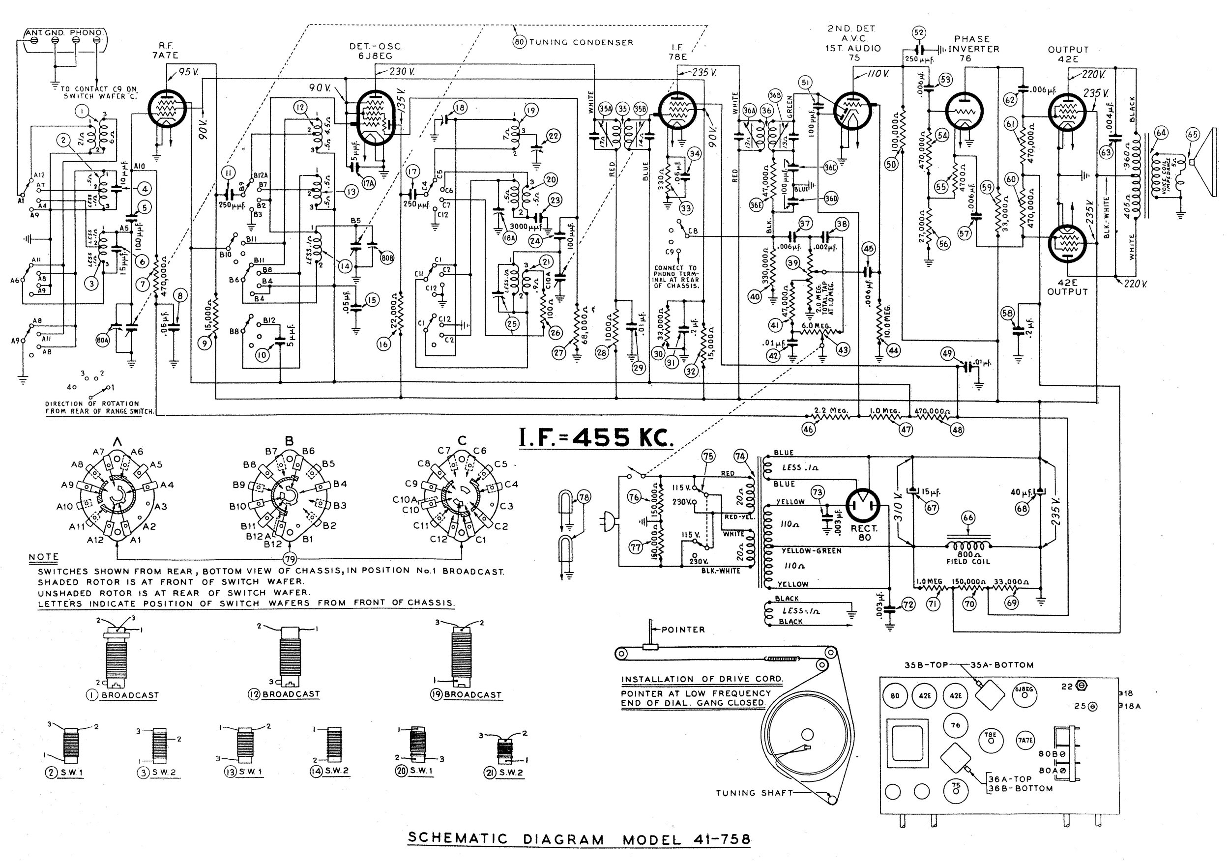

If you want to follow along, you can see a 41-758EZ schematic here (766 KB).

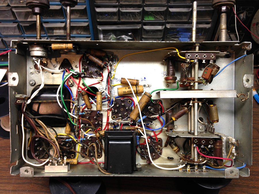

So far, all I have done is pull everything out of the cabinet, and taken notes on where the paper capacitors connect under the chassis as well as wiring for the audio output transformer. The plan is to remove those components, restuff the paper caps, replace the wiring and all resistors, then install the restuffed caps and finally, reinstall the audio output transformer. The electrolytic cans will also be rebuilt, and a new power cord attached. I will also have to restring the dial cord as the cord on this one is broken.

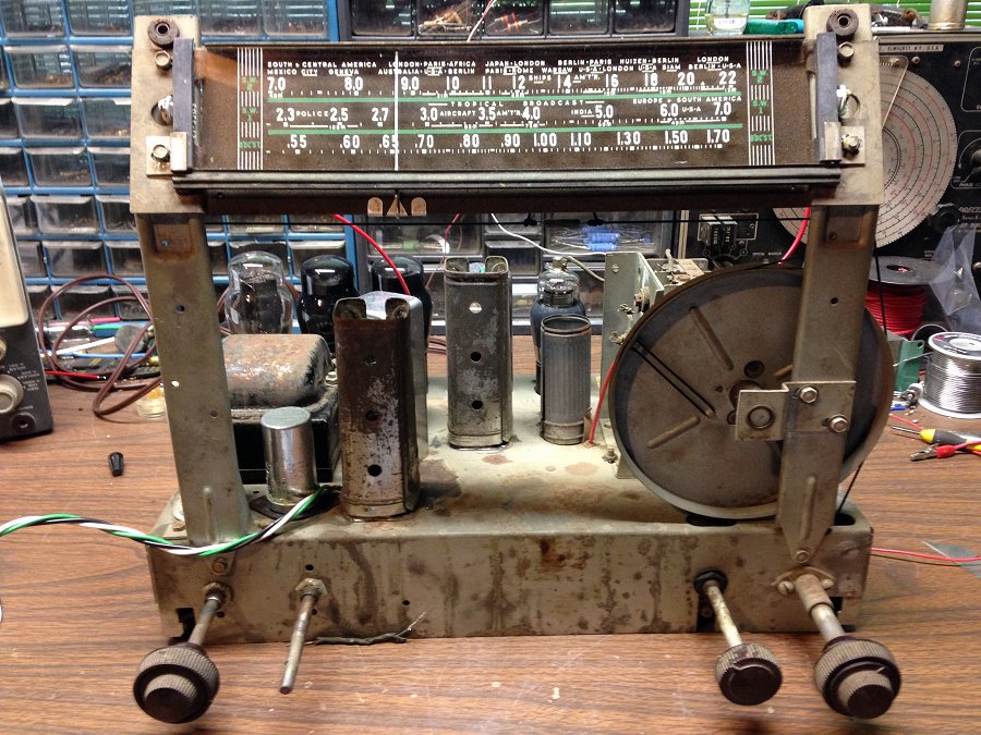

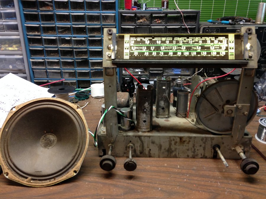

This is the front view of the 41-758EZ chassis. If you followed my Philco Canada 39/41-722 Tropic restoration thread, you will see that this 758 is mostly identical in appearance to the 39.

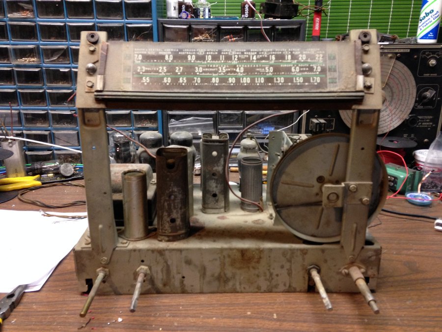

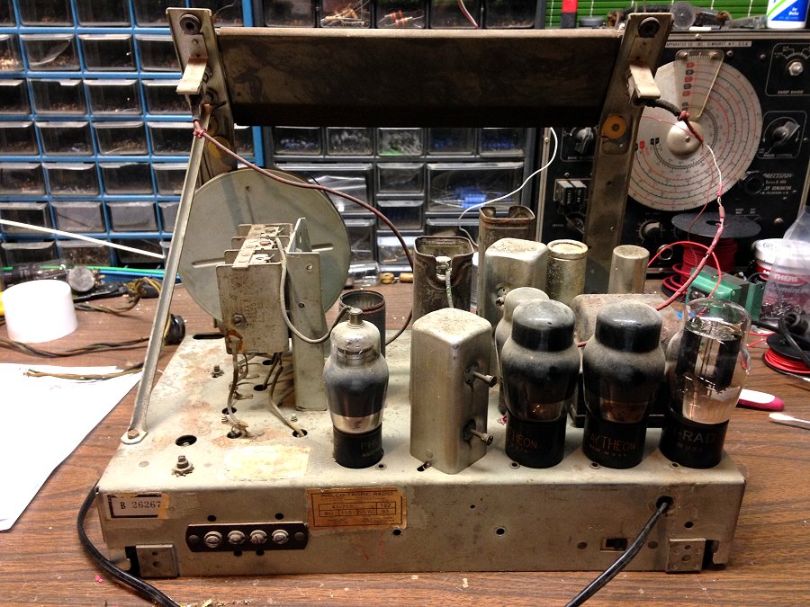

Back view of the 41-758 chassis.

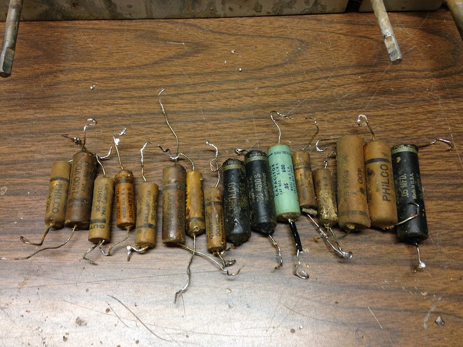

I started working on it before I remembered to take a "before" picture; pardon me. As you can see, I've already removed all of the paper capacitors...
[Image: http://www.philcoradio.com/images/phorum...e00004.jpg]
...and here they are.
I will now be replacing each wire and replacing all of the old resistors, before I restuff and reinstall the paper caps.

Another enjoyable adventure to follow Ron. The underside of that chassis sure looks tidy with those caps out!

The underside looks very clean. I'm usually not that fortunate with most of the radios I get.

It's not bad, really. Now, the topside of the chassis is pretty grungy, with a rust spot or two. I have not yet decided how to go about cleaning it.

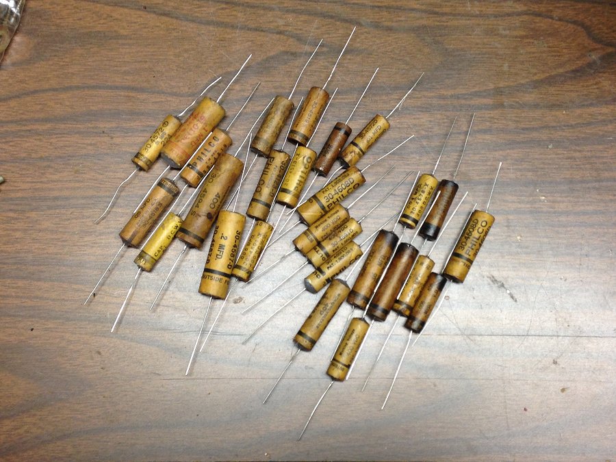

I haven't touched the radio in a couple days, but today I cooked all of the old paper caps in a recent acquisition - a used toaster oven. I left a few in too long and they became burned on the ends; otherwise, this process worked well.
Each cap was removed from the oven, one by one, and the old "guts" removed and the outer shells wiped off.
I then restuffed them with new capacitors.
Here they are - yes, there are more here than in the last picture, as I "cooked" some extras for the next project:

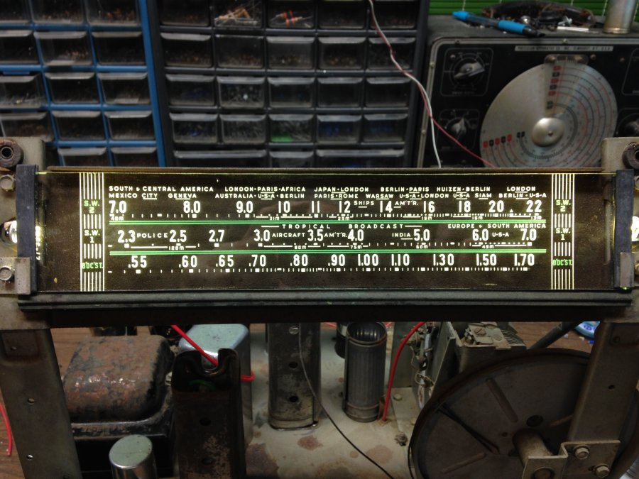

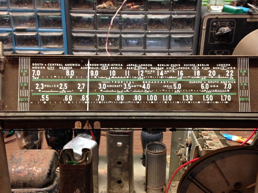

Tonight, I finished the radio except for restringing the dial cord. Here it is, on the bench, playing:
[Image: http://www.philcoradio.com/images/phorum...e00006.jpg]
Notice how nice and bright the dial is.
[Image: http://www.philcoradio.com/images/phorum...e00007.jpg]
There is good reason for that...

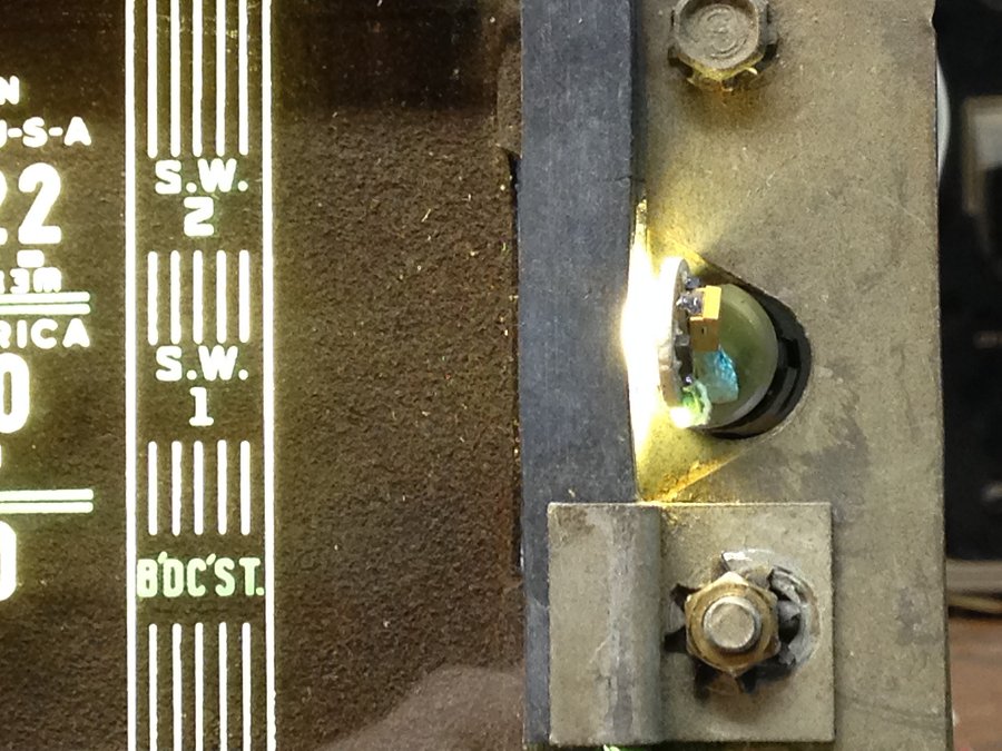

[Image: http://www.philcoradio.com/images/phorum...e00008.jpg]
These are the warm white LED lamps with miniature bayonet bases and flexible leads that I have mentioned before.
http://www.pinballlife.com/index.php?p=product&id=3108
These really dress up a Philco slide rule dial...in my opinion.

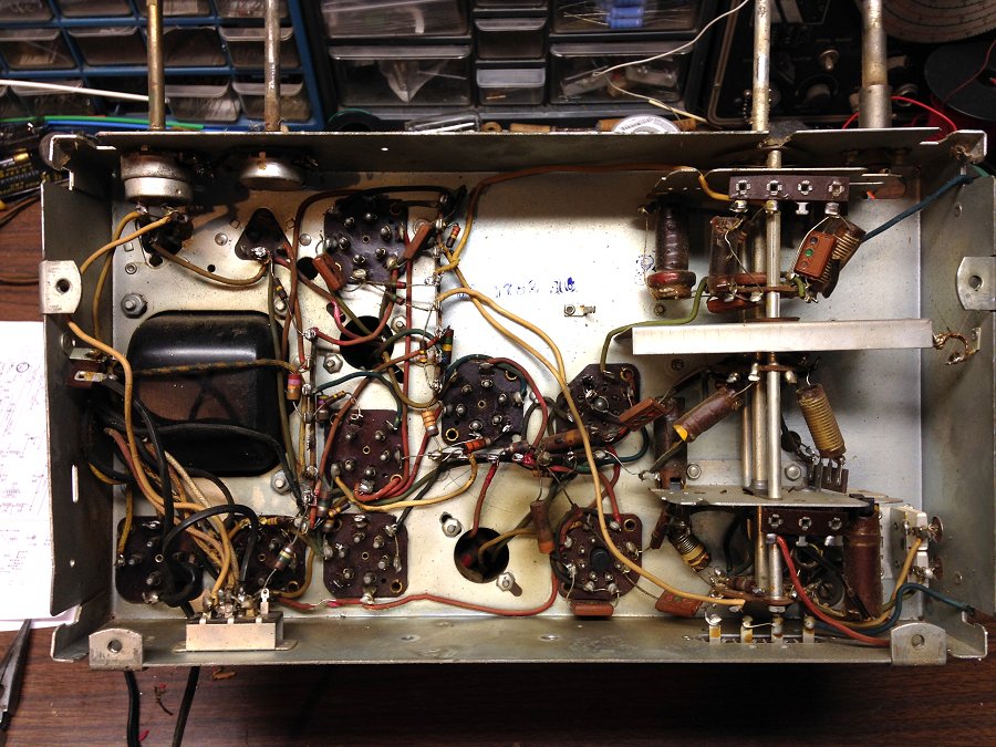

Here is the under-chassis view, with all new (restuffed) paper caps, restuffed electrolytics, and mostly new resistors:
[Image: http://www.philcoradio.com/images/phorum...e00009.jpg]
Oh, yes, and 95% new wiring.

With regard to the dial lamps, those LEDs seem to work fairly well for edge lighting the dial, though a typical G.E 47 or 44 style lamp with the filament in the proper orientation will also work well if carefully selected, believe it or not the focus of the light beam matters with incandescent bulbs too.

(12-20-2014, 11:40 PM)Ron Ramirez Wrote: ...These are the warm white LED lamps with miniature bayonet bases and flexible leads that I have mentioned before.
Thanks for that link Ron. I have ordered LED bulbs from PinballLife before but they didn't have the version with the flexible leads back then, those look pretty versatile. The extra illumination those provide for an edge lit dial makes a lot of difference. I just placed a few on order as well as some of the following:
http://www.pinballlife.com/index.php?p=product&id=3105
http://www.pinballlife.com/index.php?p=product&id=3211
All in warm white....if they provide some brighter illumination along with less chance of heat burning a dial face then it is a win-win.

I have not yet tried the LED lamps with clear dome lenses, but I do have some of the LEDs with frosted dome lenses, and they are very good - a bit brighter than an incandescent #44.  Do keep in mind that the lenses are larger than the glass bulb of a #44, in case clearance is an issue.
This morning, I aligned the 41-758.
[Image: http://www.philcoradio.com/images/phorum...e00010.jpg]

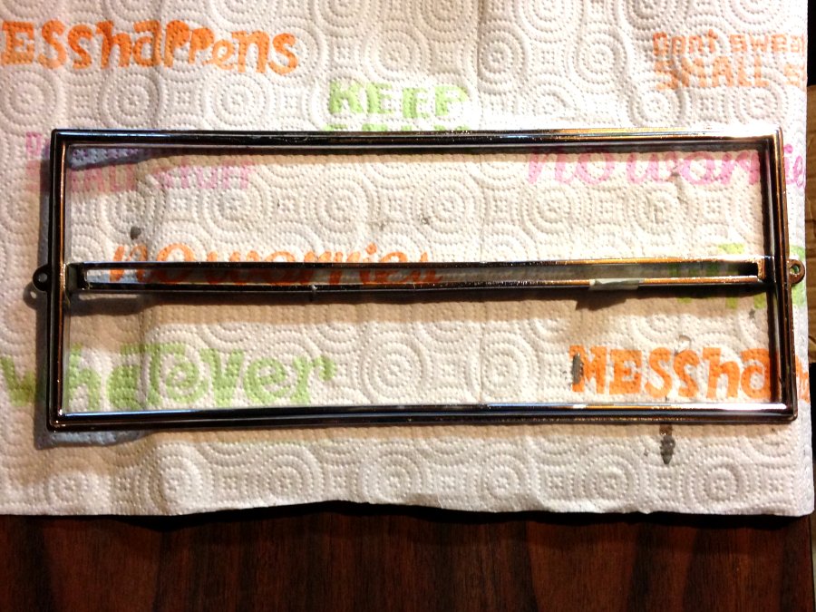

The bad news is the chrome grille. I managed to break one of the grillebars. Fortunately, J-B Weld seems to be working to correct the issue. I reglued two of the pieces last night, and they held together. A little while ago, I finished gluing the thing together. We shall see tomorrow if it works out.

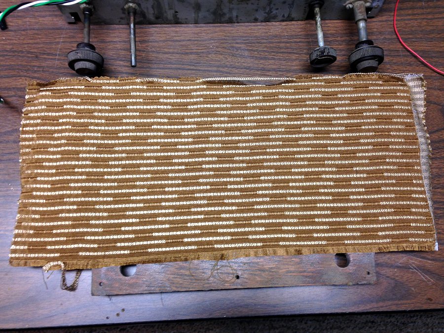

Yeah, I know this isn't the Cabinet forum, but I also installed new grille cloth this morning.
[Image: http://www.philcoradio.com/images/phorum...e00013.jpg]
This is one of the patterns that John at Radio Grille Cloth Headquarters used to sell. While it probably isn't exactly like the original cloth, it is better than no cloth at all (which is what it had when I bought it). Actually, comparing this to a poor quality original Philco illustration of a 41-758 (see below), I think this cloth is a pretty good substitute.
[Image: http://philcoradio.com/gallery2/images/1...age_00.jpg]
