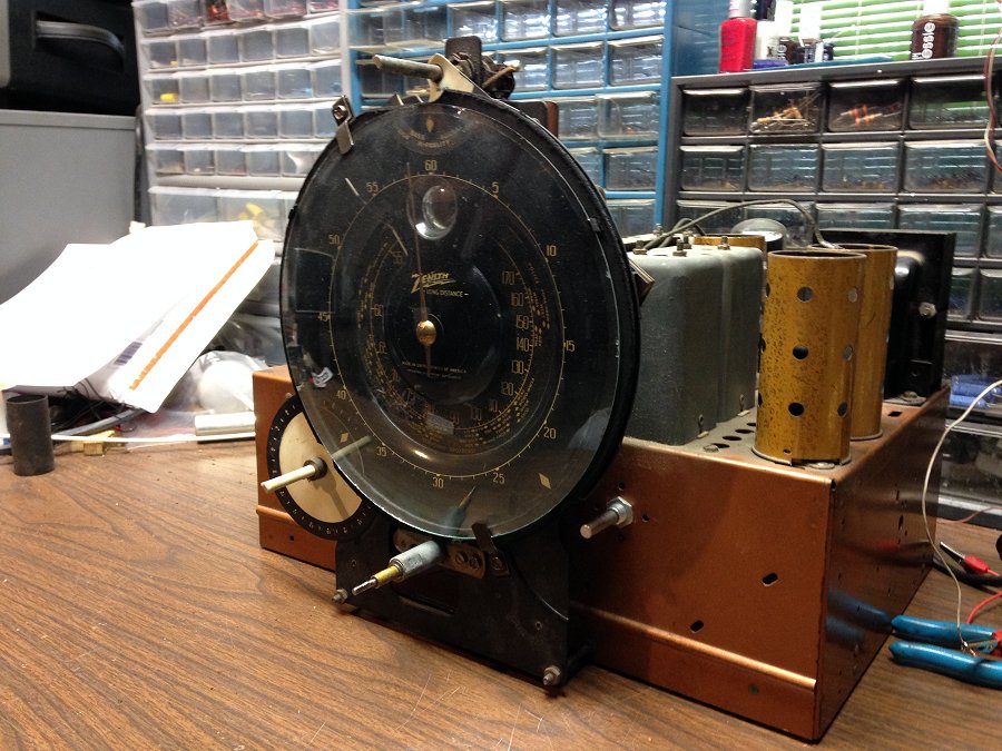

In July of 2013, I acquired this radio at the MARC Extravaganza. I wrote about it at the time in this thread.
[Image: http://www.philcoradio.com/images/phorum...62_001.jpg]
I'm starting a new thread because the original lasted five pages without my actually doing any work to the radio. In this thread, I am going to attempt to get it going again.

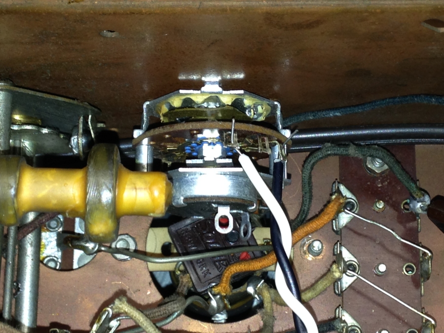

[Image: http://www.philcoradio.com/images/phorum...62_002.jpg]
This will be my Christmas/New Year's 2014/2015 project. I am restoring this set in memory of Little Joe, my grandson who passed away a week ago today. When I complete the radio, it will be given to Joseph's parents.

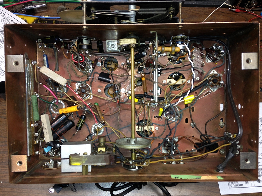

I just noticed that I forgot to post a "before" photo of how the underside of the chassis looks at present...
[Image: http://www.philcoradio.com/images/phorum...62_003.jpg]
Like I said, a hack job...

Yea, the person who worked on that 9 tuber did some shoddy work. The candohm is almost always bad. Be real careful with the coil just below the SW padder and ON/Local/Distance switch as the fine wires are easy to break off. I've had to locate and resolder several of those hair thin wires and solder doesn't stick well to them.

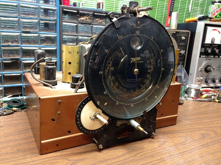

Well, this afternoon I finally stopped procrastinating, and dived into the 9-S-262.
Here are the results so far.
[Image: http://www.philcoradio.com/images/phorum...62_004.jpg]
As there was only one original Brand Z paper cap under the chassis, I am making no attempt to restuff caps in this set.
So far, four capacitors and two resistors have been replaced, and I've prepared the new off-on-sensitivity switch for hookup.
[Image: http://www.philcoradio.com/images/phorum...62_005.jpg]

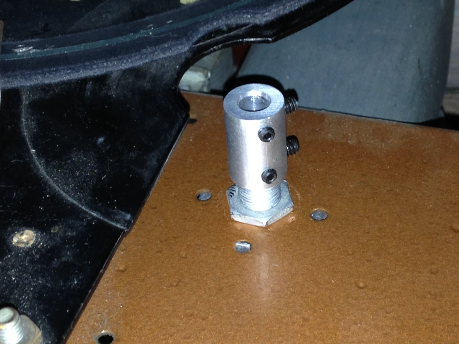

I shortened the shaft of the new switch somewhat, so that there is room for the shaft coupling and the switch indicator that will attach to the length of shaft which I will have to cut and install on the shaft coupling.
[Image: http://www.philcoradio.com/images/phorum...62_006.jpg]
Posts: 2,575
Threads: 337
Joined: Jun 2013
City: lawrenceville nj
ron
what is the name of that adapter piece in last pic with allen screws in it
and where can I get them
they look like the may work on the bol turn table drive motors
sam
