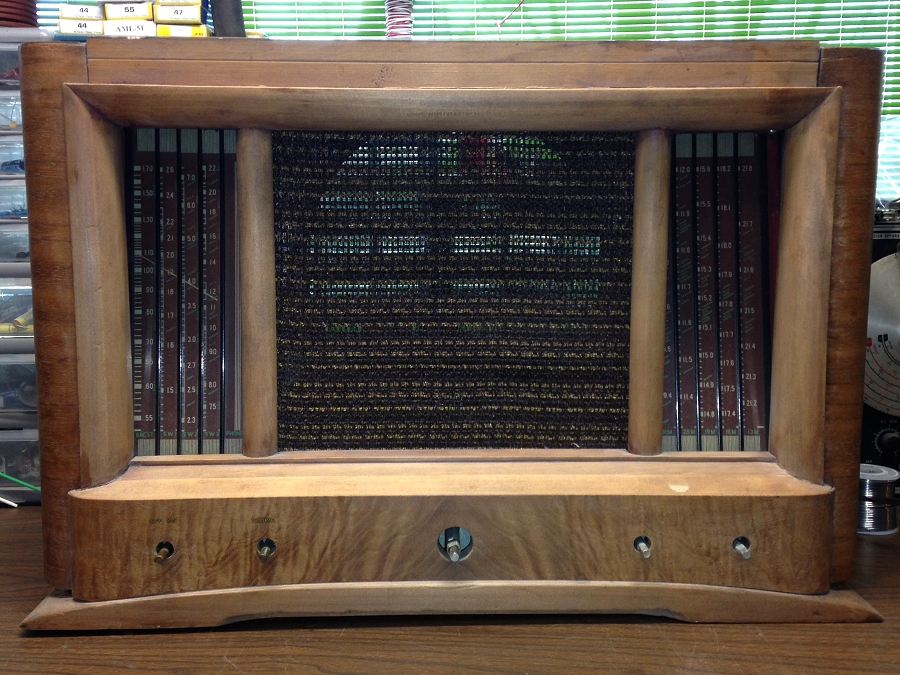

The cabinet is in pretty bad shape, but that's a topic for another time and another section of the Phorum.

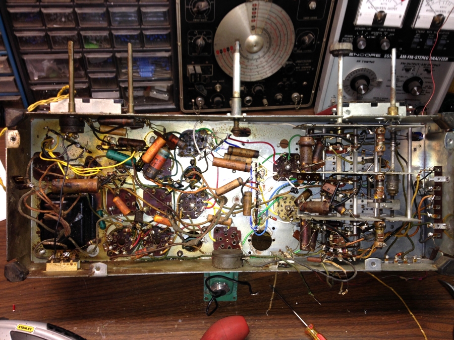

Things looks sort of rough under the chassis, but not as bad as I expected. The power transformer has also been replaced.

This model has two dial scales and uses two tuning controls. One of the two is used exclusively for the "spread bands" on the right, and uses the same sort of (missing) coupling that I ran into in the 42-761EZ that I worked on in early 2013. Now I'll have to find that extra piece of rubber I bought when I made a spacer for its tuning control...

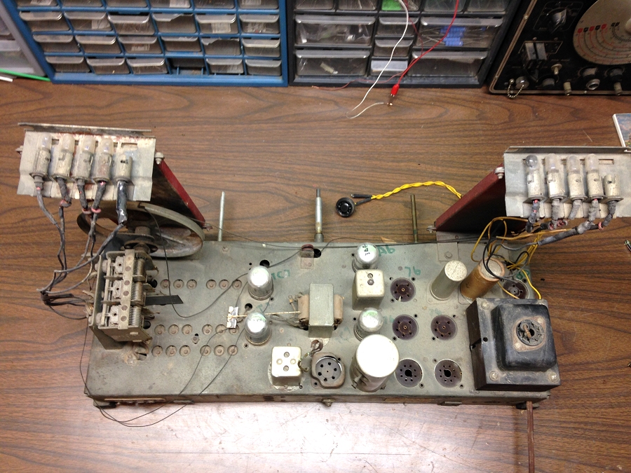

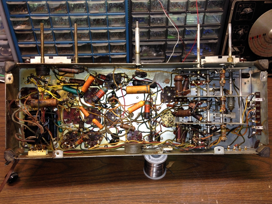

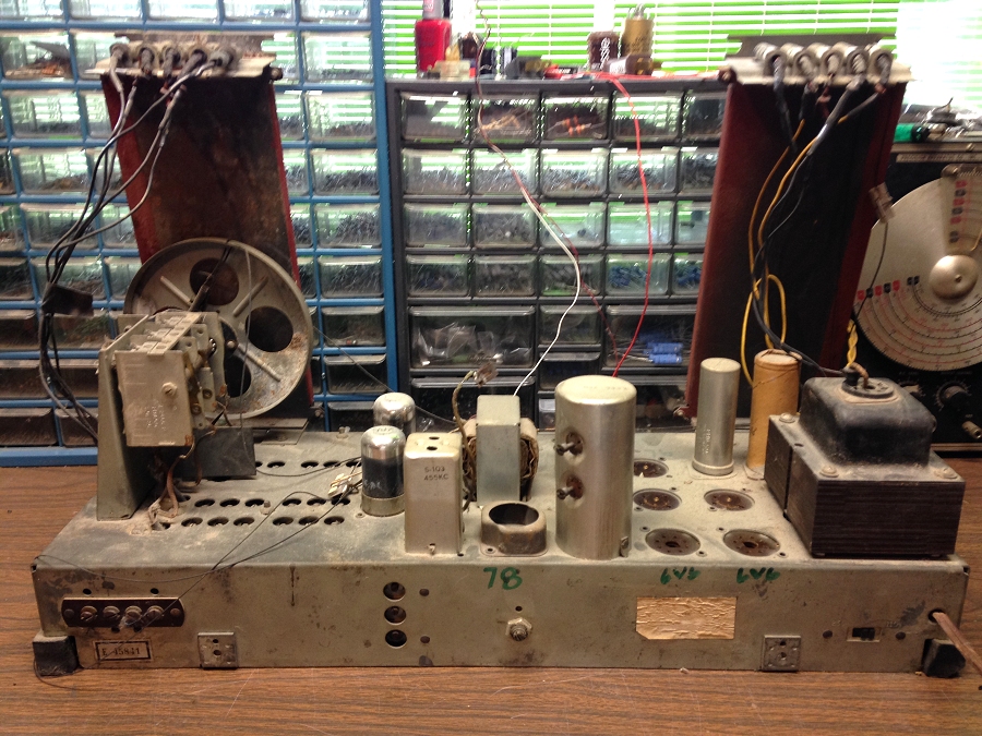

Well, I started working on this chassis today.
This is not going to be an easy task. Wires semi-buried underneath the tuning mechanism, plus the wiring harnesses which control the various dial lamps attached to the rearmost section of the band switch, the lower terminals of which are not accessible...yep, this one is going to be fun. Oy vey.

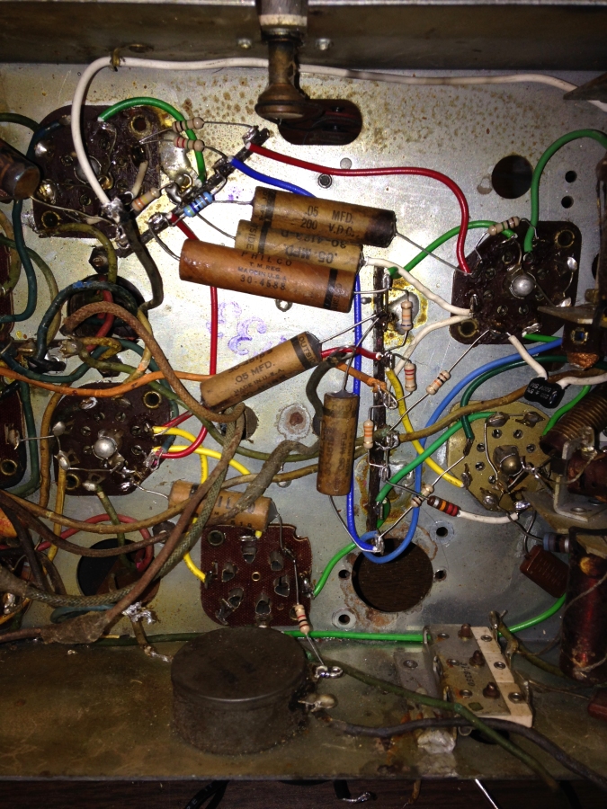

[Image: http://www.philcoradio.com/images/phorum...88_008.jpg]
Usually when I start working on a Philco that requires replacement of rubber-covered wiring, I just pick a spot and jump in.
As you can see above, my work has been concentrated on the center of the chassis. Six paper caps, two micas, and a dozen resistors have been replaced so far.
A closer look:
[Image: http://www.philcoradio.com/images/phorum...88_009.jpg]
Yes, those old paper caps in the center of the chassis are restuffed.
As John (Eliot) said earlier, this has been no "walk in the park," and I knew it wouldn't be. So far, I have had to carefully resleeve two wires that run under the permeability tuning unit to the band switch - with more of those to come. This is what is really slowing things down. Once I get past that and start working towards the left, things should pick up as far as speed of work goes.

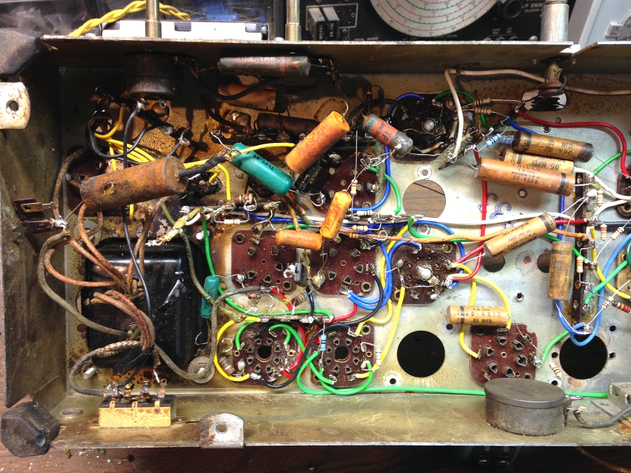

[Image: http://www.philcoradio.com/images/phorum...88_010.jpg]
As you can see, I am having to remove some components in order that I may replace all of that rotten rubber wire.
The rubber insulation on these wires is literally crumbling as it is touched. It has to be replaced.

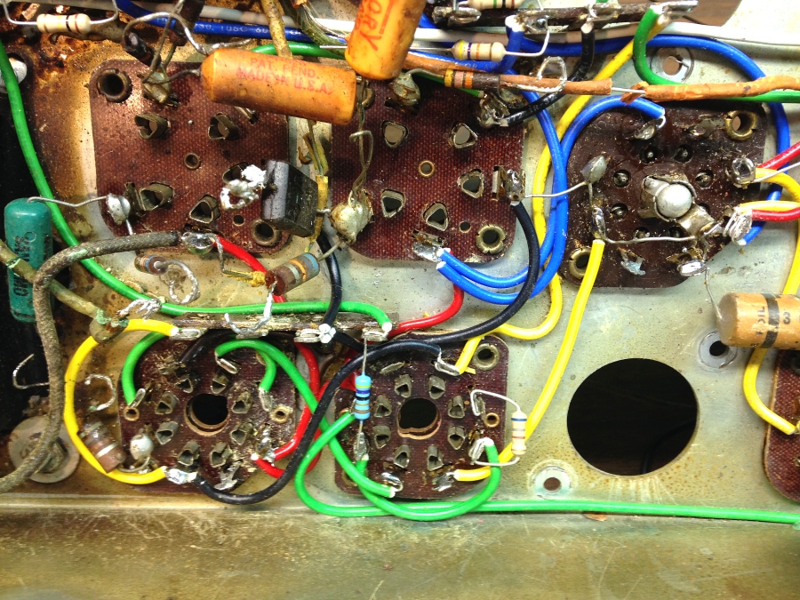

A closer look:
[Image: http://www.philcoradio.com/images/phorum...88_011.jpg]
I'm currently in the audio output section. I'm just about ready to start replacing resistors here (actually, two have already been replaced, as you can see), and then I will install new capacitors.
You can see in these photos that many of the original Philco paper caps were replaced with caps with plastic shells at some time, and the work was done sloppily. I will replace these caps with restuffed paper caps - Philco, Sprague, and Cornell Dubilier (depending on what I have and the printed values on the shells).
