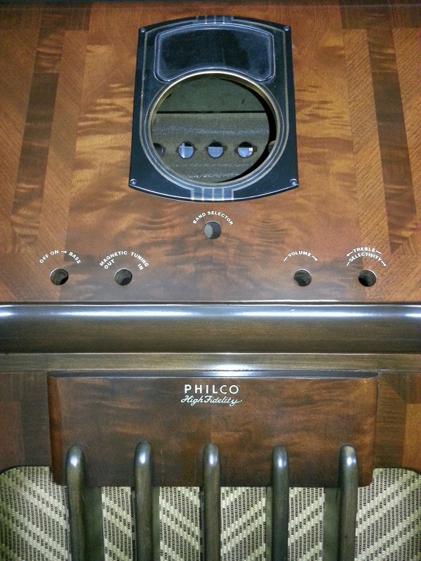

Thanks John , do you know about the pilot lamps (flood lamps )that are on that set, it seems they should go on when magnetic in /out switch is turned <> , im not talking about the dial lamp, those pilot lamps are way down there and dont seem like they would do any good to lite up dial any, what are they there for

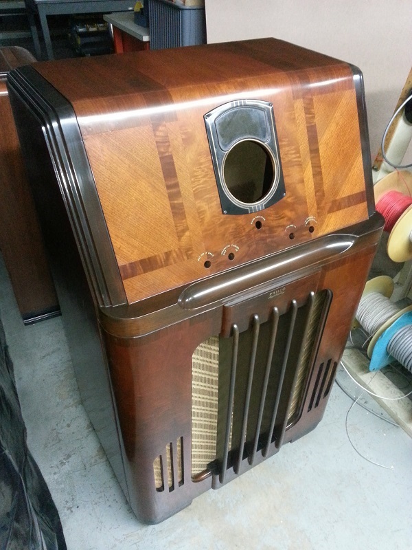

That's beyond snazzy, great job!

PLEASE post a step-by-step procedure on how you obtain such a beautiful finish. There are a lot of people here on the forum that would love to be able to achieve similar results with their radios. A YouTube video would be even better  .

Looks great Fred!
Yes, the side dial lamps come on when the magnetic tuning switch is turned "on". It lights up the station tabs, although not real well

Yes, the side dial lamps come on when the magnetic tuning switch is turned "on". It lights up the station tabs, although not real well  THANKS FOR THAT TID BIT OF INFO.

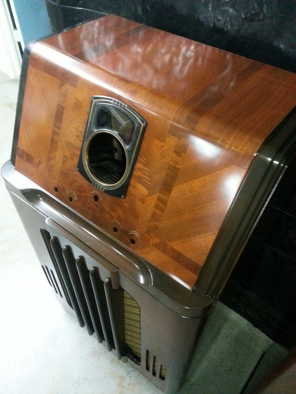

I'd like to know how, after you sprayed your final lacquer coats, you got the front and top on this so silky smooth looking:
[Image: http://philcoradio.com/phorum/attachment.php?aid=6278]
Did you do the final rub out by hand or with a polisher? Or did you even do a final rub out?
Also, what gloss lacquer did you use... satin, semi-gloss, or gloss? Or were the first few coats gloss followed by a couple of semi-gloss?
Thanks,
Geoff

(01-08-2015, 01:39 AM)Geoff Wrote: I'd like to know how, after you sprayed your final lacquer coats, you got the front and top on this so silky smooth looking:
I did not rub it out , if you can spray without getting any trash in the clear you did good. The gloss level is semi gloss . The smoothness comes from , 1. how you mixed your clear and that depends the temp when clearing, the more thinner added will make waterier ,you have better flow out, all the thinner is for is to make the clear thin enough to be sprayable, you have to use slow dry thinner in summer and fast dry in winter, you don't want the clear to dry to fast , you need a good spray gun with a # 4 tip. I have 3 coats sanding sealer under the 4-5 coats of semi clear. I only buff when I use high gloss piano finish , high gloss has a gloss level of 90% you have to buff to get that 100% gloss level, wet sanding and buffing gets rid of any orange peel. There is a lot to it , I been painting high end cars for long time, I still don't everything, Lots of practice I quess

Good info Fred. What brand of grain filler do you use?

Thanks for the feedback Fred.
If you don't do any rubbing out of the finish, how do you deal with overspray? Or has that got more to do with the lacquer/thinner ratio?

(01-08-2015, 03:26 PM)Geoff Wrote: Thanks for the feedback Fred.
If you spray with slow dry thinner in your clear any over spray will melt back into the clear. you cant do this using spray can clear on large surface, if you get over spray (dryness) make sure your gun is adjusted properly on your pattern . pattern should be around 6 inches or larger . pattern is the fan shape that comes out of nozzle and keep ( air pressure) around 25-32 pounds. Never spray with pressure to high. Over spray is caused your paint is starting to dry before hits the surface so slow it down with slow dry thinner or retarder. To deal with overspray you really have to sand it smooth and re clear. You can try spraying straight retarder over the area and that should remelt the over spray abit. Retarder is a additive for your clearcoat that will slow the drying time and gets rid of over spray , dryness , solvent pop, cloudiness, when temps are hot and humid. Dont use it when its temp are cool and damp, use fast thinner when cool outside.
