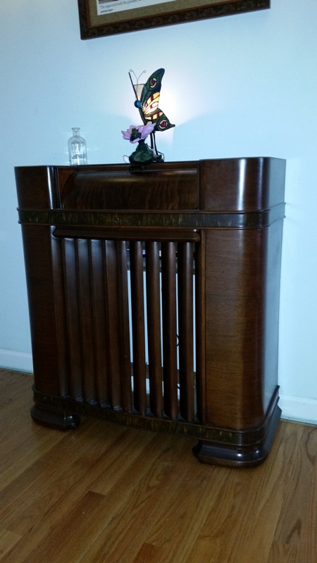

 I don't usually restore radios. I tend towards vintage record players, stereos, mostly tube type but an aquaintance of mine decided to give up his radio hobby due to advance years and sold me a lot of his testers and parts.  He was insistant on my taking a 1935 Airline floor model radio and this Philco.  I eventually restored the Airline to much satisfaction and thought I'd start into the Philco.  The cabinet is refinished (it really needed it) and of course it's time for the chassis.   I like the style and it looks great on my second floor landing.  I have the schematics but I'd thought I'd mine this site for  information & do's and dont's.  Thank you.

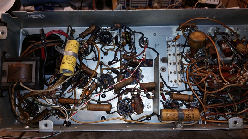

I wanted to give an update on what is happening with my 42-400 radio.  I replaced all E-caps and paper caps as well as one burnt resistor,  Some rubber wires were bad and they too were replaced.  I fired it up on the variac and got some noise only, so I tested all the tubes and they tested good, except for the XXFM which tested only fair. I cleaned  some corrosion off the pins and brought her up on the variac again.  I got a Lehigh Vally station on the AM across the dial and no other station. Also, it was rather weak.  This is a fringe station and the local stations did not come through.  As for the Short Wave, I fared a little better with several stations coming through and better volume. So my questions are, "Now what"? and  is there a manual for this radio.  I have the service manuals but I think I need a copy of the owners manual too, if one exists .  The push buttons are not marked and I can't make out what they're supposed to do. The dial glass is broken in two...   great sadness   Icon_sad  and I will have to have the speaker re-coned.  That's my update.  Thanks!!

Micro, I merged you new post with your original thread to keep things together. The push button info is in the service info. You can get all the service info for your set from Chuck Schwark but I doubt he has the owners manual...ask him. You may need to align the set.
Thanks for the response and the merge. I'll look again at the service sheets. I saw a brief on the push buttons but nothing specific. I assume some are presets but am unsure which ones select AM, SW, or FM. I was thinking too that the set may need to be aligned. I've not yet aligned a radio and am wondering whether or not it's a good idea to cut my teeth on this one.

The service info I lonked to says on-off button is on the left, next 5 are presets for broadcast band, next 4 are for SW N FM.

Thanks Klondike. I am studying the schematics, including the Riders. I watched a couple videos on alignment and will look for more. For now I want to go over it more closely now that I know it has promise.

Keep in mind that the pre-war FM band on that model is not the same band as todays FM. You won't hear much on it.
There are a number of circuits on the internet for building converters so that one can use these old FM band sets and pick up the modern FM band. Just do a search of "pre war FM band" and you will find links to them.
