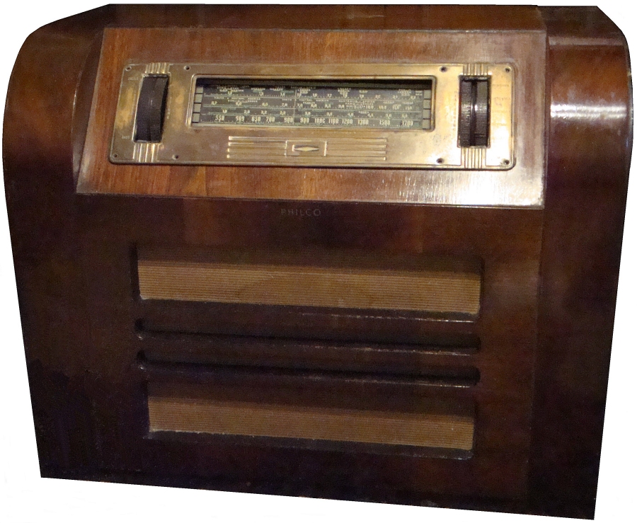

This is the oldest, largest, and heaviest Tropic in my collection. The cabinet alone is surprisingly heavy.
[Image: http://www.philcoradio.com/images/phorum...770-02.jpg]

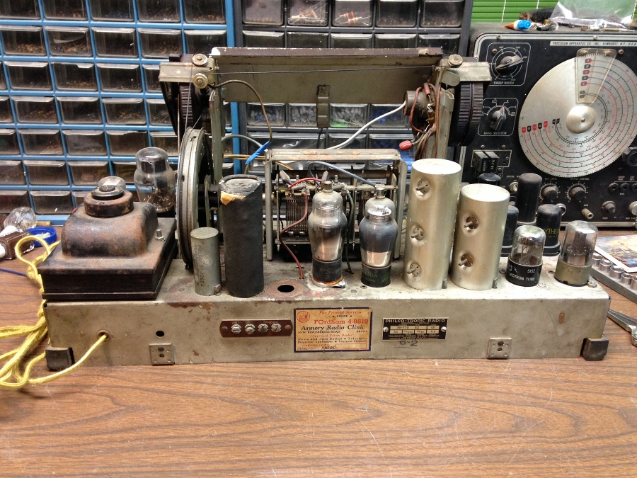

As you can see, the chassis looks like a typical thumbwheel drive Philco from 1939-1941...only it has no pushbuttons.

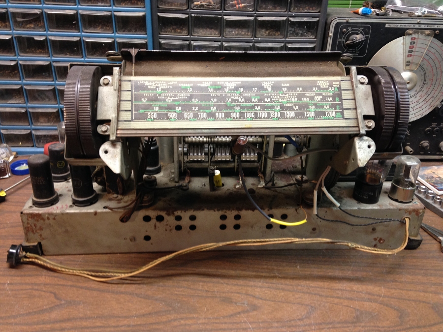

[Image: http://www.philcoradio.com/images/phorum...770-03.jpg]

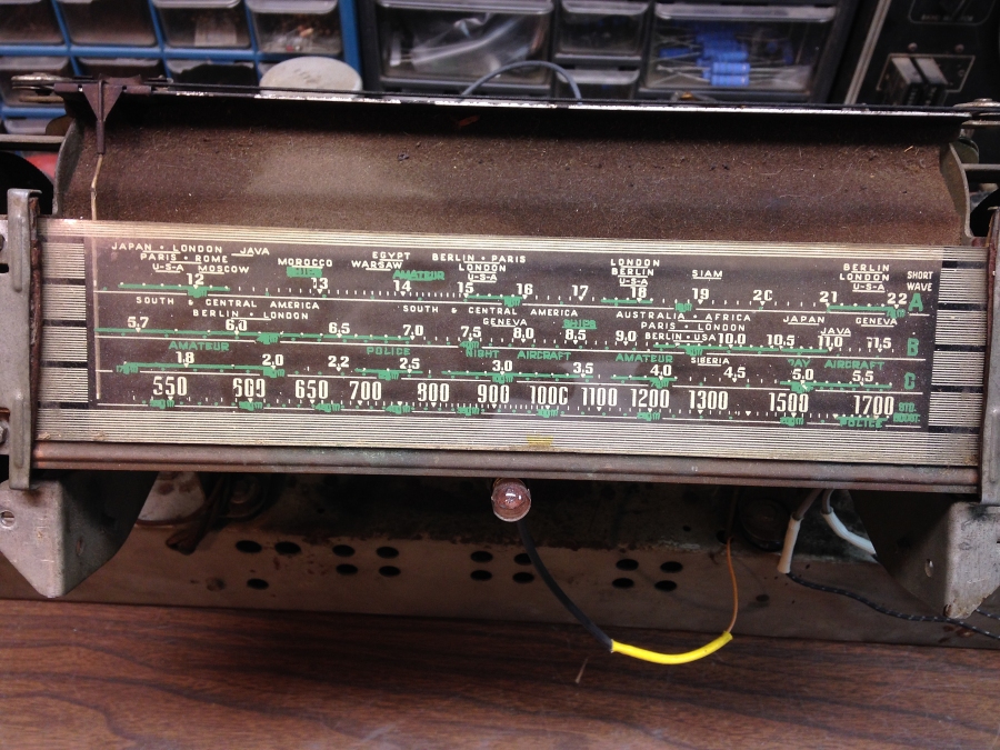

A close-up of the dial scale. Notice that it has four bands with complete "all wave" coverage from 540 kc to 22 mc. A unique feature of this radio is a tuning light, mounted just below the dial scale.
[Image: http://www.philcoradio.com/images/phorum...770-04.jpg]
This is a back view of the chassis.
[Image: http://www.philcoradio.com/images/phorum...770-05.jpg]

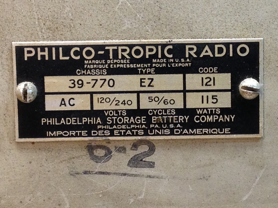

The metal model number tag...
[Image: http://www.philcoradio.com/images/phorum...770-06.jpg]

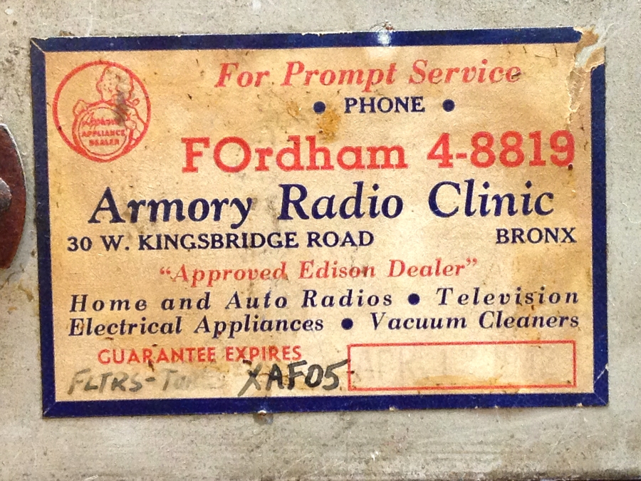

...and a sticker indicating it was serviced in the Bronx, NY. The guarantee expiration date is hard to read, but if you look close, you can just make out the date: Apr. 12, 1942.
So either this set was sold in the USA, the "made expressly for export" on the model number tag notwithstanding, or else whoever originally purchased the set immigrated here not long afterward, and settled in the Bronx (and brought their very cool - and very rare - Philco Tropic with them).

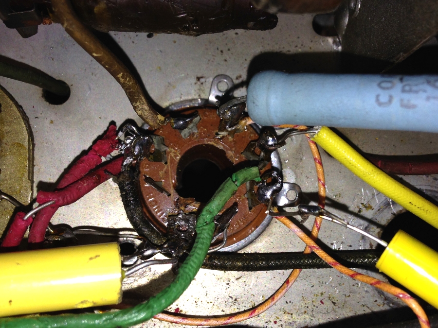

[Image: http://www.philcoradio.com/images/phorum...770-07.jpg]
Right away you can spot a problem if you look closely - a tube socket has been mounted from the top of the chassis!  I will correct that issue during the course of the restoration.

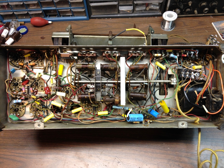

Now let's look under the chassis.
[Image: http://www.philcoradio.com/images/phorum...770-08.jpg]
Since none of the original paper caps are left underneath, I'm not sure whether or not I am going to install restuffed caps under here.

I looked up the location of the Armory Radio Clinic, just for fun...
Looks like the most recent business at that address was a furniture store. It's across the street from the NY National Guard Kingsbridge Armory, which is likely why the radio shop was called "Armory Radio Clinic." Maybe the radio was purchased by a soldier and brought back to the USA?
If these radios could talk...

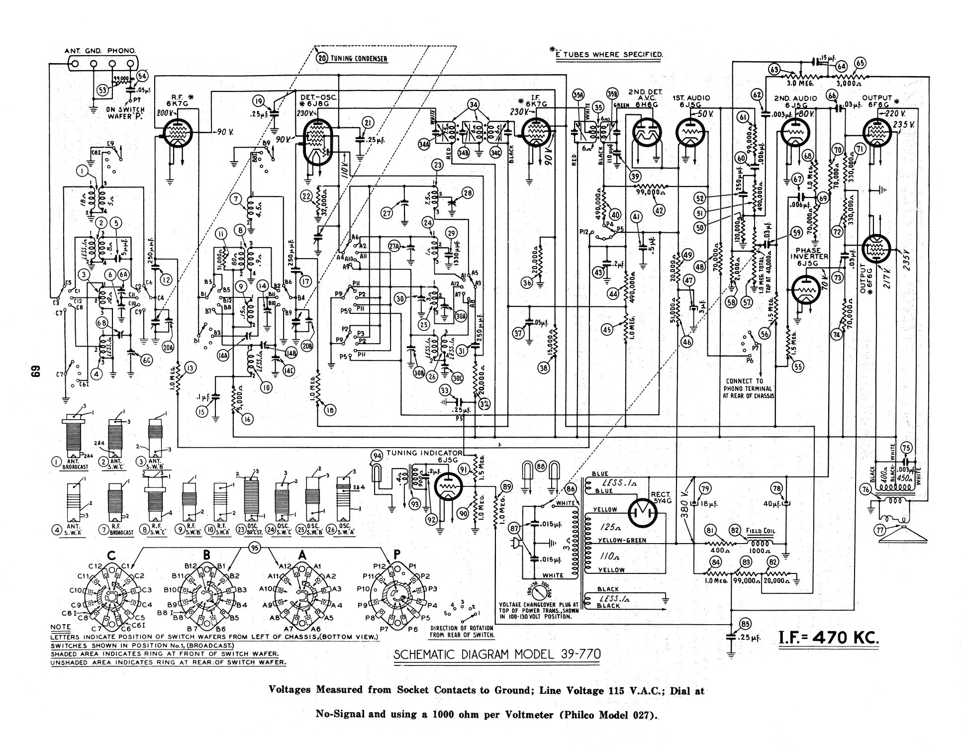

Here's the schematic for anyone wishing to follow along.
39-770 Schematic (655 KB)

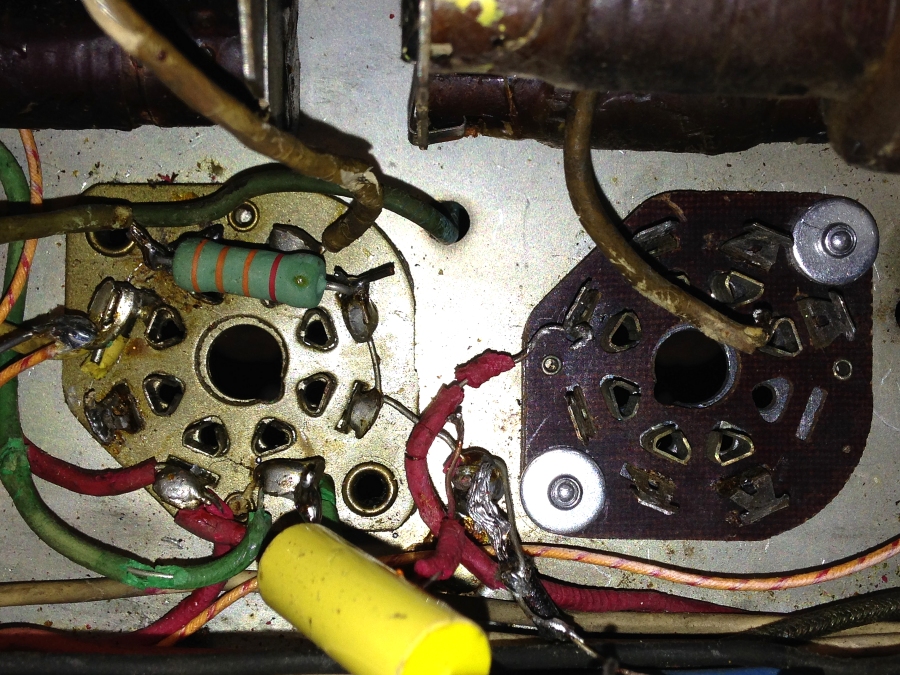

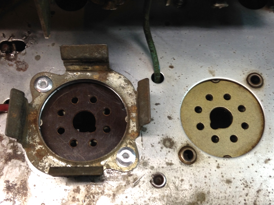

[Image: http://www.philcoradio.com/images/phorum...770-09.jpg]
Here you see the 6K7G RF tube socket which is about to be replaced with a genuine Philco tube socket - brown phenolic, not the goldish-yellow crappy socket which, unfortunately, this set is full of.

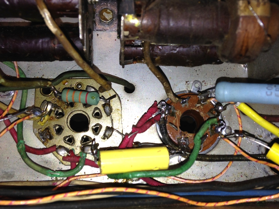

[Image: http://www.philcoradio.com/images/phorum...770-10.jpg]
Zoomed out a bit, to show the 6J8G socket to the left of the 6K7G socket. As you can see, the 6J8G is the crappy yellow type.
[Image: http://www.philcoradio.com/images/phorum...770-11.jpg]
After unsoldering some wires, the ill-fitting socket was removed...

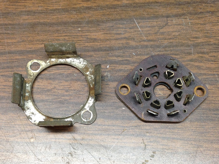

Here is the replacement socket - a used Philco socket pulled from a dead chassis. To the left is a 1937 Philco tube shield base. Philco should have kept using these after 1937. But instead, beginning in the 1938 season, Philco went back to the 1936 style tube shield base - to prevent anything but the use of ST style tubes. Only the ST tubes (the "G" types) will fit through the hole in the bases used from 1938-1942. With the 1937 style tube shield bases, one may use any tube he or she wishes - ST (G), GT, and (shudder!) metal.
I am using a 1937 style shield base for two reasons: one, for the versatility as mentioned above; and two, these are the only shield bases I have on hand.

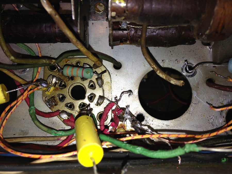

[Image: http://www.philcoradio.com/images/phorum...770-14.jpg]
...and how it looks from under the chassis.
