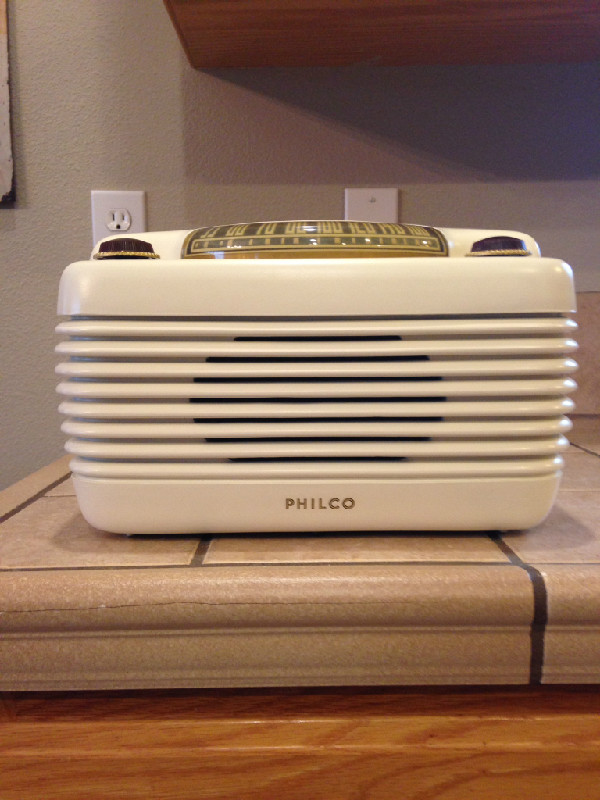

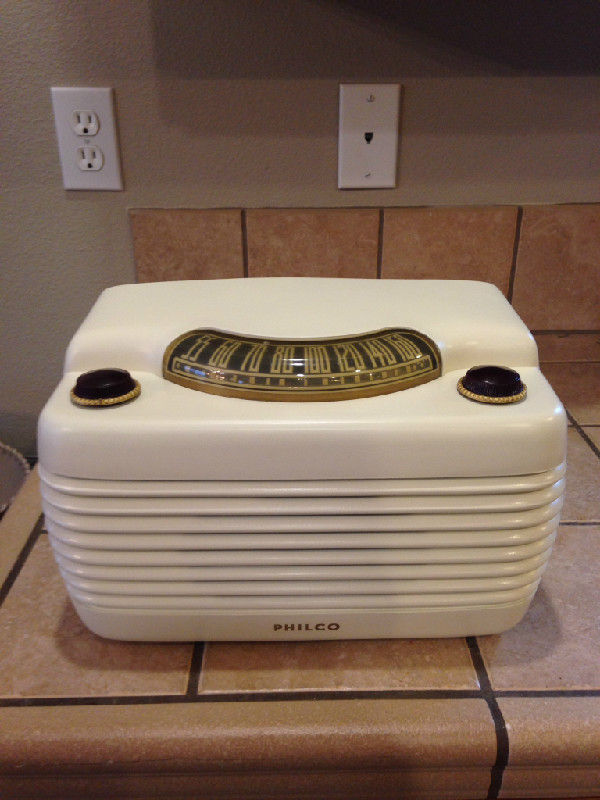

Paint it!  Ivory Hippos look great!  Here's one I finished a couple months ago.  I used Rustoleum Painter's Touch 2X "Heirloom White" and couldn't have been happier with the results!
Looks very nice!
I agree, I have bought many radios, cheap that nobody else wanted because of a cracked cabinet. Even rust oleum dark walnut brown looks good if you want the original look.

(02-24-2015, 11:03 AM)SI\m klondike98 Wrote:  Looks very nice!
Thanks!   It was an original Ivory set, but over the years it had been painted blue and then black.  After  stripping, it was obvious that the bare bakelite wasn't good enough so I put it back to original.
