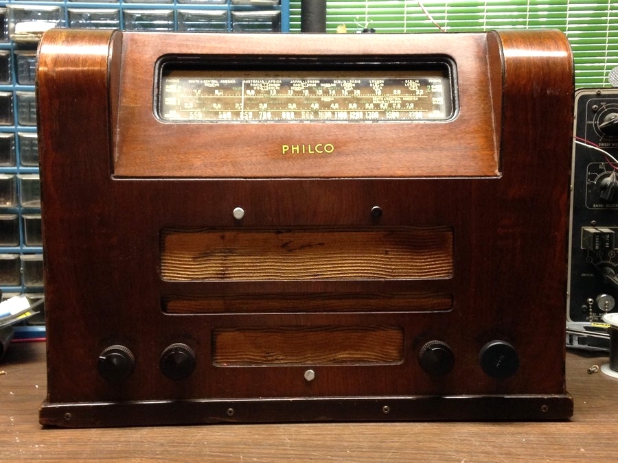

This is my first 1940 model Tropic set. It is a large table model yet only has five tubes.
[Image: http://www.philcoradio.com/images/phorum...5T_001.jpg]

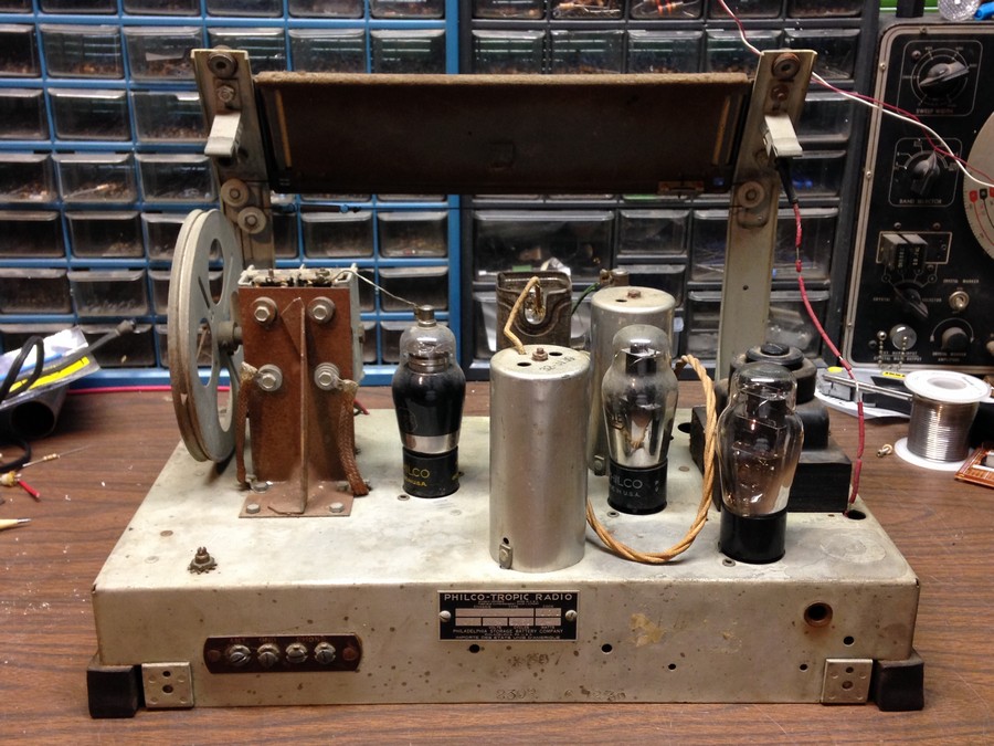

and the back...
[Image: http://www.philcoradio.com/images/phorum...5T_003.jpg]

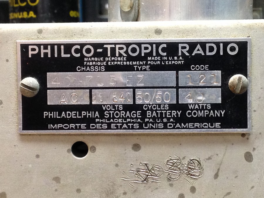

A close-up of the model number tag:
[Image: http://www.philcoradio.com/images/phorum...5T_004.jpg]

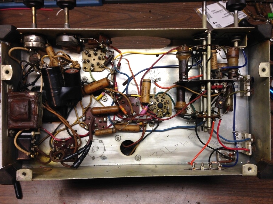

and a look underneath.
[Image: http://www.philcoradio.com/images/phorum...5T_005.jpg]

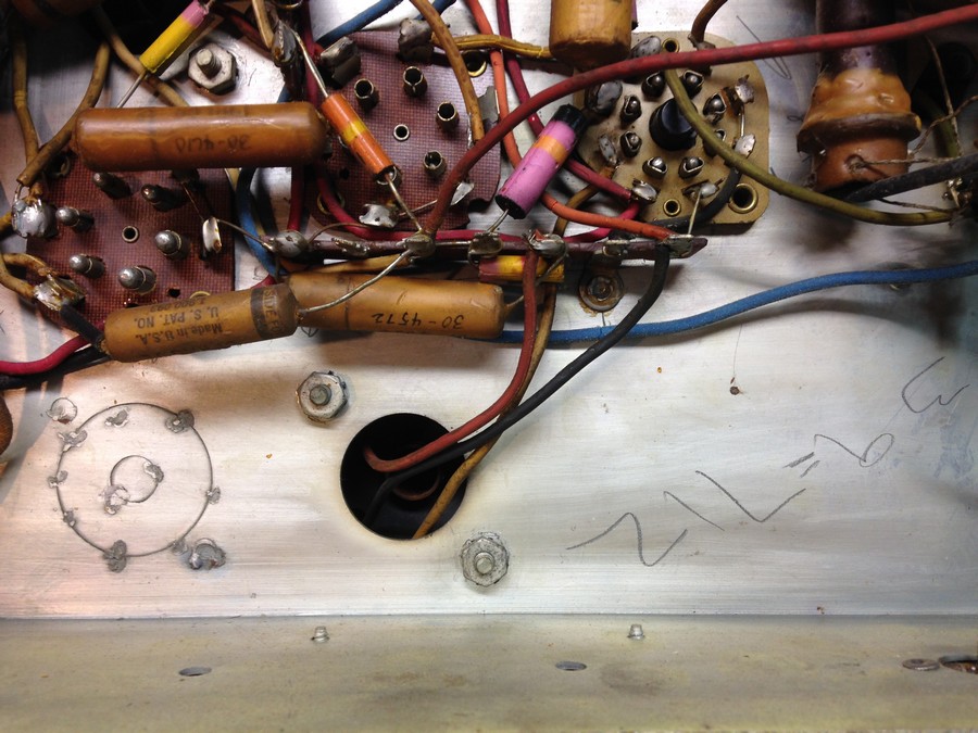

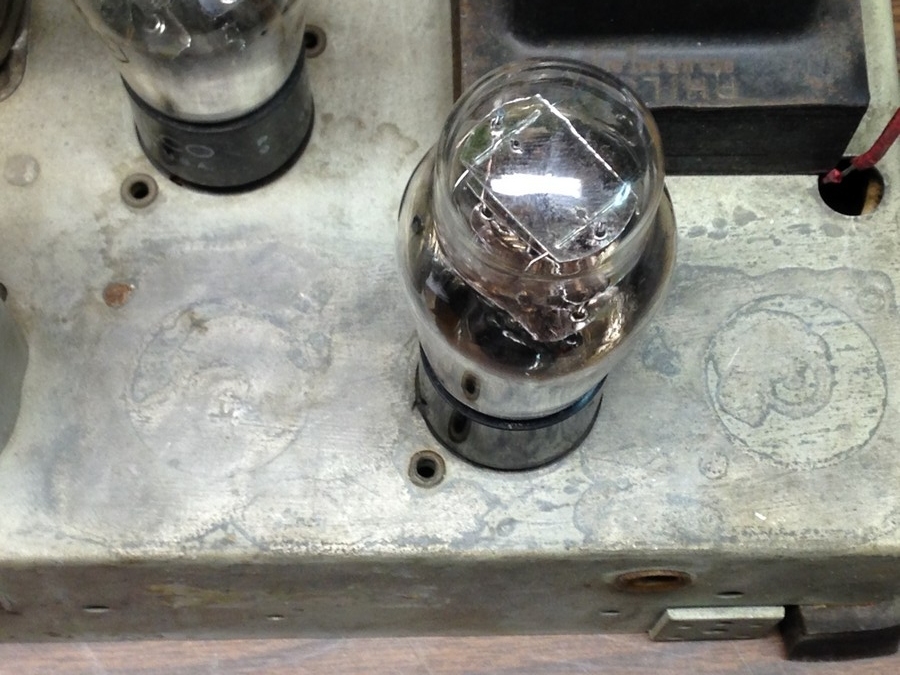

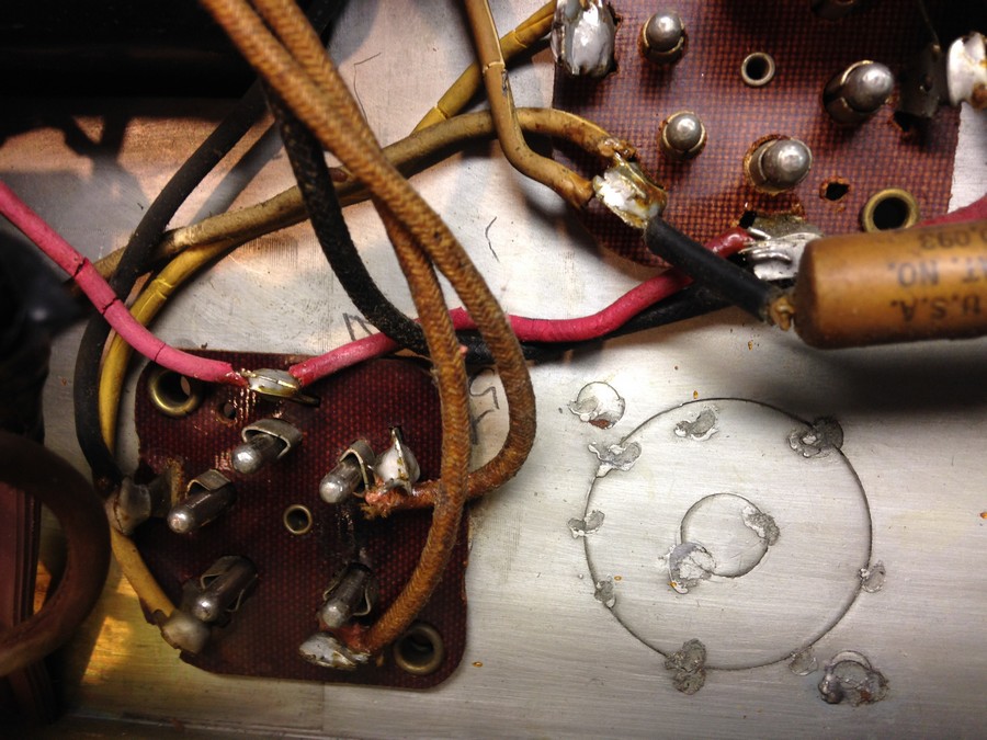

Notice also a drawing for what may have been intended for another tube socket...
[Image: http://www.philcoradio.com/images/phorum...5T_007.jpg]
and faint outlines of drawings for two extra tube sockets on top of the chassis...
[Image: http://www.philcoradio.com/images/phorum...5T_013.jpg]
This should be an interesting rebuild.

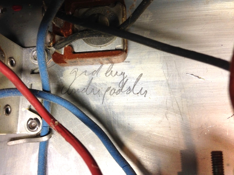

[Image: http://www.philcoradio.com/images/phorum...5T_008.jpg]
It reads "gnd lug under padder".

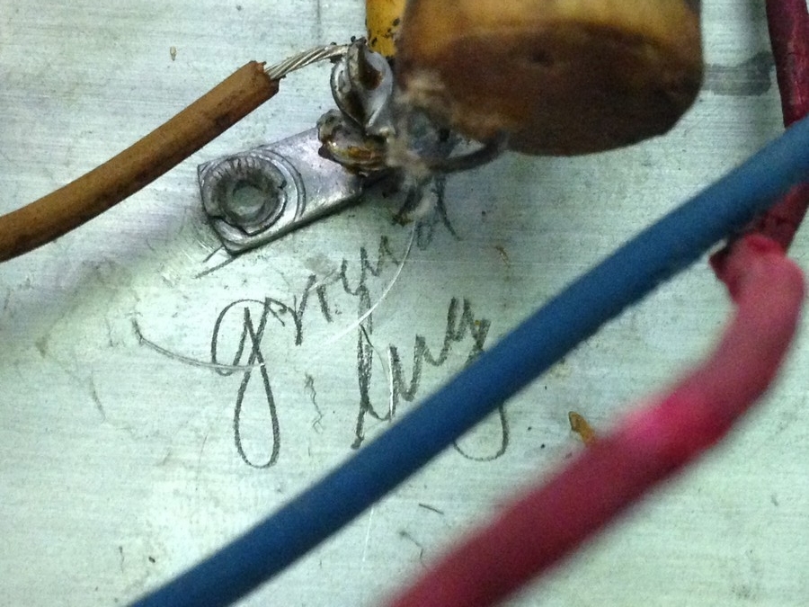

[Image: http://www.philcoradio.com/images/phorum...5T_009.jpg]
And a note next to a ground lug - "ground lug".

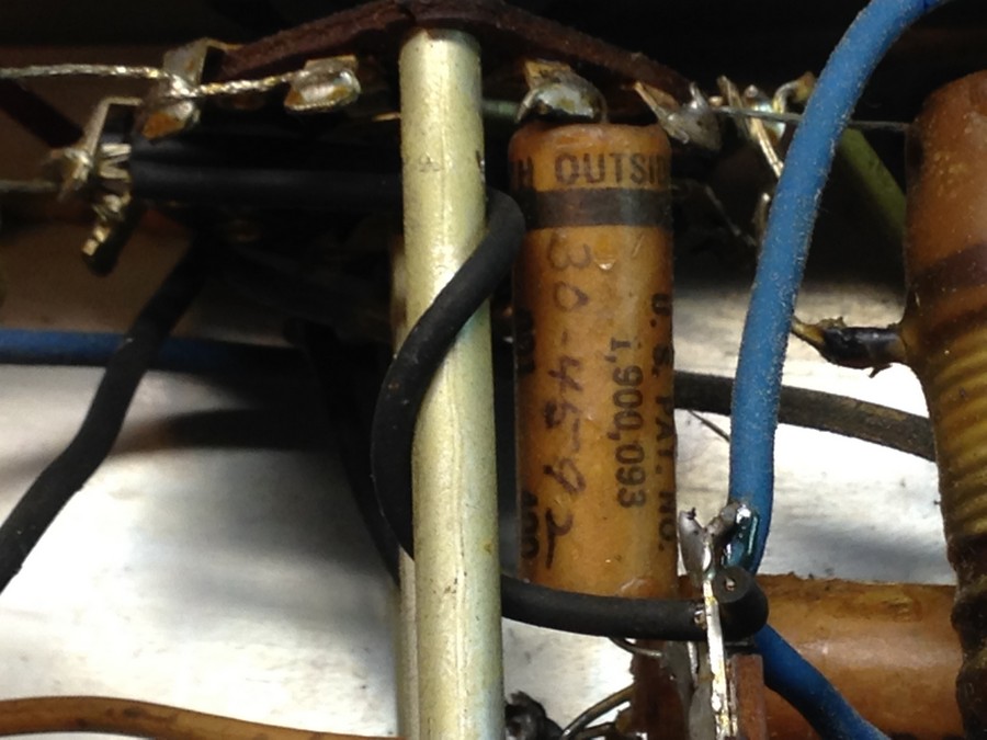

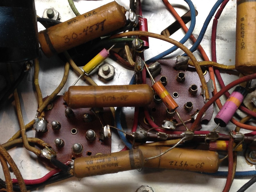

Now let's take a closer look at some of the original paper capacitors.
[Image: http://www.philcoradio.com/images/phorum...5T_010.jpg]
[Image: http://www.philcoradio.com/images/phorum...5T_011.jpg]
[Image: http://www.philcoradio.com/images/phorum...5T_012.jpg]
Notice how many of the Philco part numbers on paper caps are written on them rather than having been printed on?

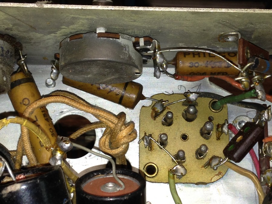

Regardless, the radio was obviously used, as the original electrolytics were removed several years ago and two tubular electrolytics (taped together under the chassis) were installed by some long-ago repairman. And the job was done sloppily. I will find two bolt-in electrolytic cans, restuff them, and hook them up correctly.
Three hours later.
[Image: http://www.philcoradio.com/images/phorum...5T_014.jpg]
You can see that a few wires have been replaced along with two resistors. What is not readily apparent are three of the paper caps, two in the bandswitch section and one just right of center, which have been restuffed and reinstalled.

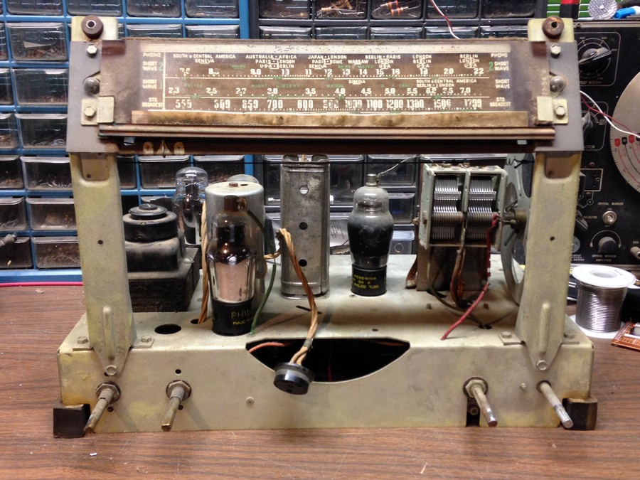

What is your plan with the faded dial glass printing?

(03-05-2015, 01:22 PM)PhilcoMike Wrote:  Ron,
In the last YouTube restore video by Buzz he sent a dial glass off to RadioDaze and they did a pretty nice job redoing the original glass:
https://www.youtube.com/watch?v=PeI1djmKctk
The dial glass is revealed at about the 12 minute mark.
(03-05-2015, 04:52 AM)sam Wrote:  why does power trans look like older type with tube on it
The power transformer does have a socket on top...but it has a special plug that plugs into that socket, not a tube.
This socket has two keyways, so the plug may be plugged in one of two ways.
One way connects the primary to run on 115 volts AC. Pull the special plug, turn it the other way, and reinsert, and then the radio is set to operate on 230 volts AC.

(03-05-2015, 01:22 PM)PhilcoMike Wrote:  What is your plan with the faded dial glass printing?
Well, right now I have no plan.
Eliot Ness Wrote:In the last YouTube restore video by Buzz he sent a dial glass off to RadioDaze and they did a pretty nice job redoing the original glass:
Acked, and so noted. I may follow that same plan, but I also have another Tropic needing a dial glass (42-720EZ). That glass is printed on the front and back. I seem to recall that someone in one of the Facebook antique radio groups has found someone that can make repro dials, and as I recall, they can do the front/back dials as well as the dials that are printed only on the back as with this 40-715. I will see if I can find out more about this.
I wonder if Radio Daze is willing to make one-off repro dials? I doubt that they would ever sell very many 40-715 or 42-720 dials. But if they have the artwork, they can always make another one...
Radio Daze made the dial for my 47-1230 of which they had none at the time. I had to send the original in for them to copy it though. Was a vey good job.

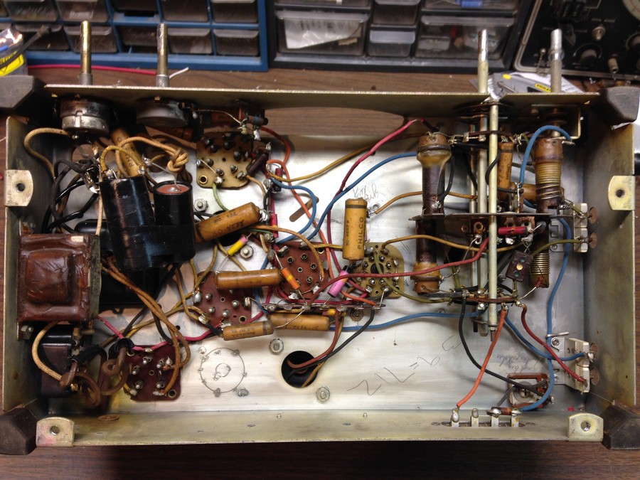

After a couple of days, here is how it looks now.
[Image: http://www.philcoradio.com/images/phorum...5T_015.jpg]
New wires and new resistors. The two dial lamp sockets have also been rebuilt.
Tomorrow, I will melt the old innards from the remaining paper caps, restuff and reinstall.

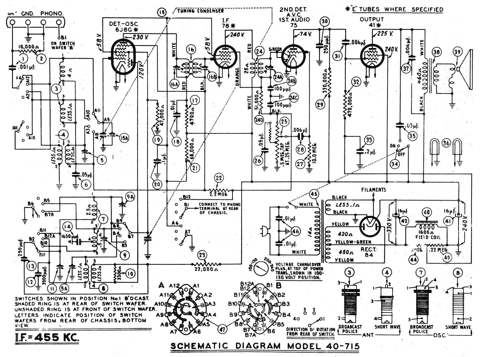

Oh, and here's a link to the schematic if anyone wants to follow along (672 kb):
http://www.philcoradio.com/images/40-715T_schem.jpg
