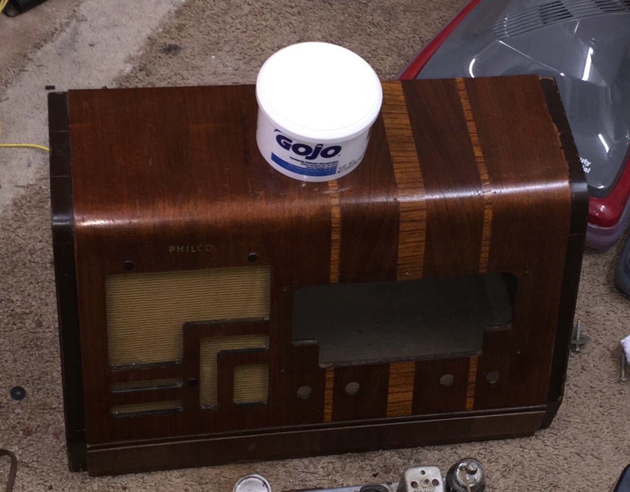

Using Gojo Creme on veneer
I watched a guy on YT do this to his rather nasty looking Philco, and I was amazed with the results! The Gojo Creme is about $2.00 for a good sized jar at your local auto parts store. It cleans the veneer right up! I highly recommend it. Just get a soft cloth and a small helping of the stuff and gently rub it with the grain on your Philco's veneer.

which auto parts store?
Non pumice right?
Works great!
Kirk
I got it at O'Reilly. They have pumice, but I did not want to use that in case it would scratch.

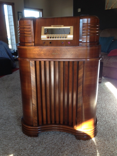

I just did this with my 40-180. I don't have a before picture but this is the after. I love it and would recommend it to anybody. Works GREAT!
"Washing" a cabinet with go-jo is a great way to remove the years of attic dirt. It gives you a better idea just what condition your cabinet is in and whether or not you want to refinish.
I have had many cabinets that literally "came alive" after being cleaned with go-jo.
NEVER use the go-jo with pumice on a cabinet!!
I also use the go-jo first on any cabinet I get that looks promising, no wood damage that needs repair etc.. Have had good luck with it.
