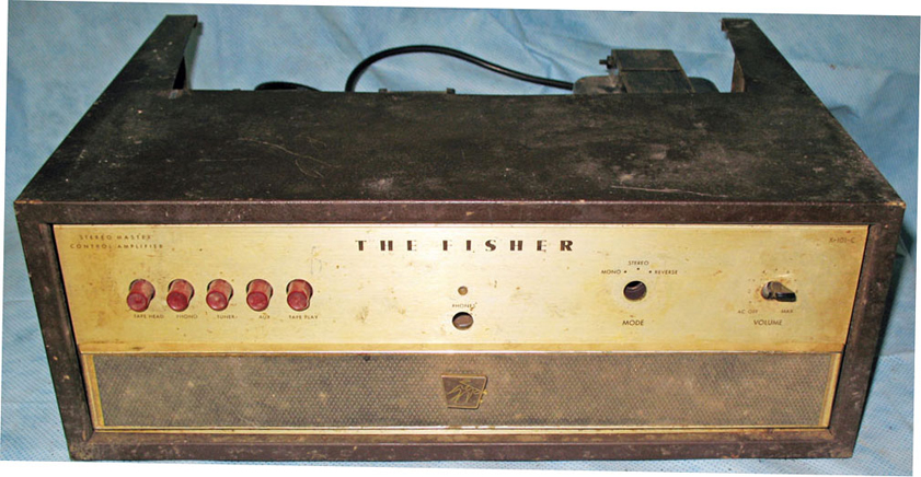

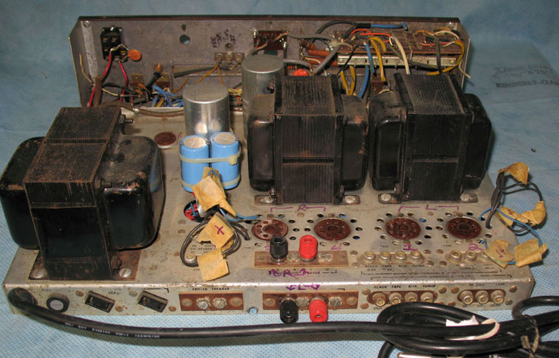

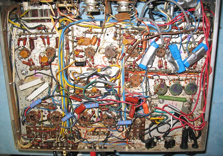

I recently acquired a Fisher X-101C integrated amplifier that had gone through some hacked modifications before I received it. It had served as a roach motel at some period in its lifetime. I have spent hours cleaning both top-side and underneath the chassis. Some of the corrosion they caused underneath will never come off, but I have managed to clean off much of their residue underneath. Top-side I managed to get most of the corrosion to a pretty presentable appearance by using Weiman's metal polish and also Eagle Nevr-Dull polish plus many hours of work. Much of the added wire and components have been removed (much of it was insulated with duct tape). I have been rewiring the chassis as many cables and B+ wires were cut apart and left in place that way. It is a very slow process.
I found a volume control (the type without a switch) to replace the missing Volume control. The Balance control and Mode switch were also missing. I have a new balance control on hand now (they are linear taper, so I was able to find a suitable new manufacture control to use). I will soon get those wired into circuit. The loudness switch tab was broken off, so I have new slide switches to use in replacing all four slide switches. There was too much corrosion on them from the roaches to leave them the way they were.
I have two of the double concentric knobs on order from ebay. Do any of you have spare Fisher P/N E50325-1 knobs? They are the single slender knob that Fisher used with other units such as 400 and 500 series receivers for the on-off volume controls and the tuning knobs. They are ridged on the sides and a brass cap goes on the front. I can get the brass caps, just need the knobs.

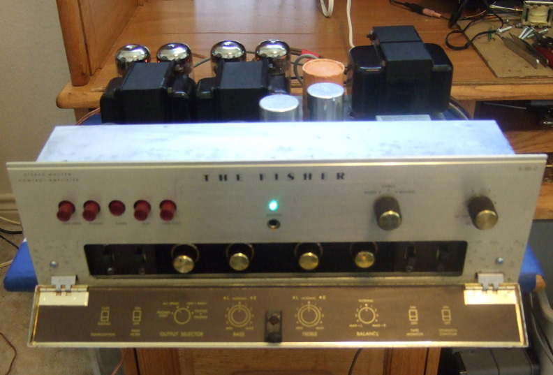

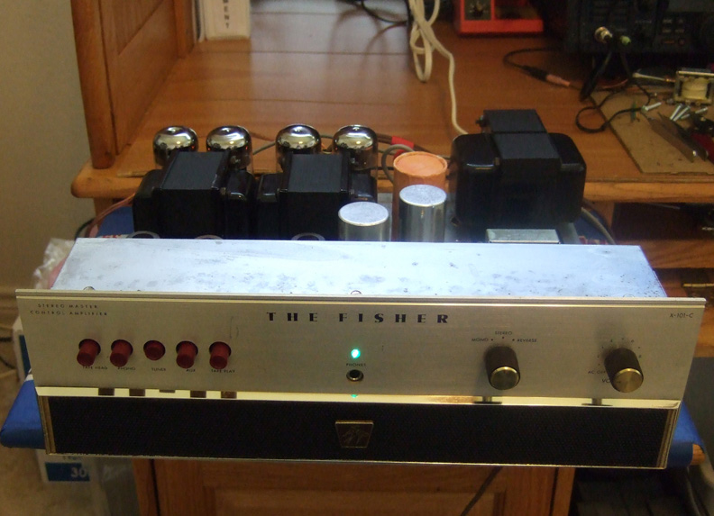

I finished the restoration of the X-101C with the help of Dave Gillespie on the AudioKarma.org site. I performed his EFB modifications as I went along in the restoration.
This poor amp had already seen modifications by a previous owner who only understood enough about electronics to connect things together. It had screen grid mods to the output stages, coupling capacitor values increased by using series parallel values (each one a set of 4 large caps enclosed in duct tape), much duct tape and masking tape, strange wire loops hanging above the chassis, B+ wires and audio cables cut throughout the amp, volume control removed, balance control and mode switch removed etc. Apparently the person was trying to change it into just a power amplifier.
I found replacements for the volume control on ebay, a new balance control, determined how to wire a new make-before-break switch to replace the missing mode switch, removed two added toggle switches. There was extensive corrosion due to being a roach motel for a while both top side and under the chassis. I spent many hours scrubbing and polishing with Weiman's metal polish and Eagle Nevrdull metal polish. Many wires had to be replaced and about 4 audio cables were sacrificed to replace some in the unit that were beyond repair. Most of the rest of the audio cables were repairable and so the original wire color codes were preserved for about 90% of the cabling. New slide switches were installed. RIAA/Tape equalization was deactivated and permanent RIAA equalization applied to both low level inputs, Equalization switch was repurposed as an on/off switch since the volume control I obtained did not have an AC switch on it. The speaker switch was rewired and the missing earphone jack was added. A new 3-pole 3-posn. make before break rotary switch was obtained from Allied Radio and wired to create the mode switch functions and installed. So now most of the original functionality has been restored. A new LV power supply was added that handles Dave Gillespie's EFB modifications that allow B+ variations to cause output tubes screen grids to track any changes and also the negative fixed bias to automatically track B+ changes too. Result is output tubes produce more power with less internal heat dissipation while also reducing distortion. A TL082 Op Amp is added between the preamp stages and the output circuitry allowing the unit to operate as a preamp or a power amplifier as desired. The interconnection point is the old "Reverb In or Out" jacks. The only visible difference externally is a small power transformer top side.

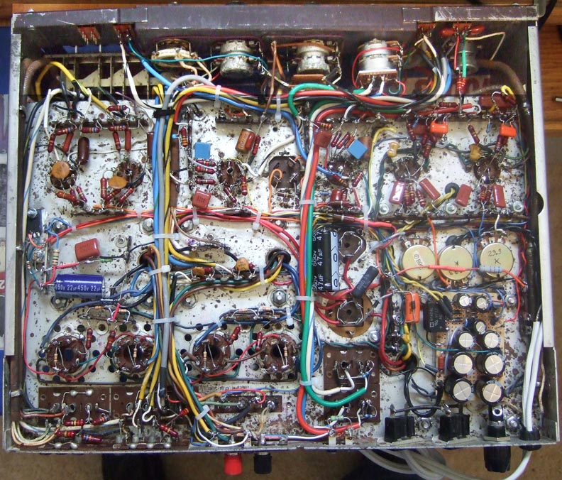

It finally received a new set of tubes and was changed from cathode bias to adjustable grid bias of the output tubes which are now Electro-Harmonix 7591s. Tests showed it produces about 30-32 watts per channel with one channel driven and about 26 to 28 watts with both driven when the output tubes are set to have 30-32mA current per tube. 10 ohm 1/4 watt cathode resistors allow accurate current measurements and also serve to act as a fuse in case a tube shorts. The same is done with the screen grid circuits - a 100 ohm series 1/4 watt resistor protects the output transformers from a shorted tube. I got to test that accidentally when a test probe slipped as I was measuring B+ and one screen grid resistor and cathode resistor immediately went open with a crack sound.
I have been listening to it now for about a week and love the sound.

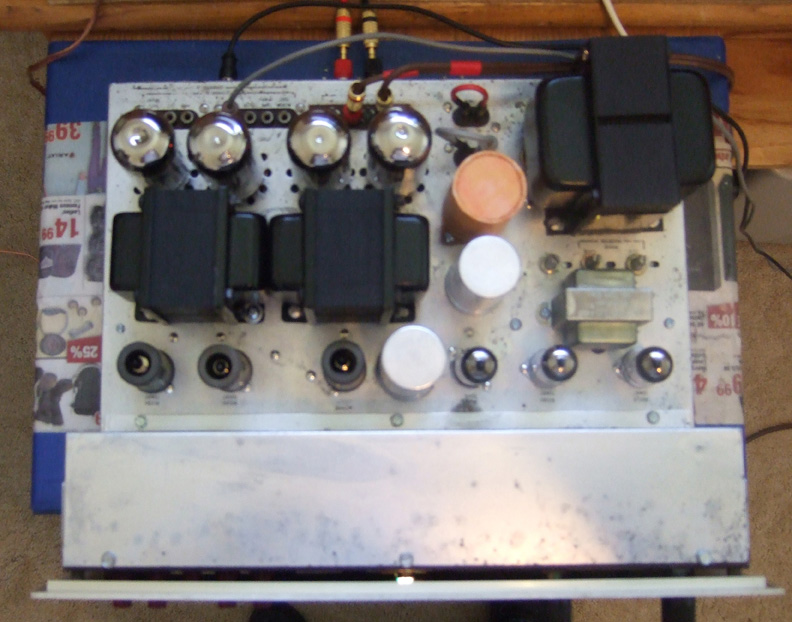

This would not be complete without a few more pictures. One shows under the chassis after repairs and modifications and the other shows the top side with the unit operating.
Joe

One of the interesting parts of the restoration was duplicating the two 200uFd @350V electrolytics in the power supply. I wound up using two can capacitors that are 50uFd X 4 @350V and paralleled them. The one that is above ground potential on the outside metal was about the same size as the original one but I had no insulating sleeve, so I made one using some card stock in a trapezoid shape to wrap the can twice. Once for the inner shorter portion of the top and another to wrap all the way down to the bottom of the outside metal. It was slightly taller than the can height so I could roll the top edge over a circular disc piece of the same card stock. Then I printed a label stating it was 50uFd X 4 configured to make a 200uFd@350VDC. The electrolytics came from Antique Electronic Supply and were ideal for the job. I had one of the bakelite insulation wafers to mount it on the chassis, so I did not have to research that. The end result looks like many OEM insulated caps for voltage doubler power supplies.
One thing I learned about Fisher 500K ohm balance controls is that they are linear taper, not audio taper. Of course the volume control is a 500K ohm audio taper (log taper) control with the loudness tap. I was lucky to find one on ebay, although it did not have an on/off switch. I may eventually try to find a snap switch (also called a micro-switch) with a long straight lever and cut a small slot in the chassis metal, then put custom made brass tab on the control shaft held by a press-on nut that will grab the control shaft and use that to turn the amplifier on. For now a slide switch is handling that task.
The TL082 Op Amp that handles the preamp output is mounted on the back of the balance control. It allows a modification to the driver stage input to prevent Miller effect at the triode grid. It is supplied + and - 11VDC from the LV EFB power supply that also handles DC feeds to the preamp tube heaters plus providing about -50VDC that is used to handle the negative bias adjustment circuit.
