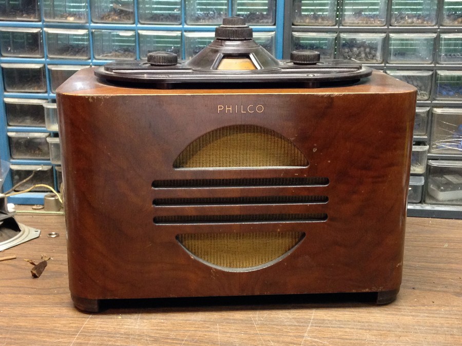

It is unusual in that it has the dial and controls on top, with a Bakelite control panel mounted on a cabinet made of Walnut veneer.

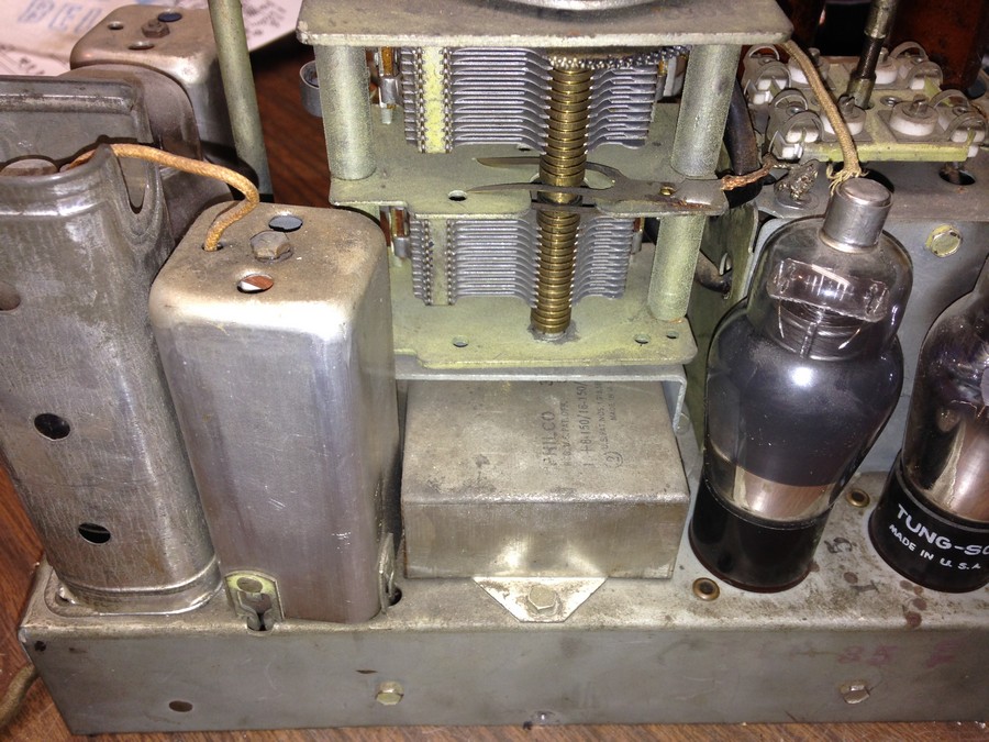

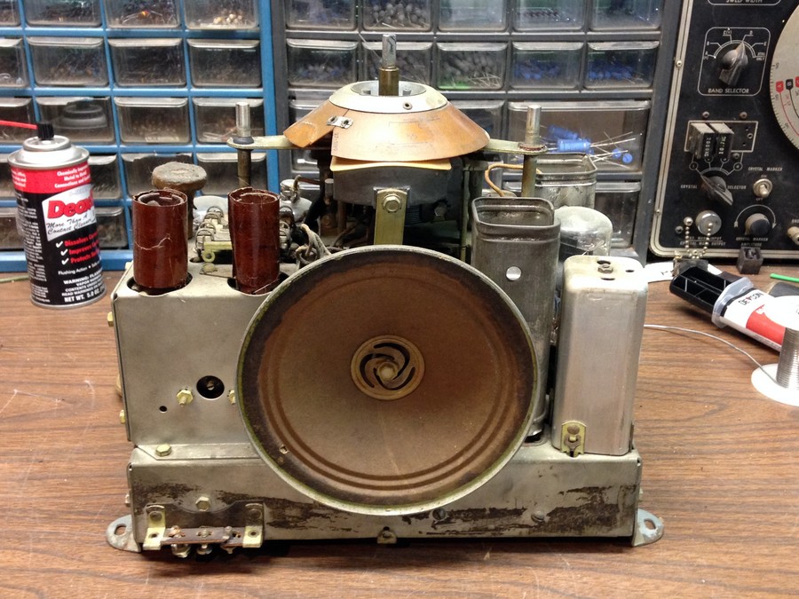

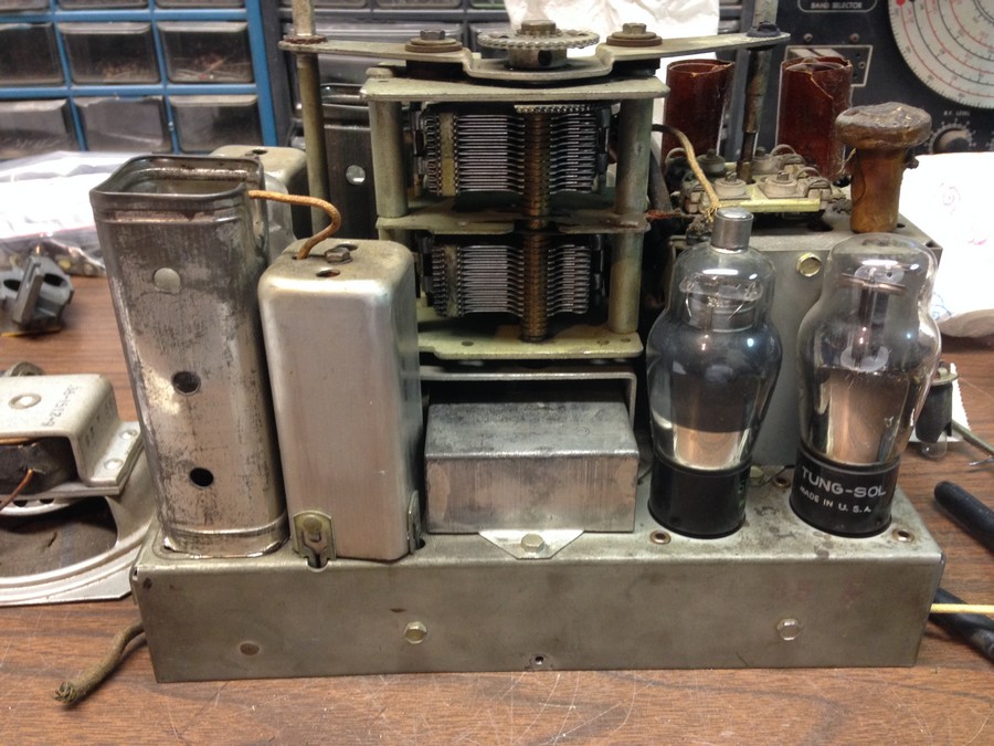

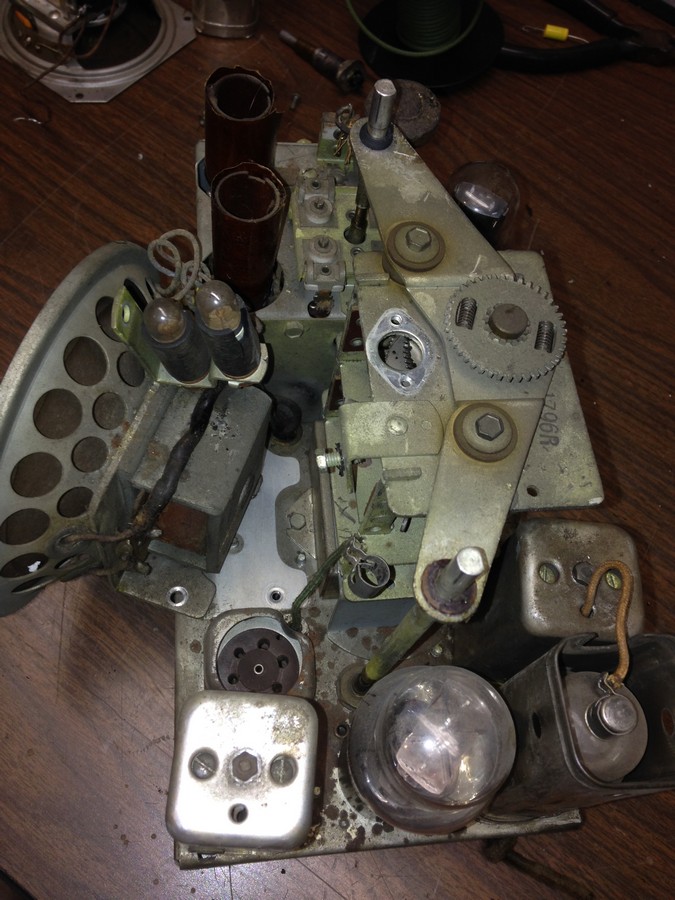

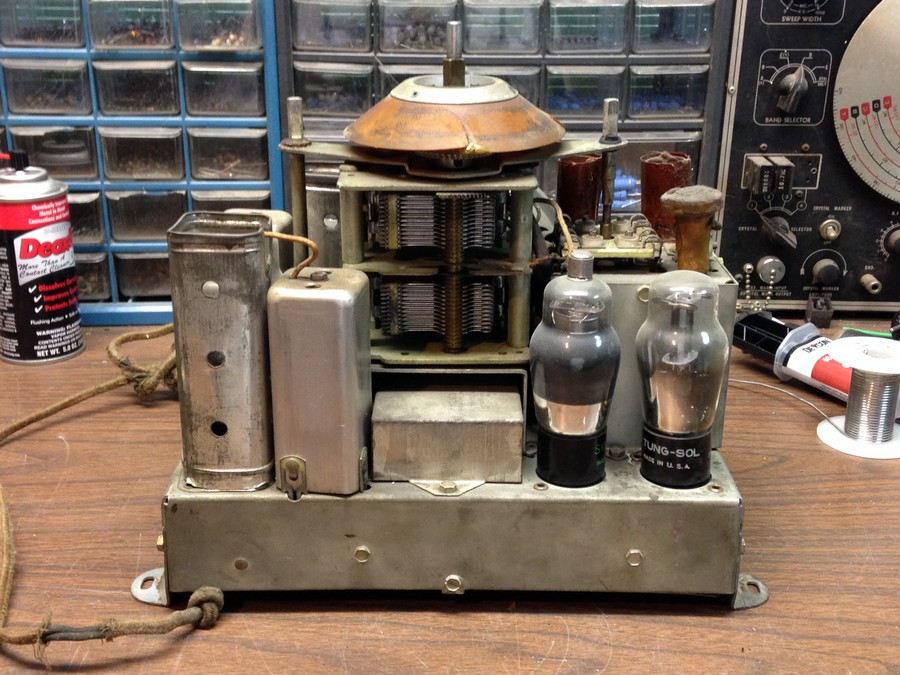

Some chassis shots:
[Image: http://www.philcoradio.com/images/phorum..._00003.jpg]
[Image: http://www.philcoradio.com/images/phorum..._00004.jpg]
[Image: http://www.philcoradio.com/images/phorum..._00005.jpg]

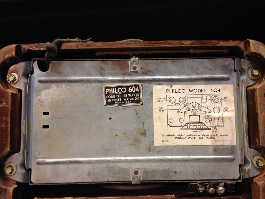

Well, a few days ago, I pulled the chassis out of the cabinet and dived in.
[Image: http://www.philcoradio.com/images/phorum..._00006.jpg]
Removing the screws holding the bottom chassis cover in place...

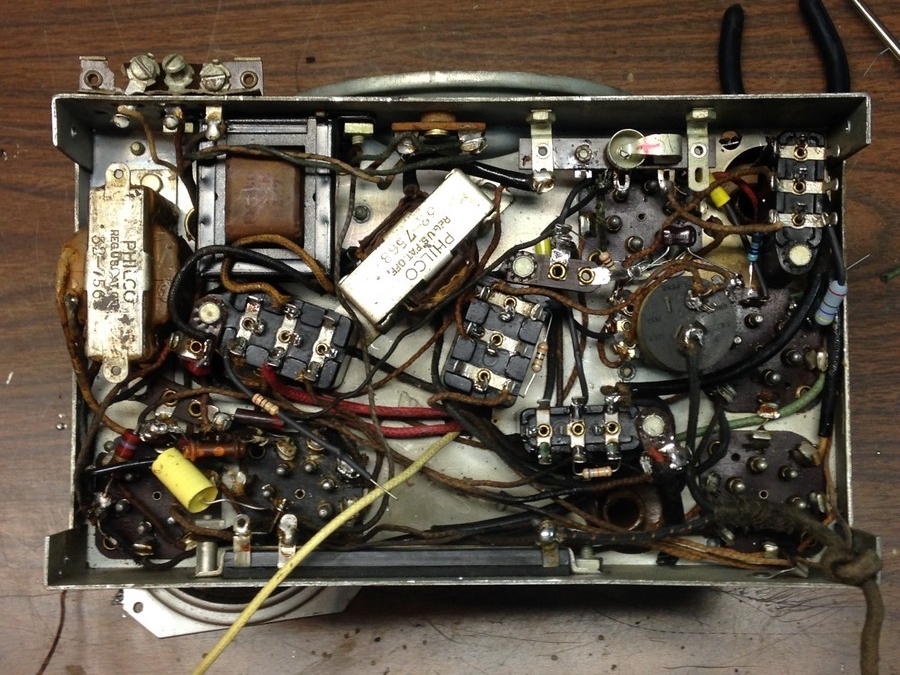

A look underneath. As you can see, someone else was in here before me. I will try to make this look neater than it does now.
[Image: http://www.philcoradio.com/images/phorum..._00008.jpg]

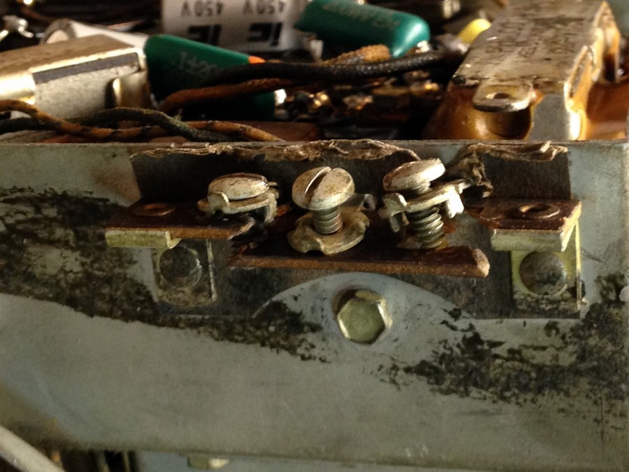

A closer look at the antenna screw terminals. As you can see, the terminal board is broken.

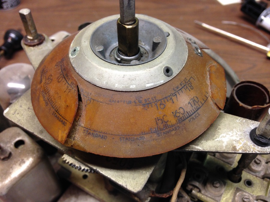

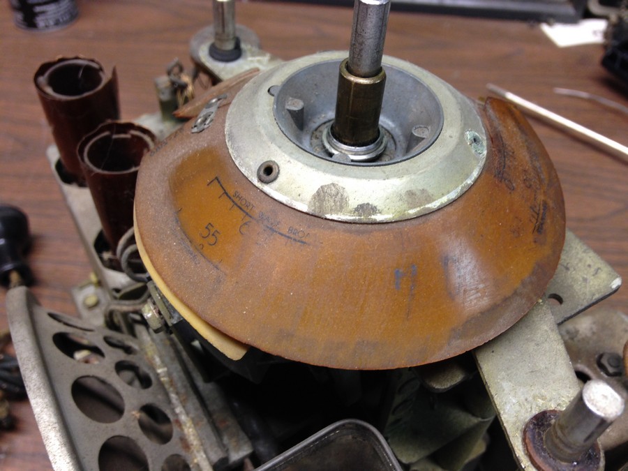

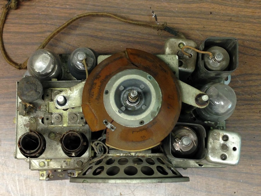

Now let's take a close look at the dial scale...
[Image: http://www.philcoradio.com/images/phorum..._00009.jpg]
[Image: http://www.philcoradio.com/images/phorum..._00010.jpg]
Broken in two places, and part of the numbering is worn off. Fortunately, Radio Daze sells a 37-604 replica dial scale. I guess I will have to purchase one.

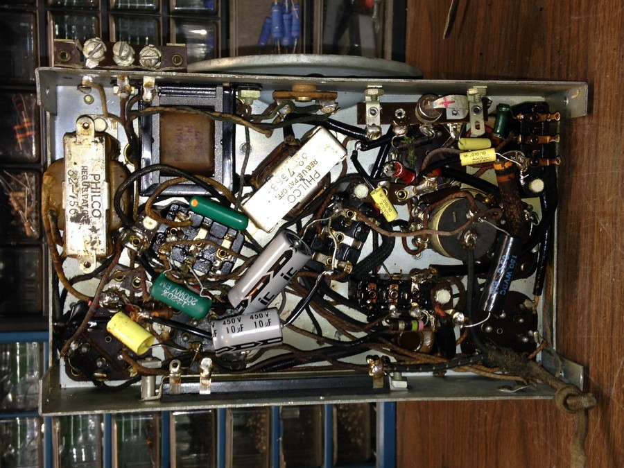

Last night, I began actually replacing components.

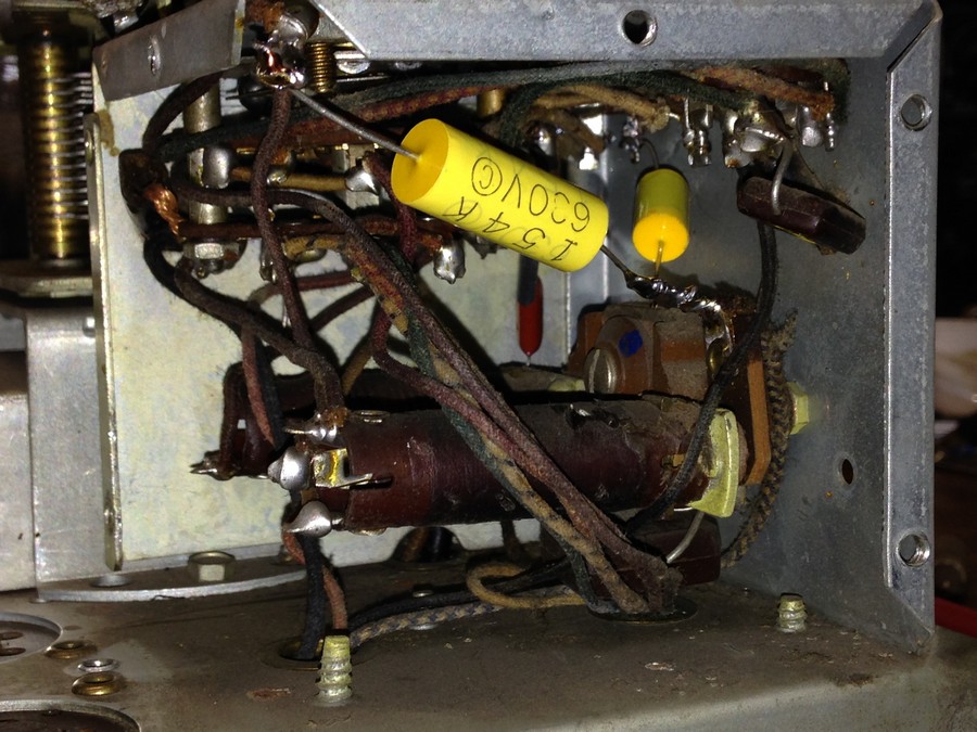

This set has its own unique RF unit which is a metal box that houses the band switch, three paper capacitors, and some wire. Coils are mounted on top of this unit, and there are also a couple coils inside.
You think a 1937 Philco RF unit is difficult to service? Take a look at this:
[Image: http://www.philcoradio.com/images/phorum..._00011.jpg]
This photo was taken after I had replaced all three paper caps. No, I'm not bothering to restuff the old paper caps in this set. It was difficult enough to get the old caps out and the new ones in without damaging anything. Wow! That was tough!

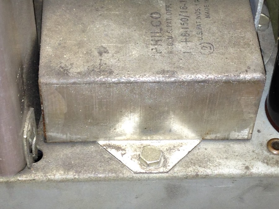

This weekend, I decided to tackle the job I had been dreading: restuffing the metal can which houses the electrolytic capacitors.

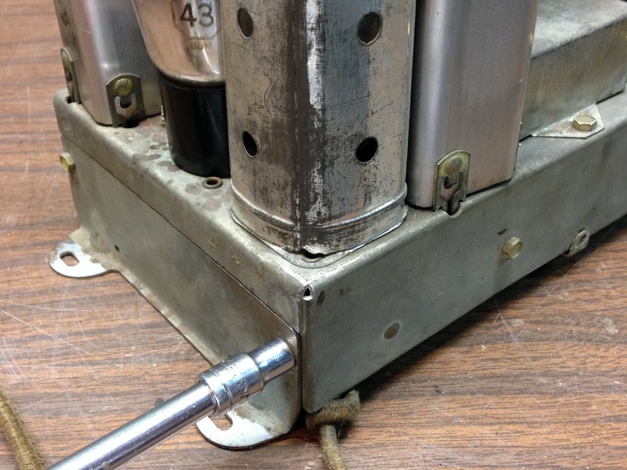

It is underneath the tuning condenser, and is held in place by two bolts. One is easily accessible from behind the tuning condenser at the back of the chassis...
[Image: http://www.philcoradio.com/images/phorum..._00012.jpg]
[Image: http://www.philcoradio.com/images/phorum..._00015.jpg]

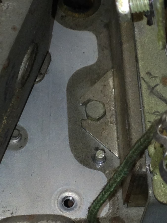

...and the other bolt is hidden by the speaker. Which meant that the speaker had to be unbolted and pulled out of the way.
[Image: http://www.philcoradio.com/images/phorum..._00013.jpg]
Once the speaker was moved out of the way, the other bolt holding the electrolytic capacitor can becomes visible - and accessible:
[Image: http://www.philcoradio.com/images/phorum..._00014.jpg]

Once the two bolts were removed, it was a matter of carefully pulling the electrolytic capacitor can out and away from the chassis.
Here's how it looked:
[Image: http://www.philcoradio.com/images/phorum..._00016.jpg]

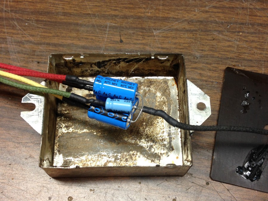

Someone had cut all but one of the wires, and had wired individual electrolytics under the chassis. I am going to stuff new electrolytics inside the original can, using new wires.

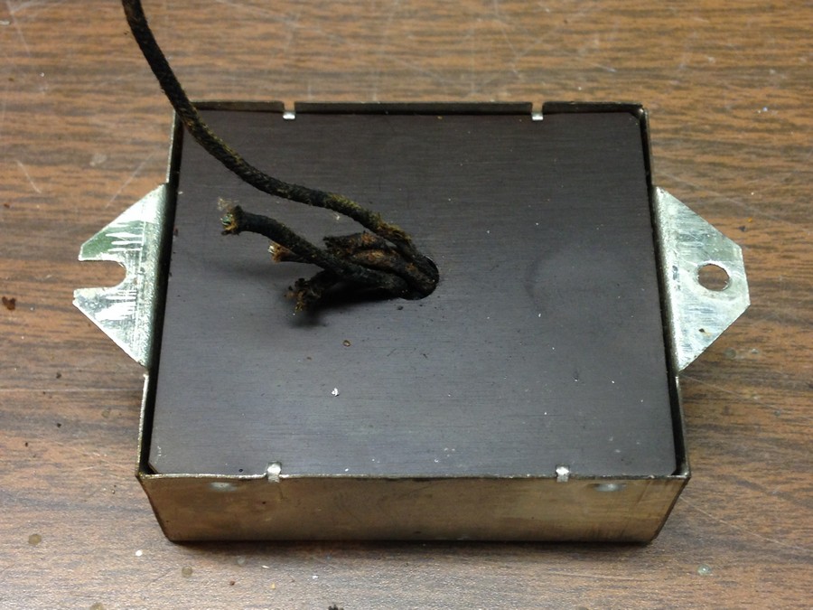

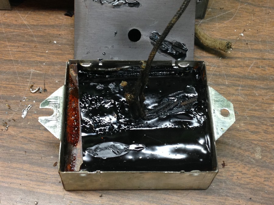

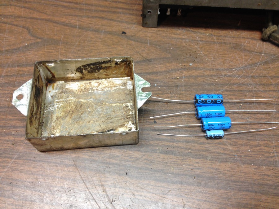

First, the original guts had to be removed. I unfolded two of the four tiny tabs holding the cover in place, and set it aside. Here's what I found inside:
[Image: http://www.philcoradio.com/images/phorum..._00017.jpg]
I was able to easily pry the old unit out of the can.

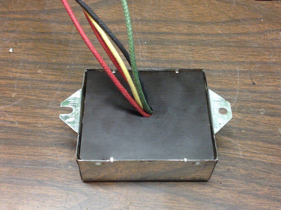

Next, I prepared four new electrolytics to go inside the can:
[Image: http://www.philcoradio.com/images/phorum..._00018.jpg]
I added new wires to the four positive ends. All of the negative ends are connected to B- so all of the negative leads were twisted together and soldered to a black wire.
[Image: http://www.philcoradio.com/images/phorum..._00019.jpg]
I then used some thick paper to make a new insulator to go inside the can, to help prevent anything from touching the chassis. I also taped up the exposed negative wires with electrical tape, so it should be fine.
The rebuilt can:
[Image: http://www.philcoradio.com/images/phorum..._00020.jpg]

Here's how the chassis looks underneath now:
[Image: http://www.philcoradio.com/images/phorum..._00021.jpg]
