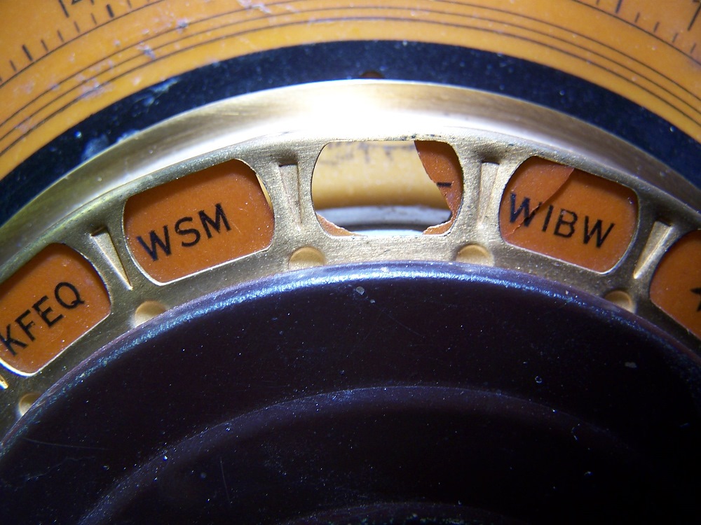

What color were the station call letter tabs on radios like the 37-116?
What material were they made out of? Paper? Plastic? Mine is missing them entirely.

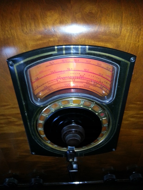

All of the current photos I've seen show beige colored tabs:

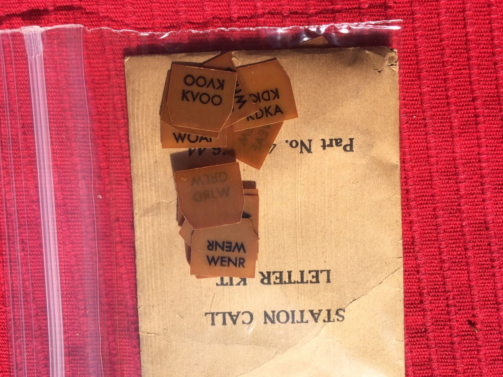

That photo is black and white so you cant get a true color. My 38-116 that I restored has the same and it looks like the same plastic stuff that the dial is made off, I think they call it fonolic or something. I don't think you can get reproductions, you may have to make your own. I didn't bother to get mine to look new, just left them
The material may have been a slightly lighter amber than it is now, but it was certainly never white.
It's phenolic. As Fred mentioned, no one reproduces those tabs.
I have used old broken dial plates and back plates. orange looking
cut and inserted them looks fine
but not all mine were missing just a few
sam
If you have a color printer, you can choose a color a few shades lighter than what the tabs are now, and use that as a backgrounds color, and black letters of the proper font and size, and print them on an ink jet printer. After that, before you cut them out from the page, spray it well on both sides with clear, gloss polyurethane varnish. Let it dry well, and cut the tabs out. I have used this method for several radios.

What are the exact dimensions of these? I'd like to make them as close as possible to the originals so if anyone could provide the length x width that would be a big help!
 Since you don't have one to compare or make a template from , I would pull dial off and make one that fits good and use that as template for the others.
Right - well I found this very detailed picture of the tabs:
If I just had one of the dimensions I could compute the rest. Icon_smile
Just about everyone has a Philco dial that's been washed clean and that's what I use.  For lettering I use clear matte laserjet labels and MS Word.  If you look into the fonts you will even find the star.
