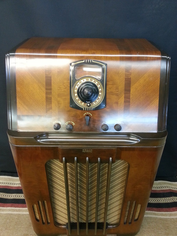

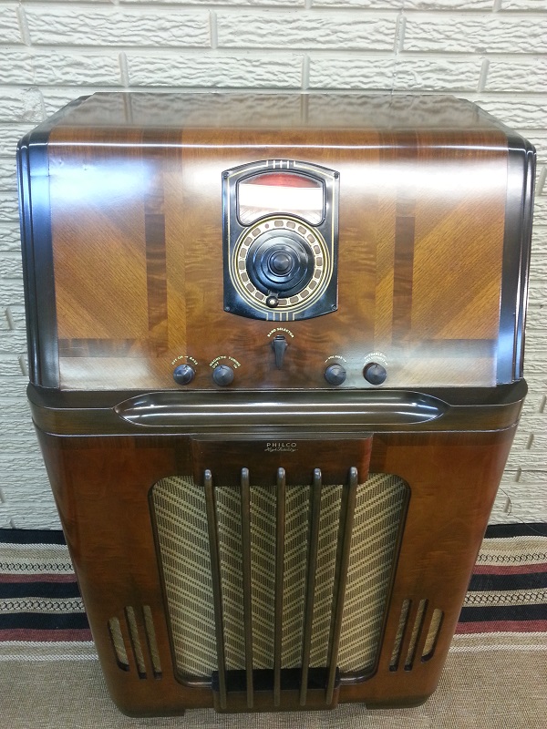

I saw a post on ARF about a guy asking what grille cloth to use for his Philco. It looked like he needed the same stuff that I will need on my 116X or 116-122 restoration project. I've included some pictures of the cabinet and a small pice of the cloth that i cut from one on the clairfiers. RD doesn't look like they have a match, matter-of-fact theirs looks like just the opposite colors that I need. Radio Daze has their cloth #41 that's close. So what cloth is out there I can use? Thanks guys.

That is 1938 Philco chevron cloth; entirely wrong for 1935-37 Philco sets.
If you order from Radio Daze, you want #03 (GRC03), not #41 (GRC41).
If you order from Kenny, you want the Philco Chevron cloth.
OK, I thought so. I'll return the stuff and get the GC-03 stuff.
Thanks.
