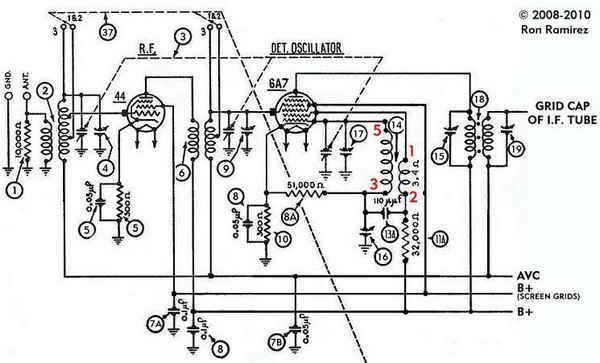

Here is a partial schematic showing the changes to the Philco 89 oscillator circuit.
[Image: http://www.philcoradio.com/images/phorum/osc_009.jpg]
Forgot to mention - Steve, you bring up a very good point. If you prefer to keep your 89 or 19 original, baking your set's oscillator coil in an oven at 175 to 200 degrees, for 30 minutes, is a must to drive out any residual moisture. Sealing the coil with lacquer after rewinding the tickler winding is also a must. And keep in mind you may have to drop that oscillator cathode resistor to 8.2K from the original 15K.

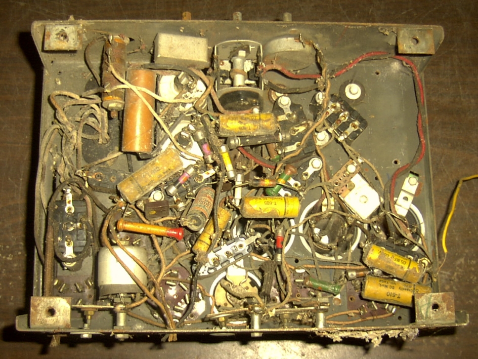

Philco 89 chassis before restoration:
[Image: http://www.philcoradio.com/images/phorum...89_016.jpg]

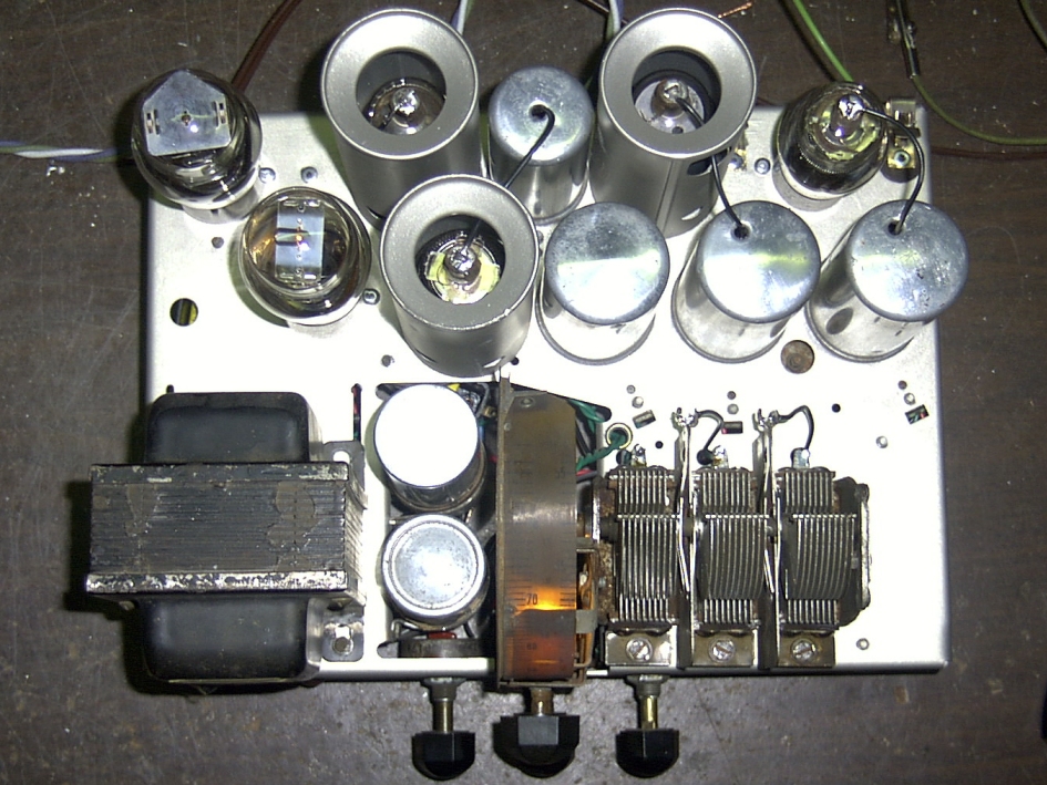

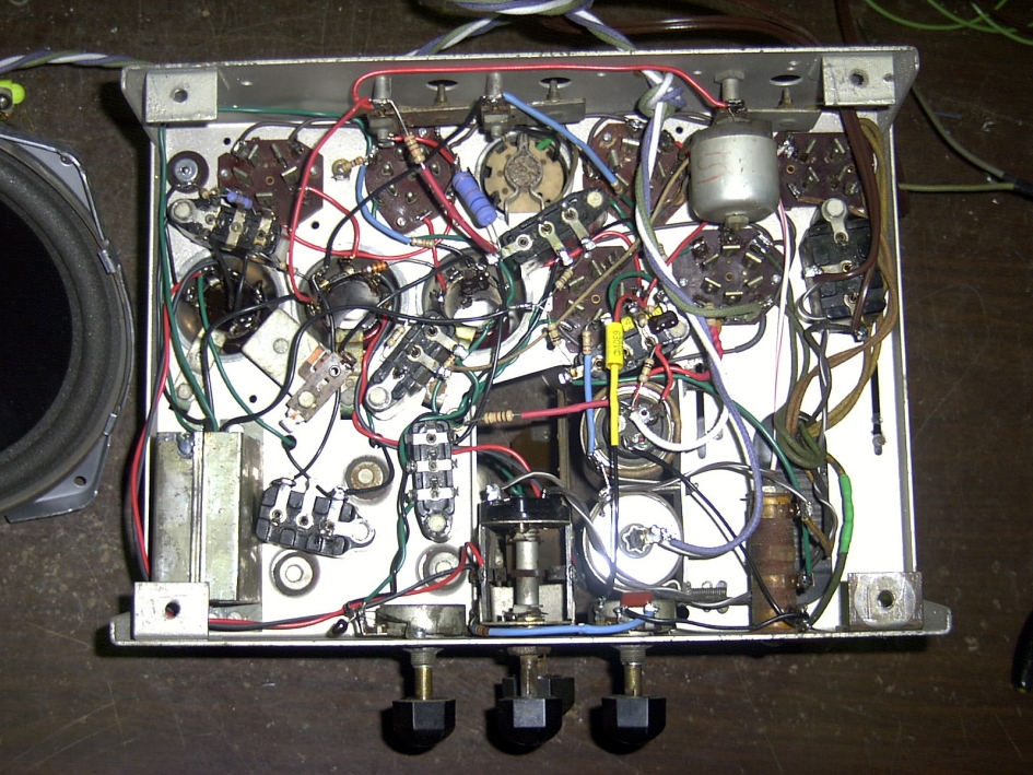

Philco Super 89 chassis after restoration/modification:
[Image: http://www.philcoradio.com/images/phorum...89_024.jpg]

Thanks, Brian.
This is precisely why I chose this chassis as the "guinea pig" to perform the 6A7 mod - because it was in such rough shape.
Obviously, the power transformer is a replacement. The original was toasted.
The coils had their usual problems. And the oscillator coil was completely rewound anyway, to correspond to the Model 18 style oscillator circuit. I was really lucky in that both IF transformers were OK. The off-on-band switch responded well to a thorough cleaning.
And it was on this set that I finally managed to nail down the trick of rebuilding the electrolytic condensers so that they appear to be original, when looking at them from underneath.
Needless to say, I am quite proud of this chassis. I'll be even prouder, once I complete restoration of its cabinet, originally a Model 32B tombstone cabinet.

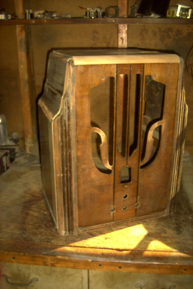

Here is the 32B tombstone cabinet - the future home of the Super 89 chassis - in progress.
[Image: http://www.philcoradio.com/images/phorum...89_010.jpg]
I've added a piece of quarter-round where one was missing above the front panel, and have also done a lot of gluing. Believe me, it looks a lot better in this photo than it really is. Still need to stabilize one of the grille cutouts, the one at center right where there is an obvious break. Also need to fill some cracks and defects, then sand down and refinish. I am going to try and save the finish on the front panel if I can.
