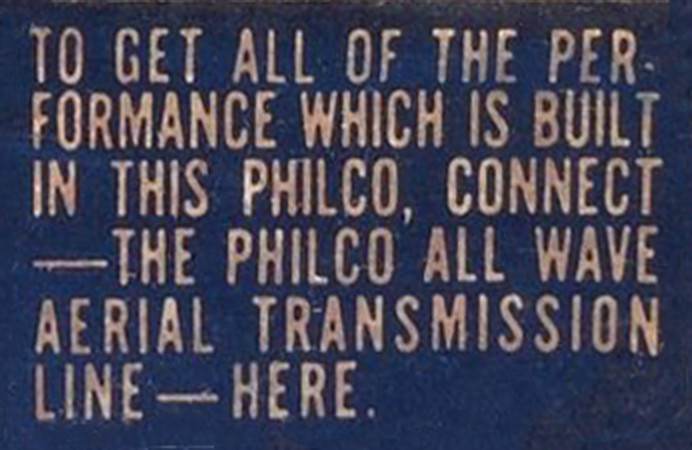

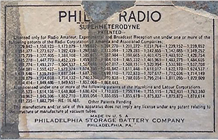

I just finished restoring a Philco 645 tombstone that was missing the chassis labels (aerial, patent, model). As luck would have it there was an eBay listing recently for a 645 chassis that had clear pictures of the labels. I used Photoshop to re-create the labels based on the photos:
Reproduction
[Image: http://i1072.photobucket.com/albums/w374...ypzvmu.jpg]
[Image: http://i1072.photobucket.com/albums/w374...cptnfi.jpg]
Original
For comparison, here are photos of the original labels:
In order to use them as a template I corrected for perspective (the original eBay photos weren't straight on) and sized according to the marks for the original labels that I could still see on the chassis. Icon_biggrin
Hopefully someone else will find the reproduction labels useful too so I've attached them here as PDFs. It should be simple to modify them for use on other similar models as well since it's not a scan but a structured graphic.

Nathan,
Do you happen to have the Patent label in some format other than PDF.  I was hoping to possibly start with it to make a label for my 81 Jr.
Thanks, Bill
Sure - I made the label in Photoshop. Will that work for you?
https://drive.google.com/open?id=0B64cfW...nZSalhpOUk
Wow! That patent label must have taken hours!

Very Nice! what did you use to actually create the labels? standard printable labels from staples perhaps?
I used matte photo paper and then glued with rubber cement. That's really too thick though. I think self-adhesive paper would be best - something not too thick. I'm going to try that next time I make labels anyway.
