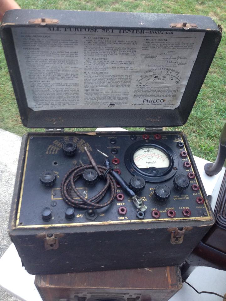

So I got this set of testers from our own Ron at K-town.
I was going to make 1 set but figured they are both all there so why not make 2?
One even has a real nice 33 Philco globe in it. I will need to find 2 Philco batteries to go inside for OCD reasons but I have seen people make them so I will do that if I cant get originals. One is a bit worse for wear but glue, clamps and Tolex will do the trick. I have Terry to help with the Tolex application since he is a master leather worker.

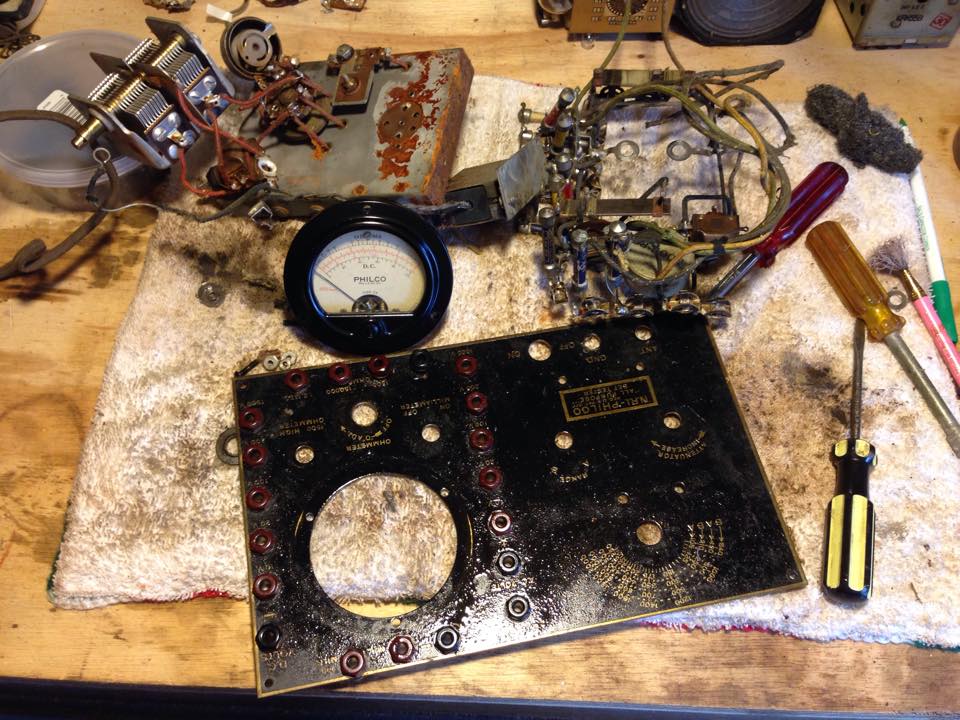

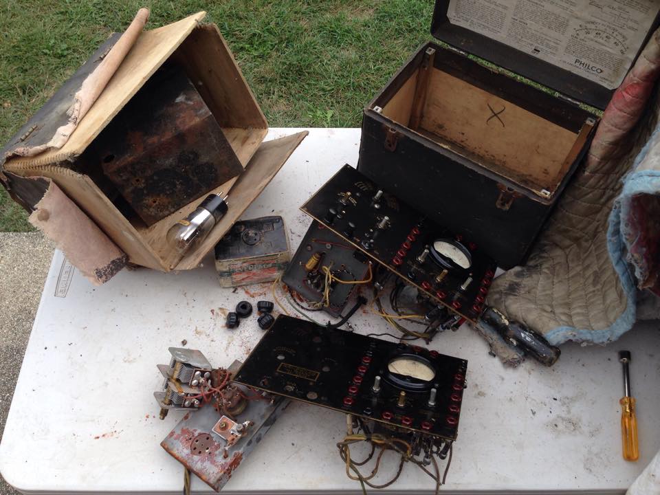

I have dismantled one completely and left the other whole. I may need to reference it on rebuild of the other one.

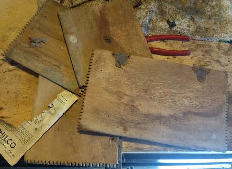

I think the tolex was the only think holding this cabinet together, Icon_lol

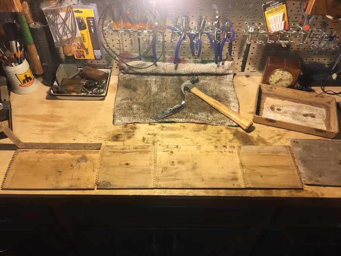

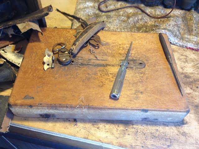

I removed all the Tolex and hardware and it collapsed.
Good for me since now I know what joints need glue... (all of them)
I need to get new butterfly rivets, Tolex, rust dissolver, Spray glue, and something else?? Oh, My head examined  Icon_crazy

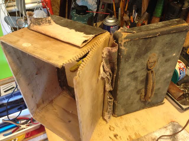

The other cabinet came out great with spray glue and a good cleaning and polish.
Nice to see someone has equipment older than mine!

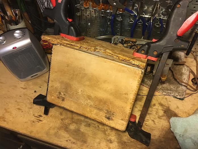

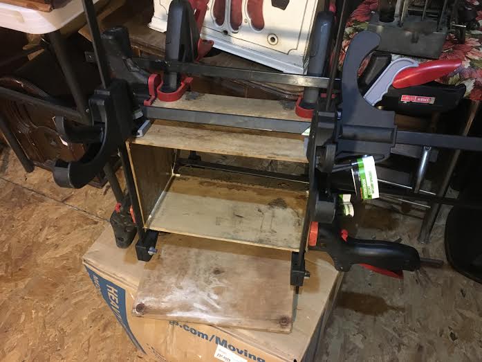

It fell to pieces but I reattached all the sides after soaking them and flattening them. First the 4 sides and now the bottom is gluing.
