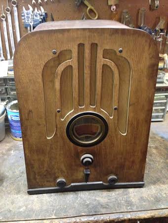

Re-Faux decals for my set. Today was a beautiful day to work outside, and to spray poly, so I decided to begin the prep of the cabinet for the photofinish. I first removed the trim piece at the bottom front, so the whole cabinet front was a single smooth surface. Then I began to block sand the old phtotfinish off with 180 grit sandpaper, followed by 220 grit as a finish sanding. I used a sanding block throughout to keep the surface as level as possible, especialy around the ribs and holes, although I did have to touch up around the speaker bolt holes by hand as they were slighly pulled into the surface. After sanding, I raised the grain with a rag dampened with water, let the surface dry again, and lightly sanded it smooth again. Then I shot it with the first coat of polyurethane. I will apply one more, and sand smooth before applying the decals when they come. Here are some pictures.
[Image: http://41.media.tumblr.com/d2af8980238ab...1_1280.jpg]
This is how it looked before any sanding

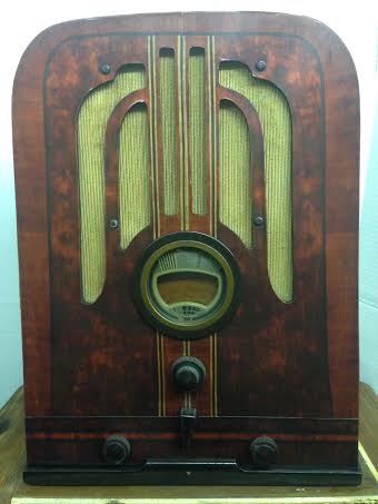

Well, I applied the Re-Faux Pro decals. I found that they do not quite align with my cabinet, the pattern printed on them was just a little bit too large, I think. It looks a bit better than it did, but that is about all that can be said of it. I have written Tony, to see what I can do about it. I figure I will have to re-do it at the very least, but unless I can get a set of decals that align better than these, I don't see much point. Here are pictures to show you what I mean. Be sure to look at the picture in the post above to see how things aligned originally.
[Image: http://40.media.tumblr.com/fbc013e2d4623...1_1280.jpg]
[Image: http://41.media.tumblr.com/feb231fc20086...2_1280.jpg]
[Image: http://41.media.tumblr.com/d166a5d77f267...3_1280.jpg]
[Image: http://41.media.tumblr.com/c7fb2a483b8ec...4_1280.jpg]
I have written Tony and sent him these pictures to document my problem. I'm not sure if there is a solution. Stay tuned for further details...

Beautiful job, but it is the tombstone model, and uses a different set of decals from the ones I had to use. The application would have gone quite smoothly if the size and alignment had been correct. The problems came because I had to keep trying to re-position the decal to get things to line up the best they could.I have no problem with the thickness of the decal material, personally. I just wish it had fit better.
I have been in touch with Tony at vintageradiolables.com about this, and he has been very responsive. He had to make the decals from photographs of the original radios for this model, since he did not have a cabinet to measure. He and I are working to get them right. Does anybody here know if the blueprints of the original front panels or the original faux finish decals exist ? If so, I would like to get them to Tony so he can better make these decals for us. This goes for any models, not just mine. I think such blueprints would be of GREAT help to him.
