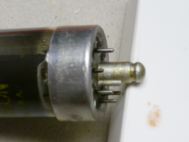

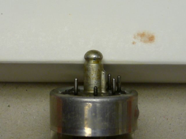

Everything else looks good. Did find this on the 50A5 a short pin (pin 2)
Was supposed to go to Charleston Sc on Thursday for a Navy reunion I'm pretty sure it will be cancelled.
Yep you got the right pin 2 on the 7C6 it's the triode plate (1st audio stage)
The short pin on the 50A5 is unused so it doesn't matter.

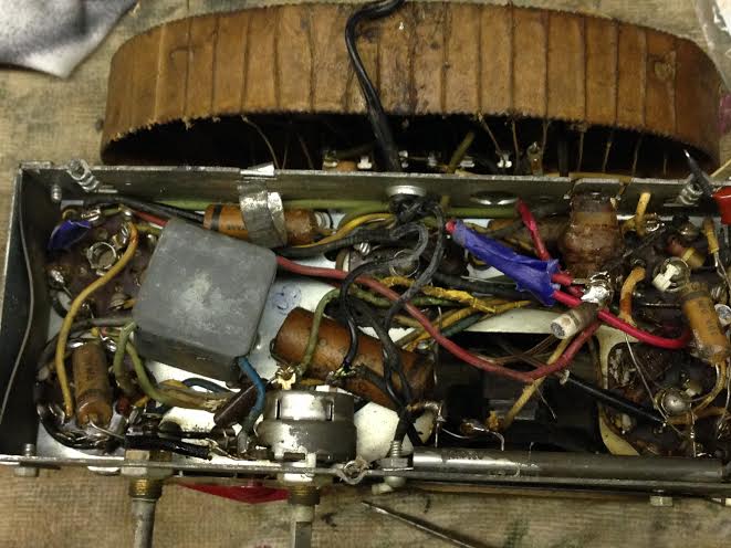

Finally got back to it, also got the 35A5 but I had a problem to sort out mainly putting a cap end to the wrong place that's where your voltages helped me fined it and I replace some brittle wiring. The radio plays great so I decided to do a experiment. I put back in the 50A5 and the radio works pretty good almost no difference on the strong stations but the weaker ones were pretty much gone.
Thanks for all the help when I get it together I will post a picture.
