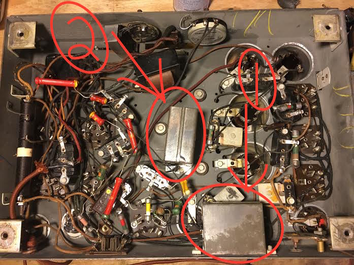

I am doing my 90 and those 2 darn big multi blocks are confusing me... I actually followed the entire schematic but cant figure these out.... Any help is appreciated...

I was just recapping a single 47 philco 90 a week ago. The #24 (#1 in your pic) block capacitor (03325) - 3 black wires - all .25 mfd caps; grounded to the chassis. The #30 (#2 in your pic) block capacitor (03327) - black wire is 1 mfd, white wire is .25 mfd, and the green wire is .1 mfd; all three grounded to the chassis. Good luck.
