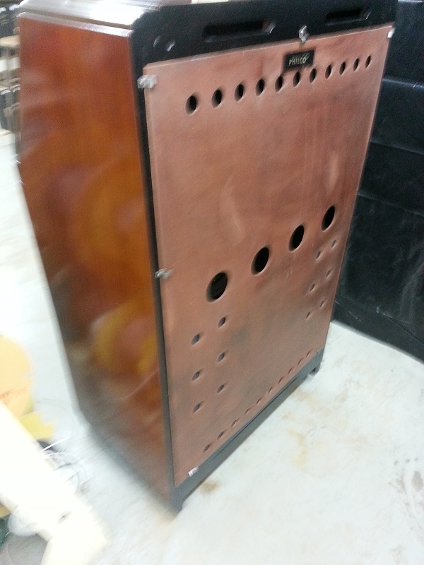

now if some one would do a 38-116 ? Icon_thumbup
(11-29-2015, 07:06 PM)sam Wrote:  winky dink
looks great Icon_clap Icon_clap
Here you go Sam, sorry for the slight blur Icon_crazy Or I can sharpen  it to crystal clarity with taking a new photo of the back cover I made for my restored 38-116xx. It was copyed from photos seen on defferent web sites and is pretty close to the factory design. This is only pic I have of the rear cover on this 38-116xx. I can make one for you if you need one.
That's impressive. I'd have never known where to start.
(12-08-2015, 06:26 PM)LET-UT Wrote:  That's impressive.  I'd have never known where to start.
Actually its not the same looking as an original but looks good and serves the same purpose, the radio sounds better with one on it Icon_eek
