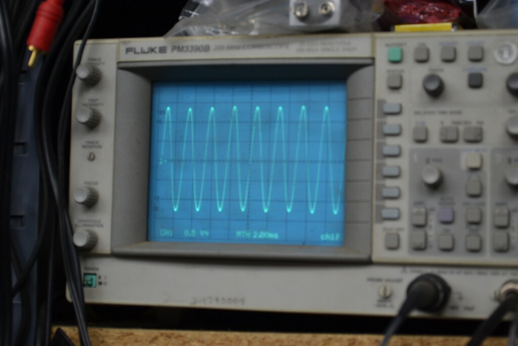

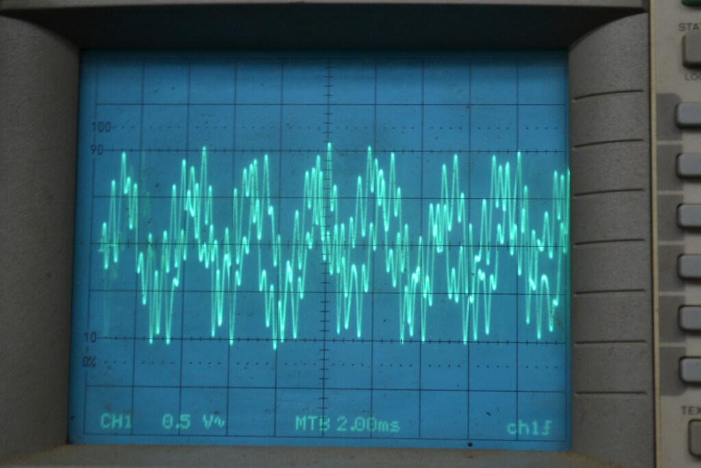

Progress report:
One bakelite block that I didn't get (that I thought I had) solved both the nasty clipping AND the poor AGC action. Block was #79, filtering for 1st audio suppressor and grid bias. Basically, what I think was happening is that at low volume, things behaved more or less normally, but as I increased the volume, the audio signal was modulating the suppressor grid as well as control grid bias, so it was clamping the plate signal by feeding in an out of phase signal.
Scope attached to plate of 1st audio, radio tuned to 1700 KHz, generator at 1700KHz with 400Hz tone.
Audio from my inhouse AM transmitter at 1620KHz. (thank goodness for the Police Band on this set)
Audio is now beautiful, though I still have a few paper caps to replace, but mainly these are in the tone control circuit.
