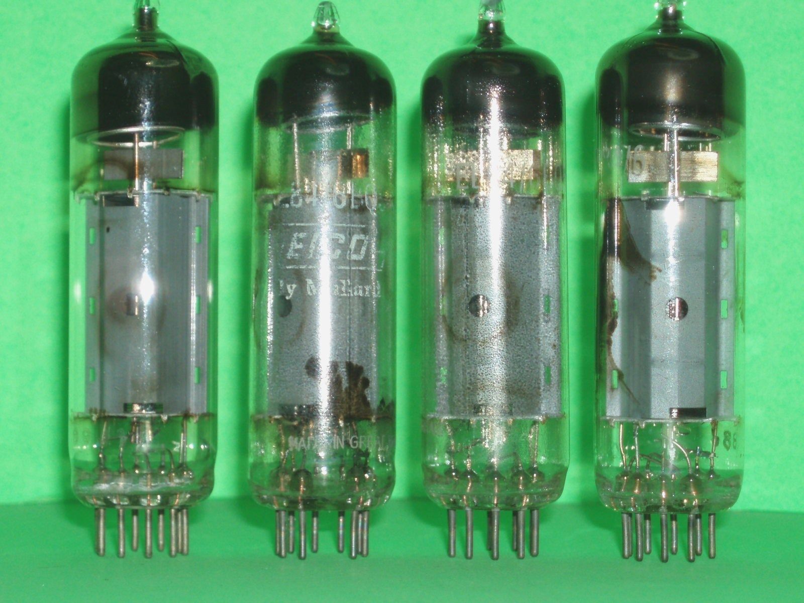

In searching for some tubes for my Fisher, I am a little puzzled about the cost of the older 6BQ5 tubes made in England, esp at the Blackburn plant. I wonder what is so special about them to drive such a high price, even for well used tubes. Can someone more Hi Fi savvy than myself enlighten me?
I can remember pulling a set of these out of an old VM "Hi Fi" record player and thinking they were bad since they looked all black and burned up - needless to say, they weren't the problem, and unfortunately are long gone, along with the record player by about 40 years  . (and yes, I robbed the pic from Ebay)

What justifies the price? Absolutely nothing but audiophools thinking that an EL84/6BQ5 made in a Phillips owned subsidiary, in Britain, using Phillips machinery, manufacturing Phillips designed tubes to Phillips manufacturing specs, with a label saying "Mullard" in water soluble paint rather then "Phillips" makes them better tubes. So whether the label on the tube says Phillips, Valvo, Mullard, Rogers, or Amperex, (sorry can't remember the name of Phillips' French tube company) they are all the same tubes other then the label and the box. The only reason why people think that they are something special is because a lot of classic HiFi manufacturers used them, and that was because Mullard probably offered them for a cheaper price then RCA or Sylvania would have, and offered to print their name on them like those EICO branded 6BQ5s. But a refuse to believe that because a tube is made in Blackburn, England, rather then Eindhoven, in Holland, is better when it's the same company.
