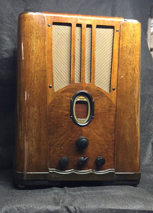

After six frustrating years of trying to achieve a nice finish on my late version 116, I’ve finally finished. I must have stripped and finished, stripped and finished, probably five times over the years before it came out looking the way I wanted. It’s a fantastic performer with a dead-on dial and for the time being will keep the 8” PM speaker that I put in years ago. The photo doesn't do it justice.
Oddly, I couldn’t align the IF to 460 KHz, nor 465. It only wanted 470 KHz so that’s where it stays. Being that this is the very last 116 model and somewhat scarce, I wonder if Philco production techs didn’t use IF transformers from the 1937 series.
Pete AI2V
Very nice looking. Maybe Ron or someone could speculate about the I.F. setting.
It really is beautiful. That was a real labor of love on your part; well done!
Nice job Pete!
I've got it's brother but haven't done much with yet. Some moron drilled a 9/16 hole in the side of the cabinet. I was hoping against hope that it was for an AVC switch but Ron sez NO.
TA has one with a 116X chassis and spkr in it, no clairfiers.
It's funny that I offered this chassis for free, fully recapped, aligned, and functioning but no one ever came around to pick it up! After that I decided to go ahead with a full cabinet restoration. Tnx much for the person who never showed up! Its now among my most treasured Philcos. These 11+ tube Philcos are spectacular performers and I wish I only had the room to show (and use) them all!
Pete AI2V
