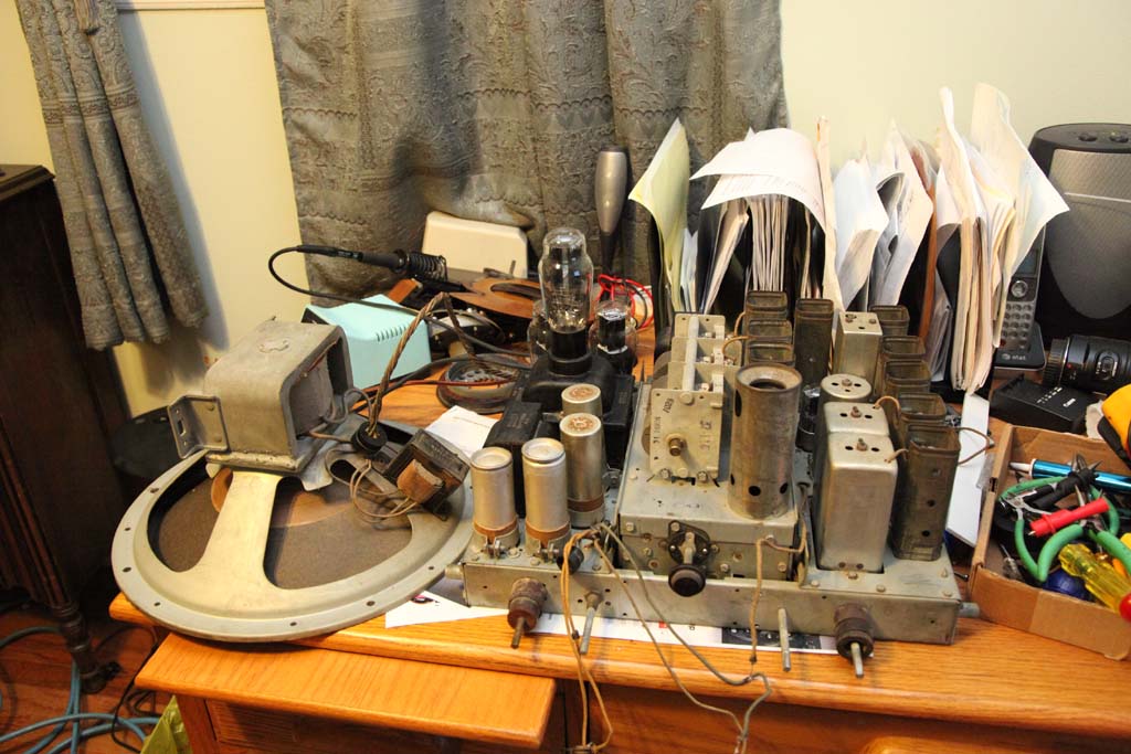

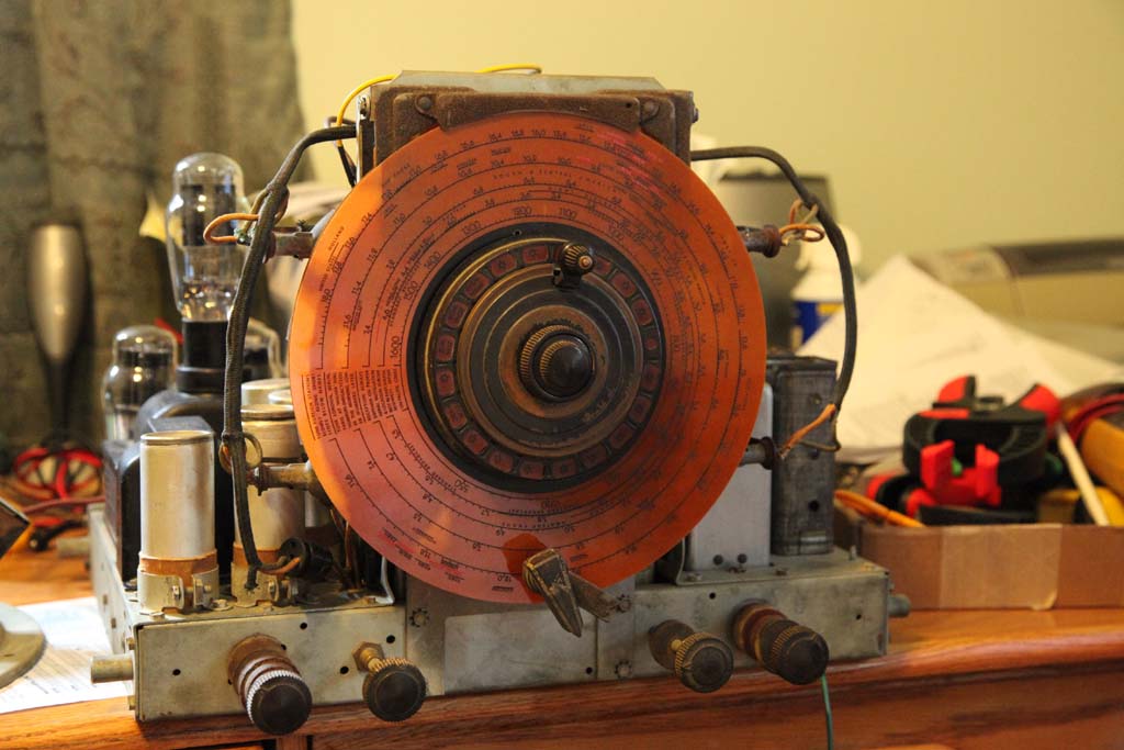

Congratulations on your new 37-116! As it happens I just finished the restoration on mine today. This model really is impressive - it would be interesting to hear how it compares to your 38-116.
You didn't say if you have the 'Standard' 37-116  (shadow meter) or 'Deluxe' (teledial tuning). I've got the more common 'Deluxe' model. Here are some pictures of dial light wiring from the front of the chassis:

Lots more random pictures here.

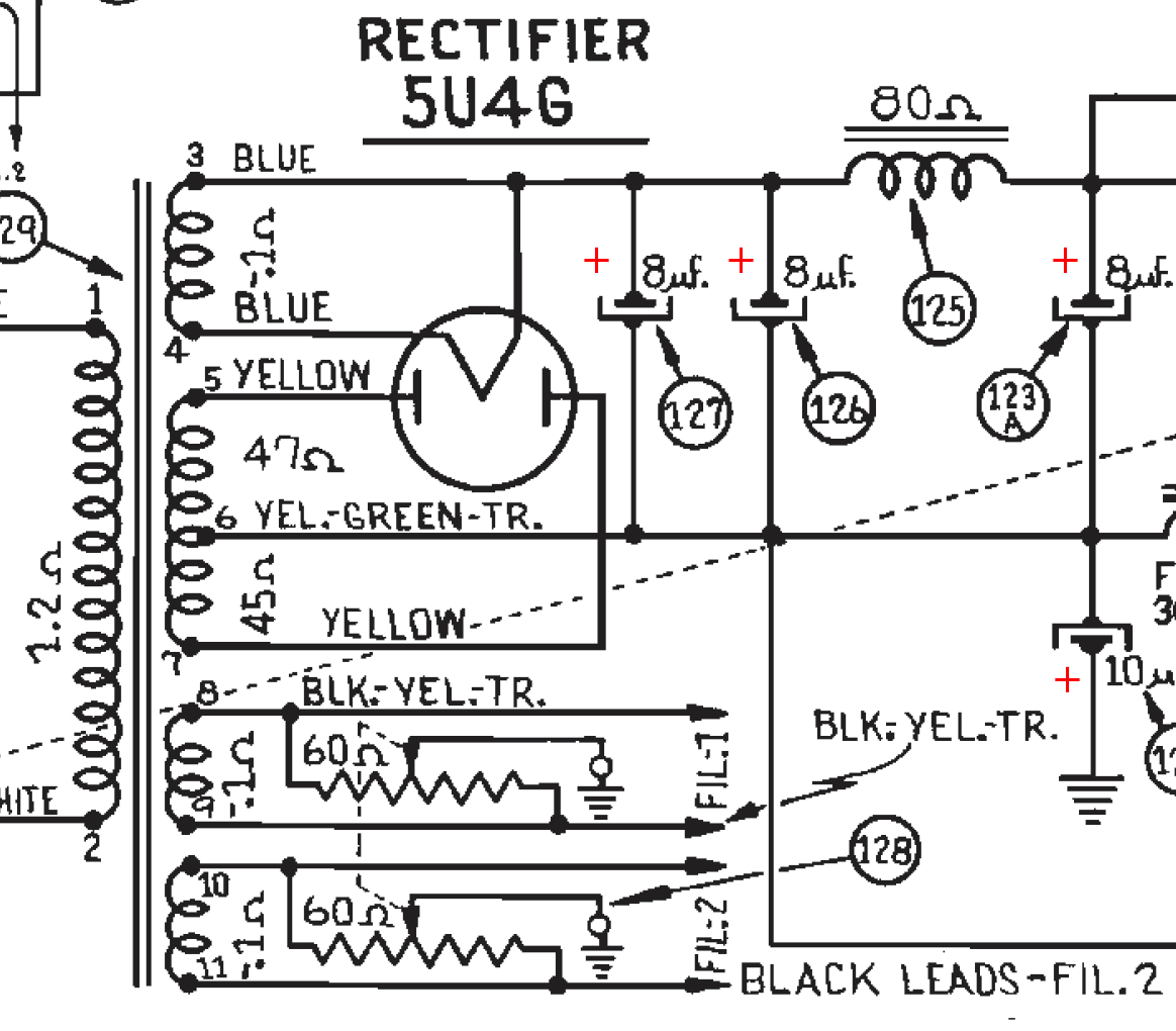

As for the electrolytics, the polarity (if that's what you're wondering about) is actually labeled on the schematic. I finally realized that during the 37-116 restoration that the smaller 'piston' center part is the + (think of how a large can capacitor looks) and the larger encompassing part is the negative can. So for example below I've marked the positive terminals:
   Just think,, as if it is a male,, and female part-----BUT,,not all schematic show this ,,,so clear,,, Cheers,,,Ken

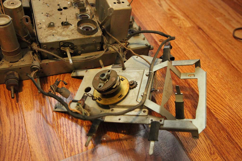

Actually I think this is probably a case of a revision that Philco made. Looking around on the web I do see a few other 37-116 chassis wired like mine with red and white wires. Those picture are also correlated with models not using the speaker plug - but earlier pin mechanism.
But... now I understand what you're talking about with the plug. Check out these pictures (don't remember where I grabbed these from - apologies if they belong to someone here on the Phorum! You might recognize your workbench...):
There is the plug. Now if I can get the male end of that harness, I can whip something up.
Thanks for clearing that up for me Nathan.
murf
