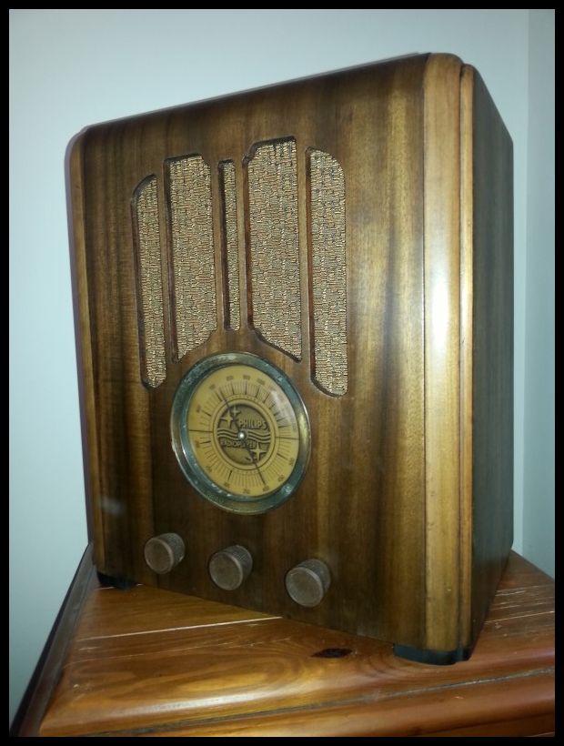

Yesterday I thought I would see if I could do a 1-day project and get one going and looking ok. One day? What was I thinking
I picked the one with the better cabinet, and grabbed the stripping gear - no, not the velcro pants and clip on bowtie... paint stripper and acetone... get your mind out of the gutter. Wait, what do you mean I was the only one thinking that?... ok, its late... I should stop waffling now... any time now... please make it stop...
Anyway, a couple of hours later I had this:
[Image: http://i241.photobucket.com/albums/ff222...dkcgse.jpg]
Please don't note the stain from spilled acetone on the grillcloth. It survived 80 years and then some idiot wrecked it by being careless. I still want to kick myself. The acetone practically just ate the gold weave and disolved it... leaving holes. sigh... so I ended up having to take it out.
as this was an exercise in speed with some care and minimal attention I didn't want to do too much to the cabinet. Actually I really prefer to leave some life in it so the dings and scrapes were left as-is. I simply painted the black trim black again, and gave the whole cabinet a really good going over inside as well as out because a bird had sat on the OP TX and power-pooped down the inside of it! (to say nothing of all the rodent poop in the bottom)
[Image: http://i241.photobucket.com/albums/ff222...soedwj.jpg]
I then put some new felt feet on it, shellaced the whole thing, and hit it with the dark oak Briwax. Thats it, done. By lunchtime.
[Image: http://i241.photobucket.com/albums/ff222...atx09v.jpg]
And of course I needed new grill cloth. All I have that is suitable is some repro stuff I got for the 37-630... PHILco... PHILips... near enough
[Image: http://i241.photobucket.com/albums/ff222...sjvfbn.jpg]

I like that dial and the Knobs with the logo on them.

I like how you left the cabinet somewhat weathered. Looks like the underneath is in good shape; no rodents made it in there. Lot of cleaning on top side of chassis, but should clean up nicely. Did you check the coils and tranny yet?
Good luck with restoration.

(04-24-2016, 06:49 PM)Paul Philco322 Wrote: I like that dial and the Knobs with the logo on them.
I'm quite fond of the look as well. I guess Philips had money to throw at custom knobs. The dial is similar in size and shape to the Pacific set I posted in here a while back... I suspect it was a standard size and fitment for RCNZ at the time. I'm pretty sure the dial glass (plastic) will fit both.
(04-24-2016, 07:43 PM)Mike Wrote: I like how you left the cabinet somewhat weathered. Looks like the underneath is in good shape; no rodents made it in there. Lot of cleaning on top side of chassis, but should clean up nicely. Did you check the coils and tranny yet?

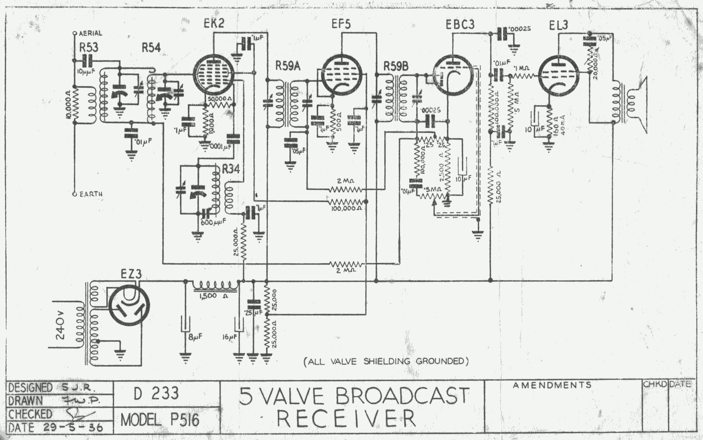

I'm building up a schematic for it too since there isn't any service info for this model anywhere. Its mostly done but its considerably more time consuming and mind-bending than following an existing schematic to rebuild a chassis. Its also made slightly more complex by using Philips tubes and style which does not follow what I'm used to. I'm getting there though. Having two chassis' helps and hinders since there are subtle variations. A friend also has one, but his uses gold series 4V valves rather than the red series 6.3's so thats another variation to consider.

Done with the schematic... its taken a while, but now at least there is one... E&OE!

A quick final note on this set - a few days after I finished hand-drawing the schematic out (4 days of back-and-forth checking and drawing and redrawing) the librarian from the NZ Vintage Radio Society emailed me and said, "Look, we just took possession of a collection from an old retired radio serviceman and he had a great collection of Philips stuff - is this the radio you were looking for?"
