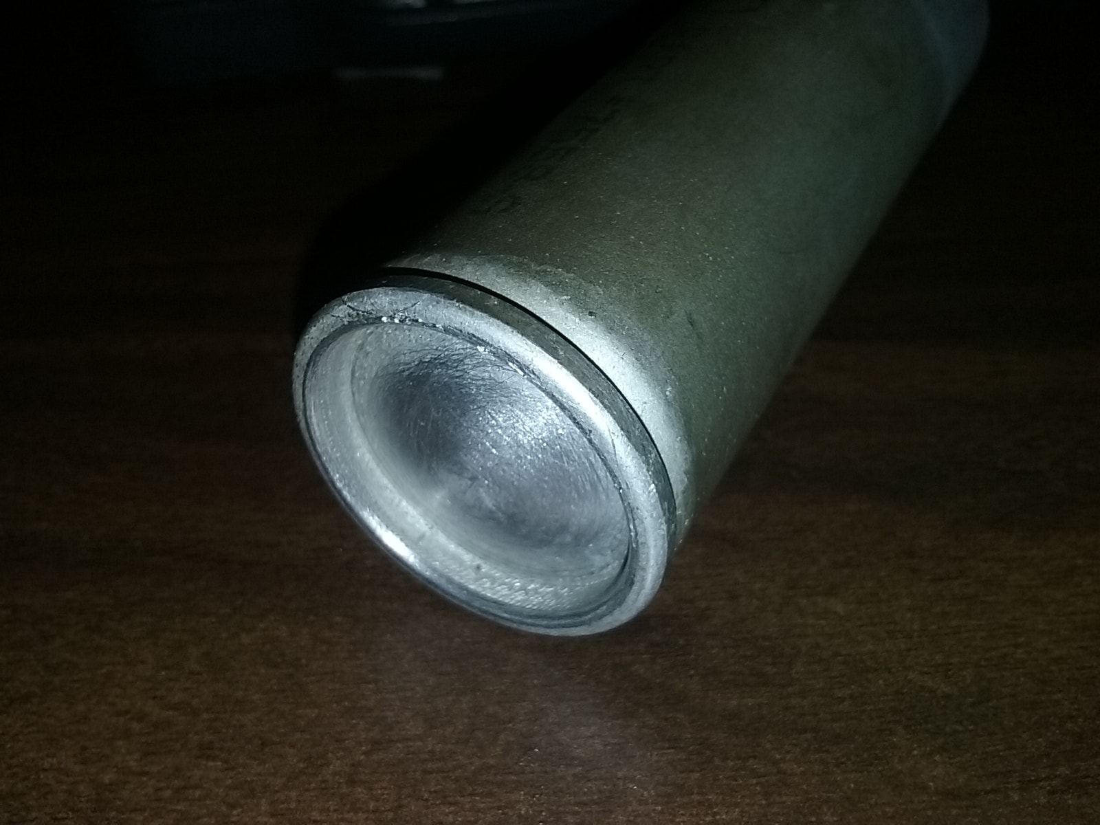

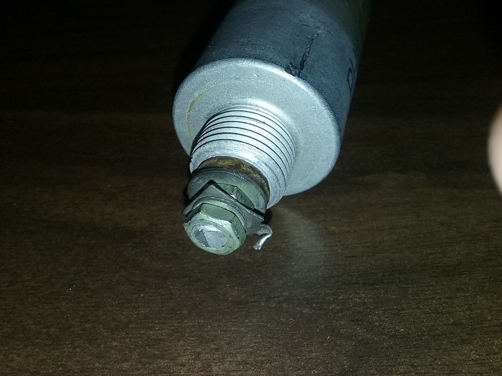

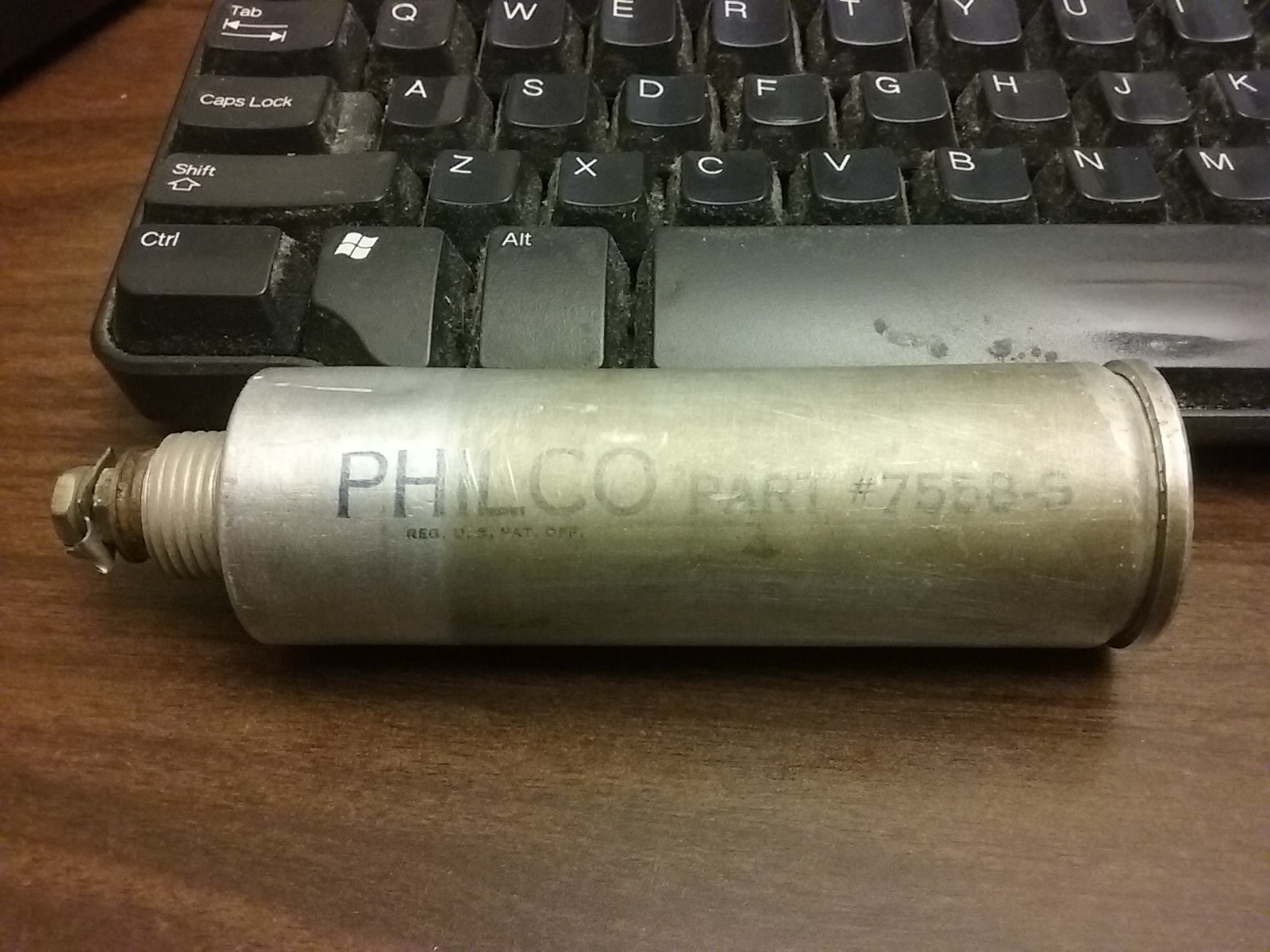

I am curious about the best way people have found to open can capacitors for restuffing. The one I am currently trying to do is a Philco Part #7558-S.
Any tips, pointers or suggestions are appreciated.
Thanks, Bill

There are many different style cans out there. The one Bill shows is the one I like to restuff. The cut can be made just under the top where it's not noticeable. And when restuffed and glued back together, the can still has strength if you should grab it while handling the chassis.
