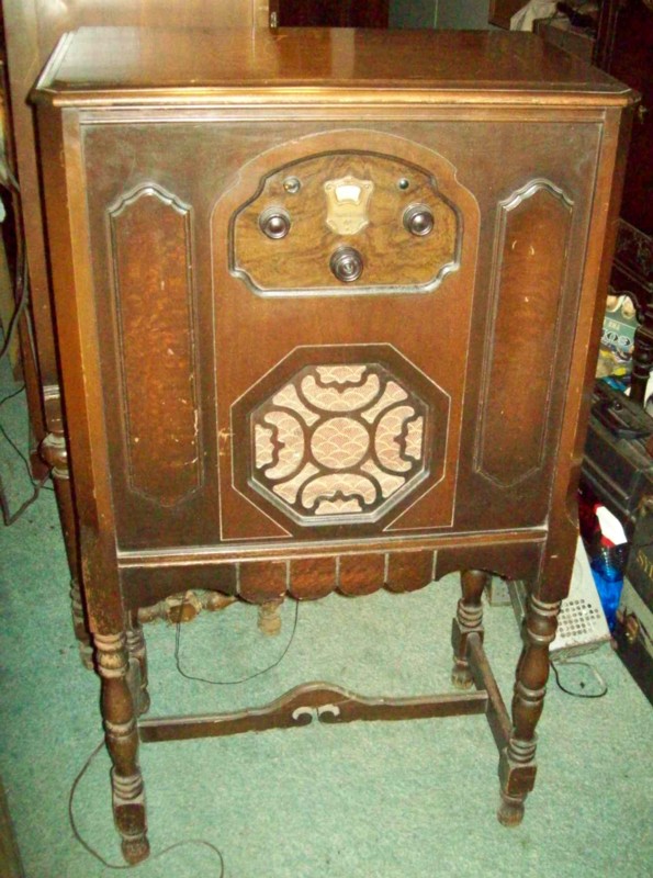

Here's the Atwater-Kent model 60 console I mentioned in a previous thread. Had it going fully for a short bit with no apparent issues, then the sound cut out. The good news is, after a recheck the speaker is just fine. My digital meter just doesn't have enough oomph to read all the windings in the field coil. It's plenty healthy. The bad news is, something on the chassis must have gave up the ghost. No funky smells or smoke, just kaput! Luckily all the expensive stuff seems fine yet. It will eventually live again. Icon_smile I guess not all radios can be like the Radiola 66 I bought years back for $35. Still works great! Icon_biggrin

The grill design on yours is kind of unusual. I can't decide if I like it. But I do like the way that cabinet is toned. I hope if you refinish it, you manage to keep the coloring close to original!

I did just sell one of these, unrestored, but working (not guaranteed). As I was setting it up for sale it cut out. Also no drastic failure, just no sound. It turned out to be a rusty grid clip on one of the 224s. I have seen this before. Those AK clips were likely to corrode.
I had to replace a grid clip on this one before I tried it out. It was loose on one of the 24's, so I lightly squeezed it and it crumbled. I would say a capacitor or resistor gave up the ghost as the sound just faded out and that was that. Checked the tubes, even swapped tubes with no change.
