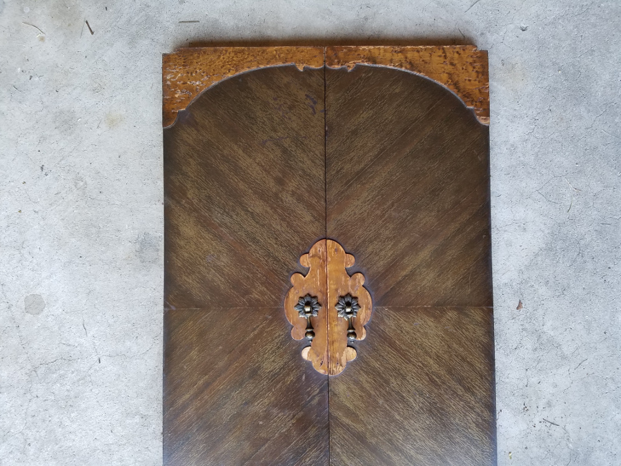

1) Does anyone know what type of wood was used for the 'accents' (I.e. the lighter color wood)?
2) Is what you see in the pictures more or less the actual color of that accent wood?  Would they have used any toner on these?  I'm worried if I strip and re-lacquer, will it look right?
3) Do those pull knobs just unscrew to remove?  They don't go all the way through the door, so I'm thinking that they probably screw in.
Thanks,
 The veneer was birdseye maple I believe, if it isn't it would be a good match. The pulls may screw in or then may be nailed, but probably have screw threads on the back side if no nails show.
