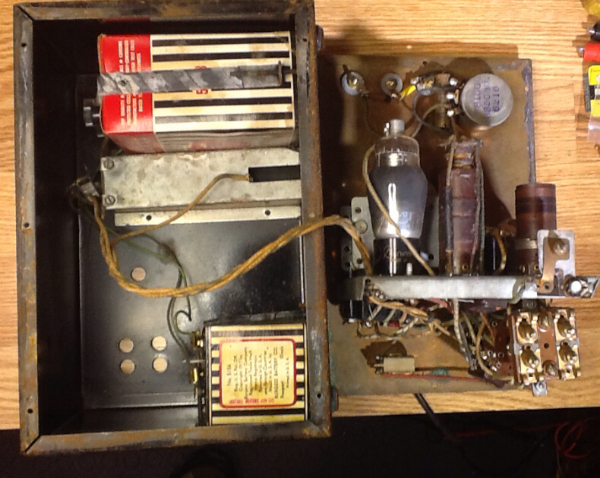

Here's what it looked like when I first got it:

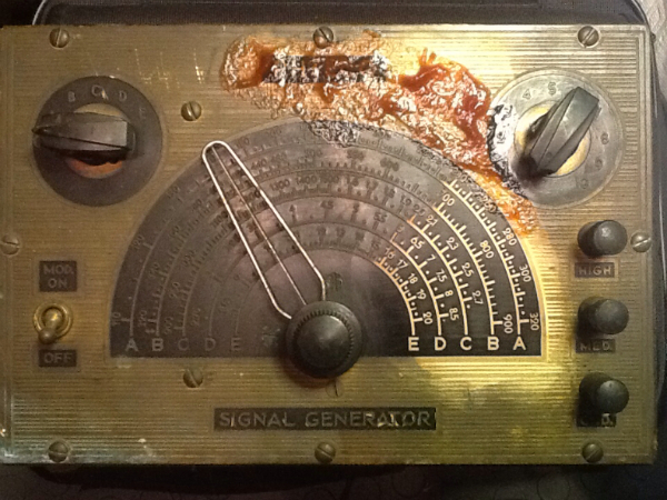

Starting into the physical restoration,  I really didn't want to remove the original black paint on the face.  The face is some type of brass alloy - I thought it to be possibly brass and copper but I'm not a metallurgist.   So I brought out my secret weapon.... KETCHUP!   Yep, Ketchup.  I put it on a small section of the dial, waited 20 minutes, rubbed if for about 5 minutes with my finger and it worked!  I'll let the Chemisty majors out there explain the reason.  Here was the first pass:

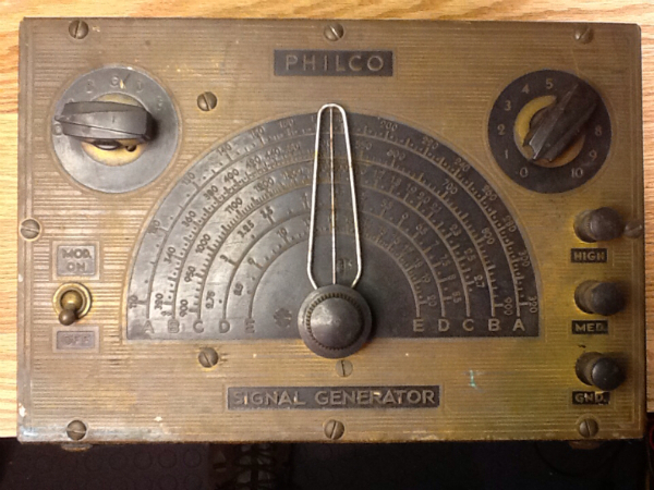

The Ketchup did about 80% of the work for me.  The remaining work on the face plate was all detailing - some black paint touch up, sanding out some scratches,  using copper cleaner on some of the tough spots, and then three coats of clear, semi-gloss lacquer.

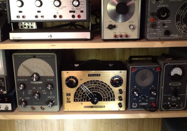

I hooked up a slew of Harbor Freight batteries needed to test the generator ( I now have multiple power supplies).  It put out a strong signal and I used it to align a Philco radio on my bench.  It's a keeper and has a prominent position on the bench...

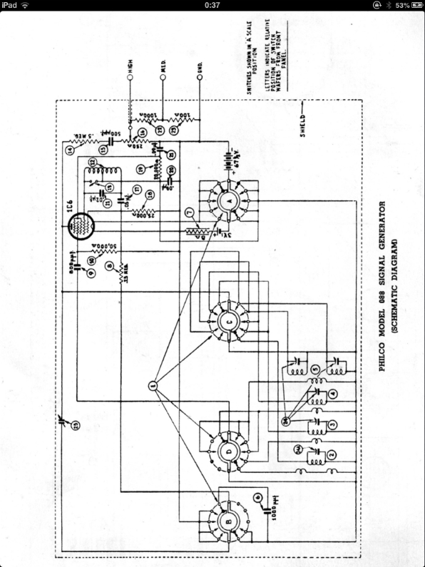

Here are the schematics - I hope there's enough resolution to read it....

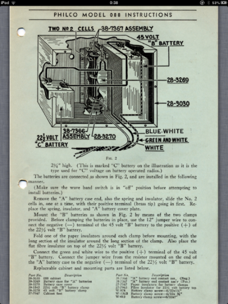

And the instructions on how to connect the batteries....

As for cleaning the brass:
Ketchup is neat.
The secret is the acid.
Same results are obtained using vinegar and salt.
Ketchup is a paste so it does not run, and provides nice cleaning action, and so will the vinegar/salt mix, which is mixed with flour and water, creating the paste that does not run.
So will do the lemon juice. One way is to take half of the lemon, dip it in salt and rub the surface of the brass object to be cleaned. Keep dipping the lemon in salt as needed. Use table salt, it is fine and won't scratch.
