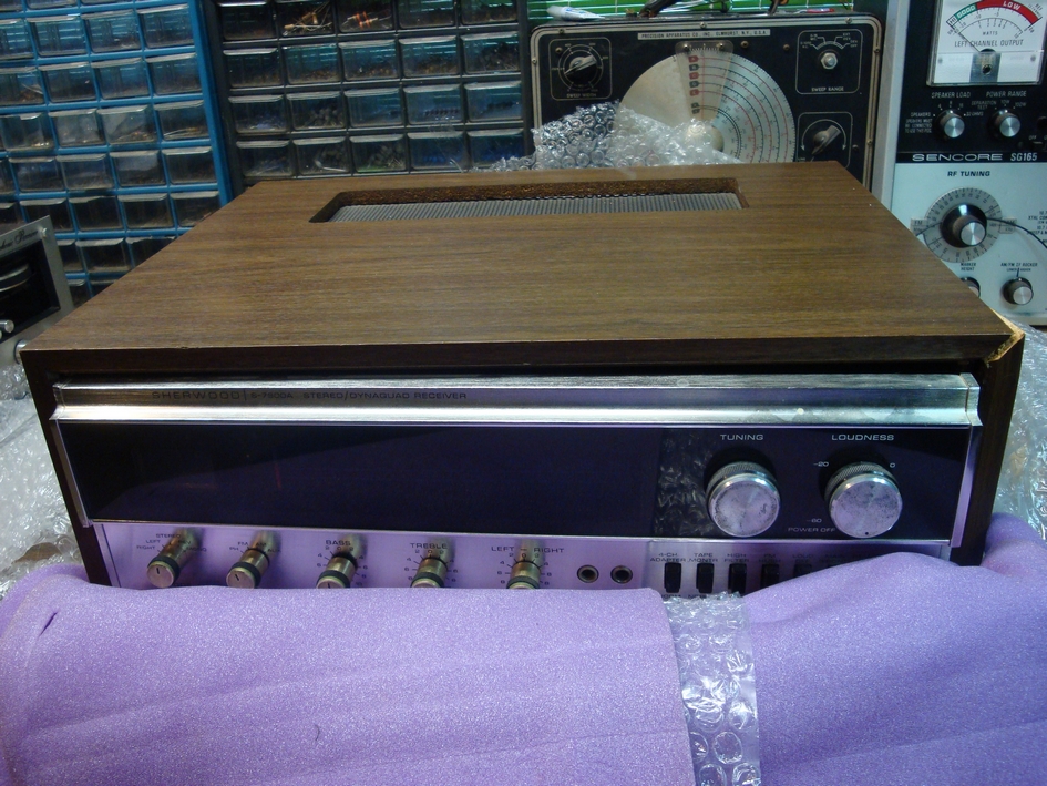

Unfortunately, USPS did what it does best to vintage electronics...
[Image: http://www.philcoradio.com/images/phorum/S7900A_001.jpg]
[Image: http://www.philcoradio.com/images/phorum/S7900A_002.jpg]
[Image: http://www.philcoradio.com/images/phorum/S7900A_003.jpg]

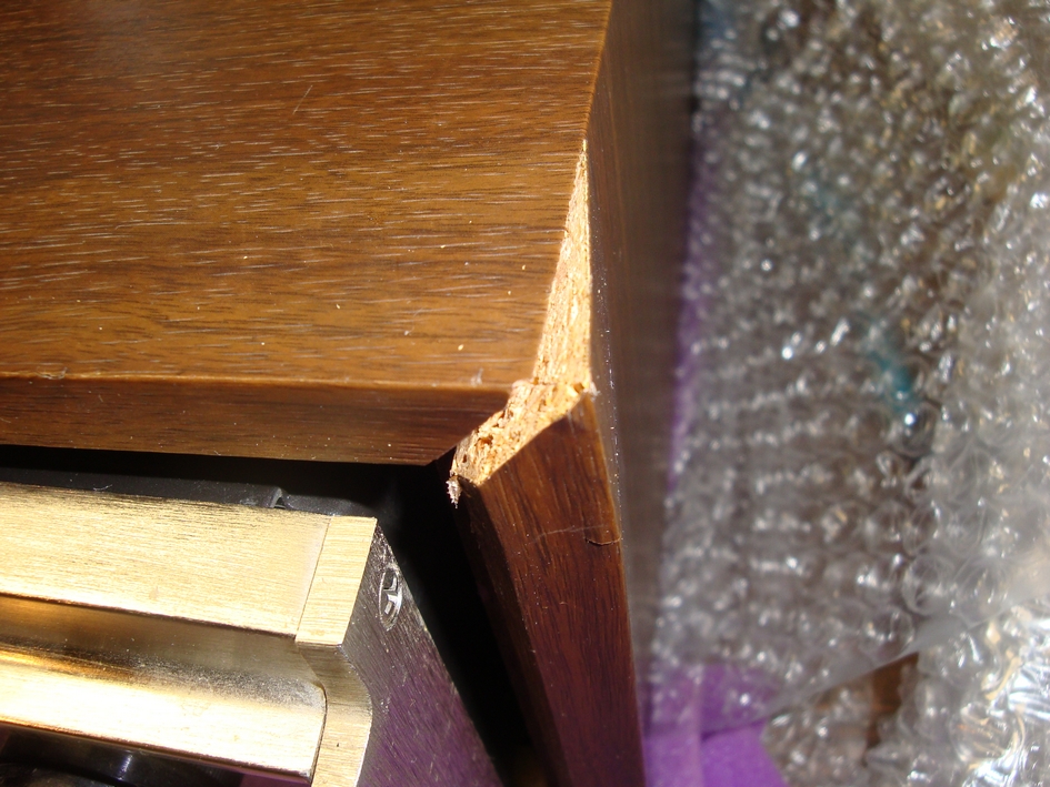

Not only did I have a damaged cabinet, but the mono-stereo mode switch and the function selector switch were both broken - they rotated like potentiometers with no "clicks".

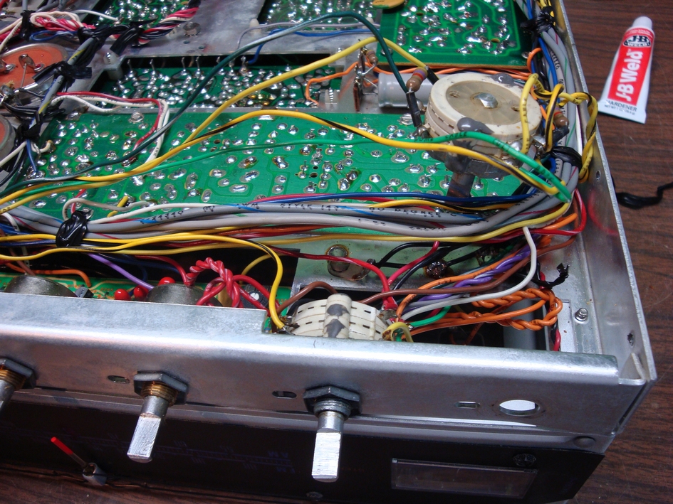

A few days ago, I pulled the chassis out of the cabinet and set it on the bench.
Removing top and bottom covers, I soon discovered a couple of serious problems...
[Image: http://www.philcoradio.com/images/phorum/S7900A_004.jpg]

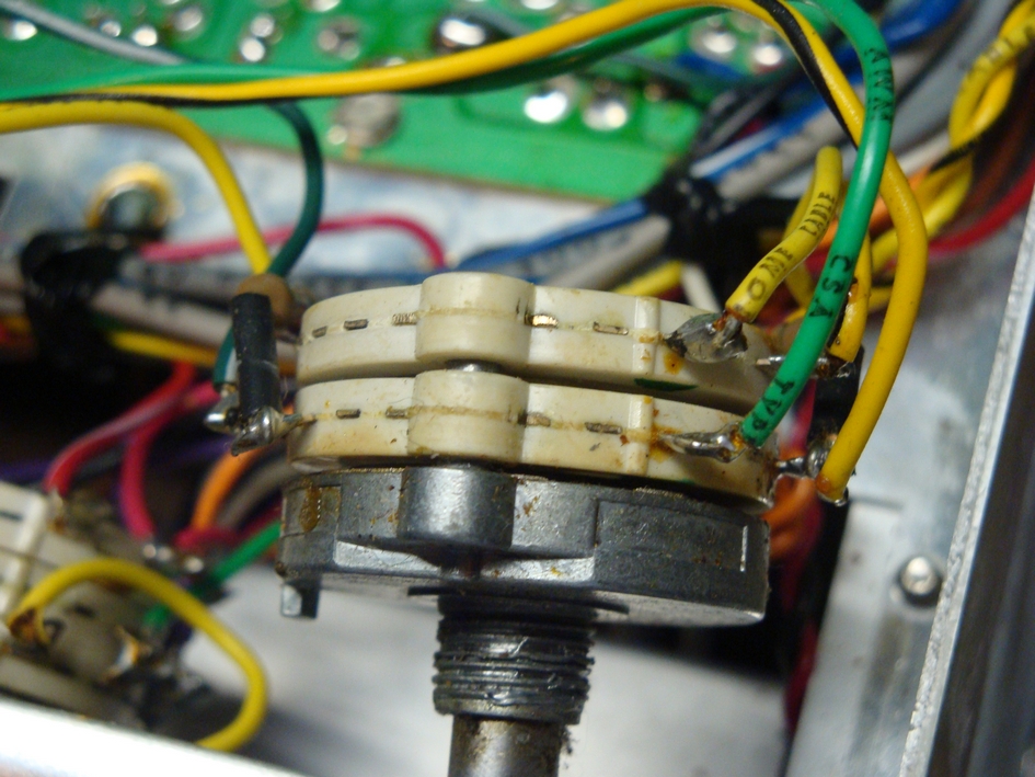

See the gaps between the switch wafers, and between the wafers and the front metal portion of the stereo-mono mode switch? There should be no gaps...all of these parts should be pressed together fairly tightly.

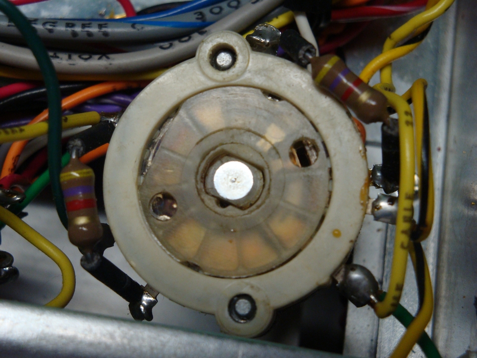

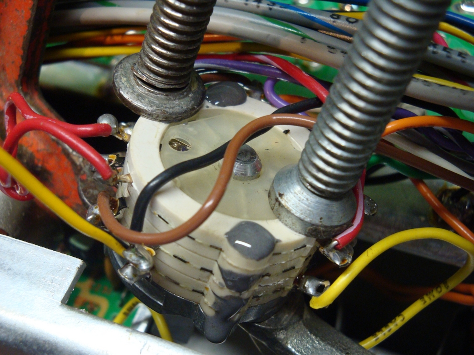

[Image: http://www.philcoradio.com/images/phorum/S7900A_005.jpg]
Looking at the back of the mode switch, see the two holes across from one another with what looks like pins inside? These holes were once the ends of rivets...those rivet ends were broken off from the damage, causing the switch wafers to come loose.
The function switch had identical damage.

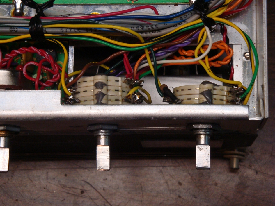

I tried pressing the mode switch together between my fingers and found that, lo and behold, when pressed together it clicked as it should!

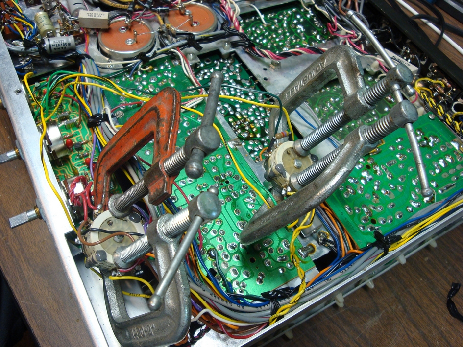

So...feeling that I had nothing to lose...I decided to use J-B Weld to glue the switches back together.
[Image: http://www.philcoradio.com/images/phorum/S7900A_006.jpg]
[Image: http://www.philcoradio.com/images/phorum/S7900A_007.jpg]
The next day...
[Image: http://www.philcoradio.com/images/phorum/S7900A_008.jpg]
Everything looked OK. Both switches "clicked" through their positions as they should.
So I reinstalled them.
[Image: http://www.philcoradio.com/images/phorum/S7900A_009.jpg]
I soon noticed that the metal that the mode switch was bolted to was also damaged (bent) - the mode switch was not lined up properly in relation to the function switch.
[Image: http://www.philcoradio.com/images/phorum/S7900A_010.jpg]
Removing the mode switch again, a few well-placed blows with a hammer and long flat-blade screwdriver removed enough of the warp in the metal that the mode switch lined up properly afterward.

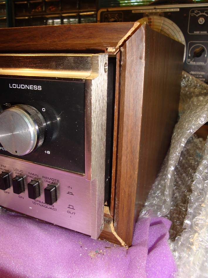

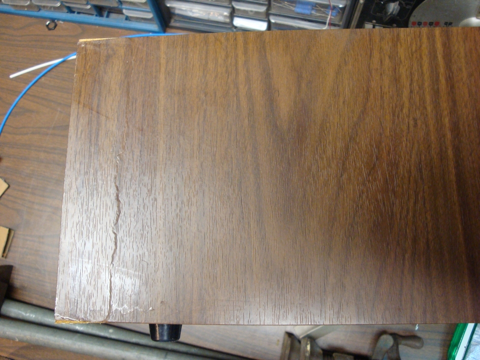

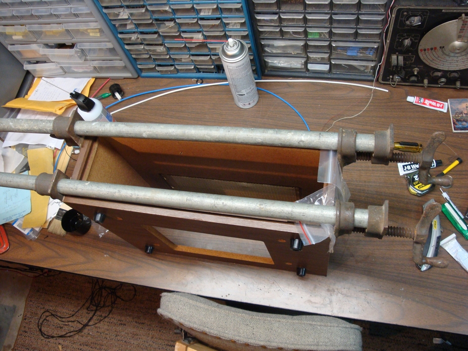

Remember that damaged cabinet?
This morning, I decided to try and glue it back together.
[Image: http://www.philcoradio.com/images/phorum/S7900A_011.jpg]
It had really sprung out of place on the right side, so I am not too optimistic about this...but again, I had nothing to lose by trying. I will leave it clamped for 24 hours and find out tomorrow whether or not the gluing was successful.

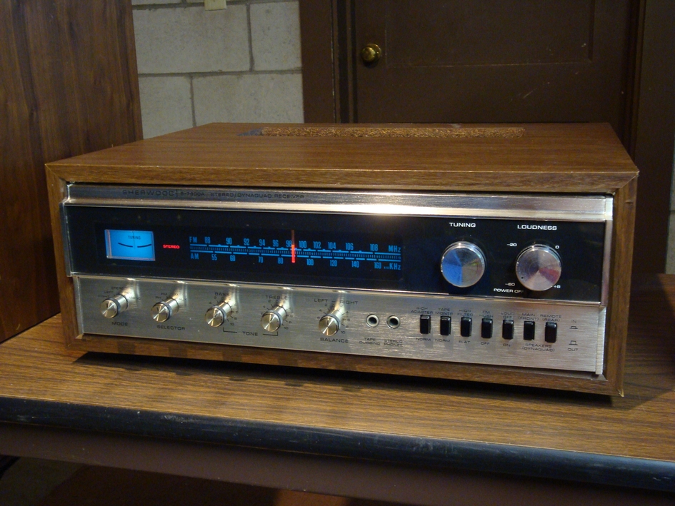

And here it is, playing the smooth sounds of Nat King Cole...
[Image: http://www.philcoradio.com/images/phorum/S7900A_012.jpg]
[Image: http://www.philcoradio.com/images/phorum/S7900A_013.jpg]
How did I get the knobs back on the mode and function switches without breaking them again?
Simple...before I reinstalled the top and bottom covers, I turned the receiver upside down and pushed in on the back of each switch while I pushed its knob back on.

Well, it looks like the cabinet gluing was more or less successful...
[Image: http://www.philcoradio.com/images/phorum/S7900A_014.jpg]
More or less?
[Image: http://www.philcoradio.com/images/phorum/S7900A_015.jpg]
You can see the fractured particleboard behind the vinyl covering.
Plus, I discovered that I pulled the clamps a bit too tight...and pulled the right side back a bit too much.
Oh well. It still looks better than it did when it arrived. Not perfect...but it will have to do.

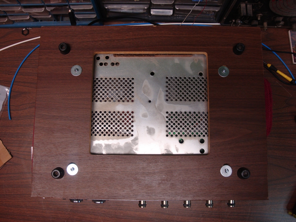

One reason the set was damaged in shipping is because the chassis was not fastened to the cabinet.
Today, I went to the hardware store. $1.03 later, I had four 8-32 x 1-1/4" screws and four large flat washers to correct that issue...
[Image: http://www.philcoradio.com/images/phorum/S7900A_016.jpg]

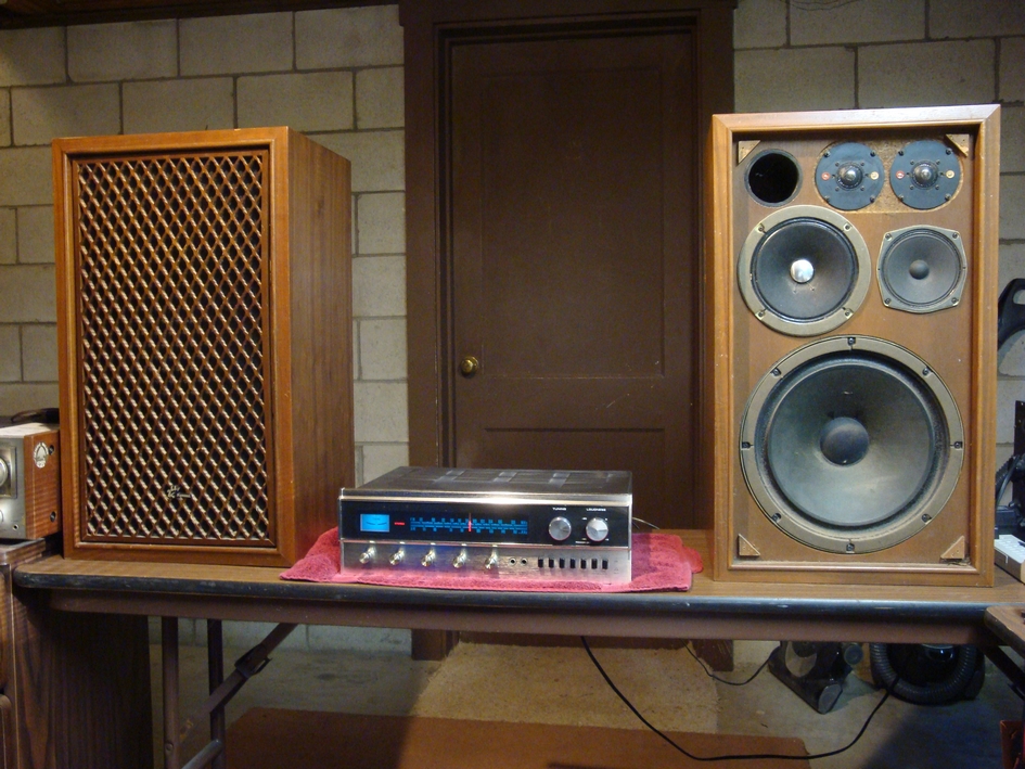

So here you are - how it looks now.
[Image: http://www.philcoradio.com/images/phorum/S7900A_017.jpg]
