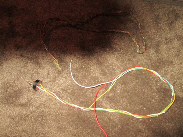

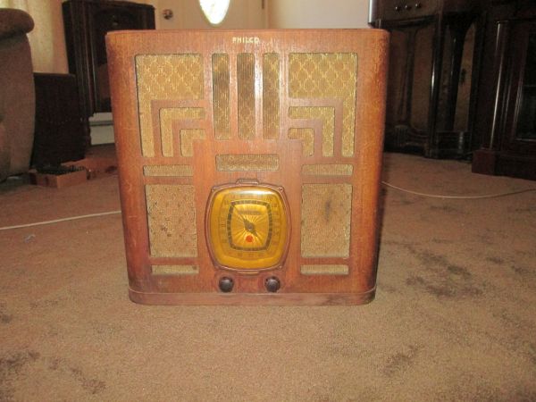

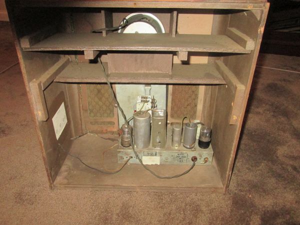

Got it a year or so ago. After doing a quick survey of it it seems to be in fair shape. Huge cabinet little chassis. Being a '39 model it has rubber wire but for the most part under the chassis it's OK. The battery cable is toast. It's seen some service over the years it has a replacement output transformer and an electrolytic cap.
Made up a new battery cable from some old computer p/s harnesses (switching supplies ARE good for something). Replaced 6 cap and one one meg resistor. Other checked within tolerance.
Haven't put power to it yet, don't know whether it would be easier to solder up a bunch of dry cell or dig up the ac supply I used on the old Crosley Trirdyn. It has an adjustable filament voltage.
Yep, small chassis for this size cabinet.
Do these even have electrolytics or they did without them? Not much to filter. But if used the caps had to live much longer than in AC radios, no ripple.
It's got a 3mfd electrolytic cap(29) right off the B Battery. Was looking at the specs and was surprised to read that it only pulls down 6ma from the HV.
6mA.....any piece of crap el cheapo electrolytic will do. And, what's good, any capacitance. You could use 3, or 10, or even 100uF with no ill effects.
So got up and thought I'd put some battery juice on it and see what happens. Well nothing! Battery power was up to snuff but no audio. Did some quick troubleshooting to find that I had cut the ground return for the output tube's filament. Fixed that up and it sprang to life.
But one other issue cropped up, I don't I can turn it off. No click. Most farm sets have a dual switch on the back of the volume control. One set of contacts breaks the B battery connection and the other the A battery connection. This way there can be no current drawn when the set is off. I've have had sets from the'20s which just break the A battery supply the thinking is that if there is no filament voltage (A battery) the tubes won't draw any current. This is true but God help your expensive B batteries if you have a leaking plate bypass cap. Doesn't take much over a week or two to drain them down to unusable. But I digress. Disconnect all of it's tentacles 3 on the vc +1 for the loudness tap and 4 on the switch and pop it out. The **** works fine! Clean it up put it back in. So now I'm thinking that the off/on flag is what was causing the problem. I was a little stiff. Cleaned it and a bit of oil and we're back in business.
Still have to mate it with the cabinet/spkr.

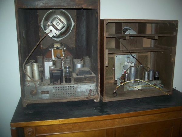

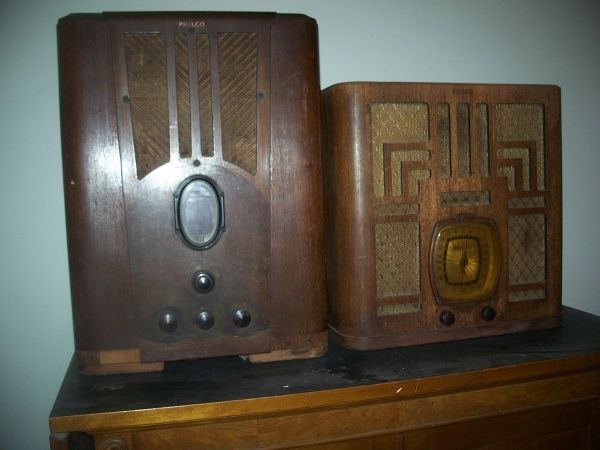

Just to give you a little reference in terms of size here's it next to Philco's best (and biggest) table set for '36 the 116B. Hard to tell them apart!!!!
Considering it has a whopping 110 mw output it sound quite loud. Maybe not as loud as ac/dc set but pretty close. Average AC/DC set uses about 30w (unless your Kirk he gets those old buzzard ones with the 300ma toobs) This thing uses 1.5vdc @ 250ma and 90vdc @6ma that isn't much.
