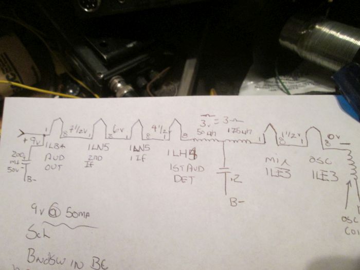

You got me there. General on a schematic the heater pin are in the proper place. Most of the it doesn't matter cause one side is at 6.3vac and the other is a chassis ground. But when you have a transformerless set (ac/dc) the heaters are in series then it can be important to know which pin is which.
[Image: http://www.philcoradio.com/phorum/attach...?aid=10253]
This  was a problem child I was working on a few months ago. The tubes at each end the the volt was too high and in the middle it was too low. The 1LN5 had only .5v and was inoperative, the 1LE3 and !LB4 had too much @ 1.75v. As you'll notice 1 pin is on the left and 8 is on the right as it should be. This makes it easier to troubleshoot.
Schematic are drawn to have the least of wires crossing to avoid confusion ( unless it's a Crosley). This doesn't necessarily correspond actual arrangement of the pin placement on the tube base. Notice that your 610 doesn't show any caps on the tube that have them.
I think I answered your question.
