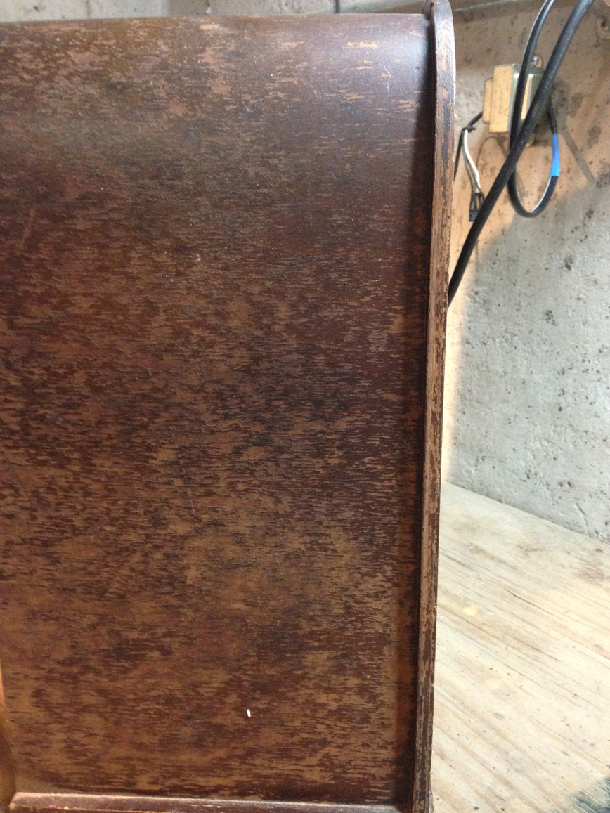

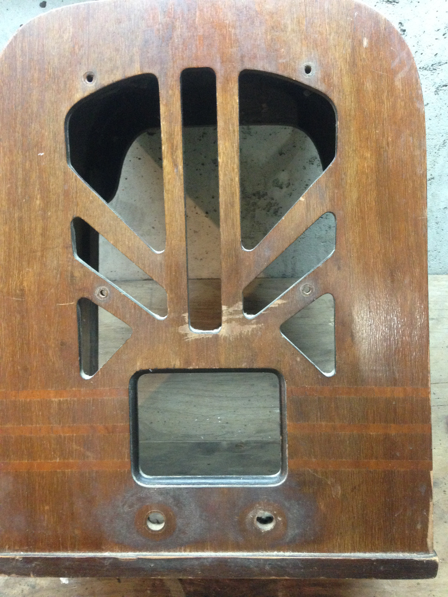

Does anyone happen to know what the color combo should be for this 38-93 Tombstone?
The base looks to be quite a bit darker than the rest but it’s hard to tell for sure.  And the body appears to be darker than the front but not as dark as the base. And then the stripes are lighter than everything.
Any information or suggestions will be greatly appreciated.

  Hi. It looks like you could use Mohawk medium walnut on the sides and front and Mohawk extra dark on the bottom trim. Here is a picture. Of course pictures off of web sites don't mean it is the correct color. If not, someone that owns one might know the exact color combo. Good luck.
http://radioattic.com/item.htm?radio=1480011

Thanks a lot guys, that's exactly what I was looking for.
