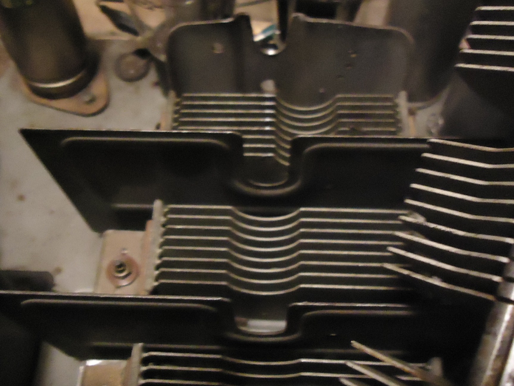

10-17-2016, 07:34 PM
(10-16-2016, 03:06 PM)Radioroslyn Wrote: Check ur pm box.
Terry and all  o you see what I see on the last gang ?Wow is that bad to not notice this !!! The person that sold me this should have not let me work on it ! I can not believe that I did this . Or that I now admit it ! But everything is now working properly even with the shield in place. I am happy that all worked out here . Thanks to everyone for keeping me going with good advice . I could not see this easily when the gang was together . I should have noticed before it I did it .Or looked closer when i noticed the shaft being worn .Well this was
a first for me and i hope a last . Thanks to all !!!
Bill
