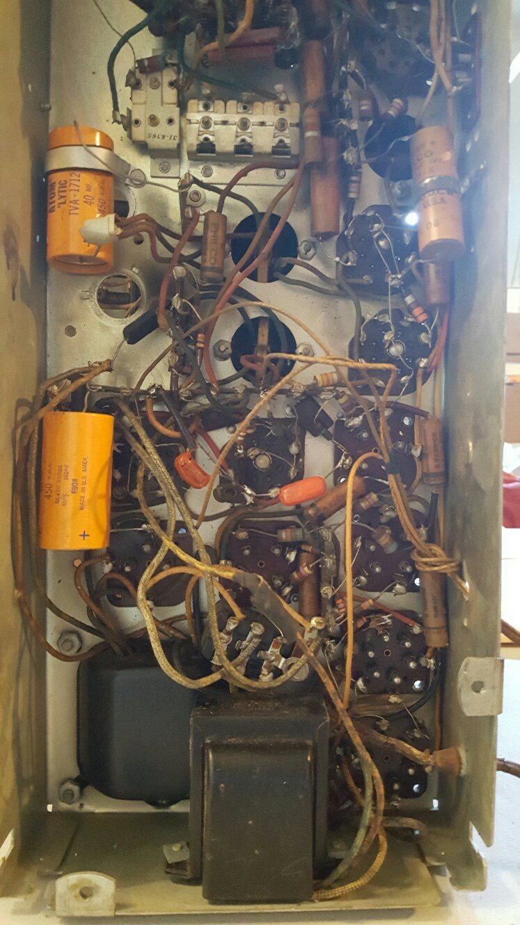

Thank you guys for your direction...
I bought this from the original owner and do not believe that this has ever been worked on.
This is now the true "can of worms" I was afraid of...

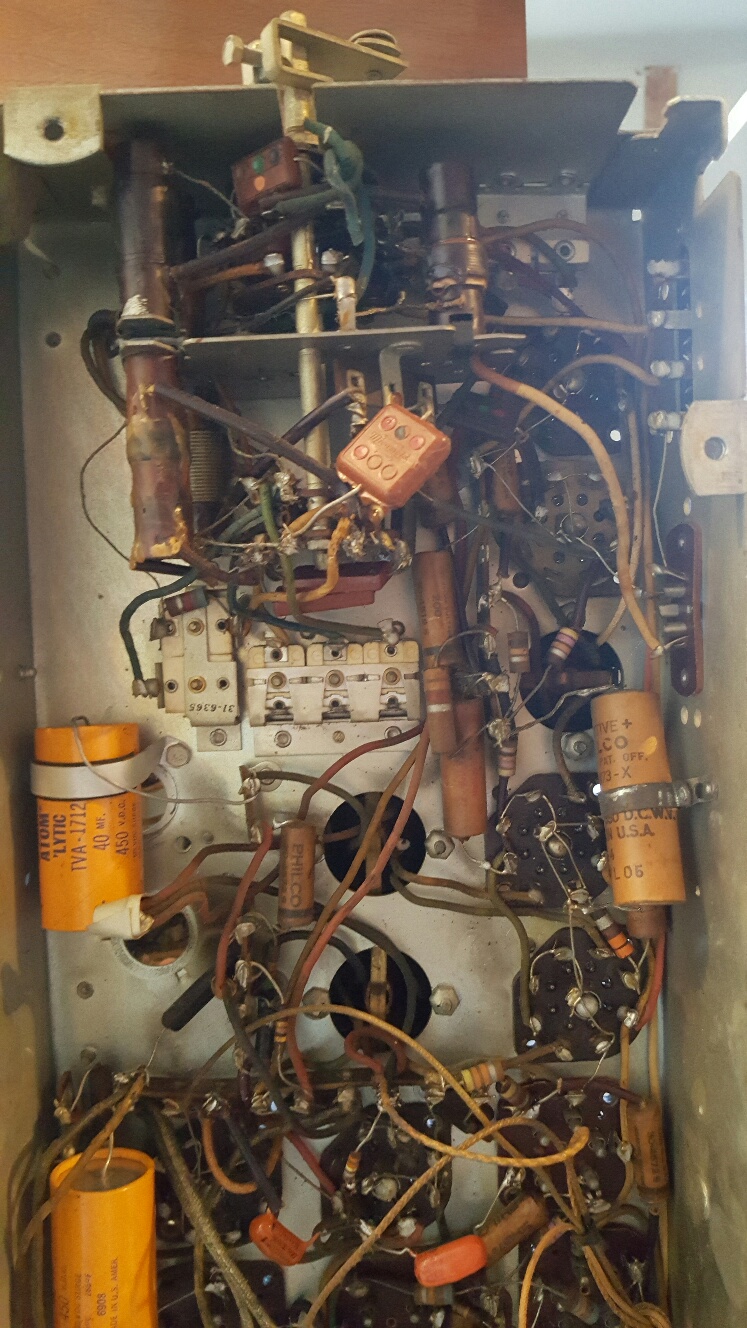

Please take a look and let me know your thoughts.
Thanks,
Rick

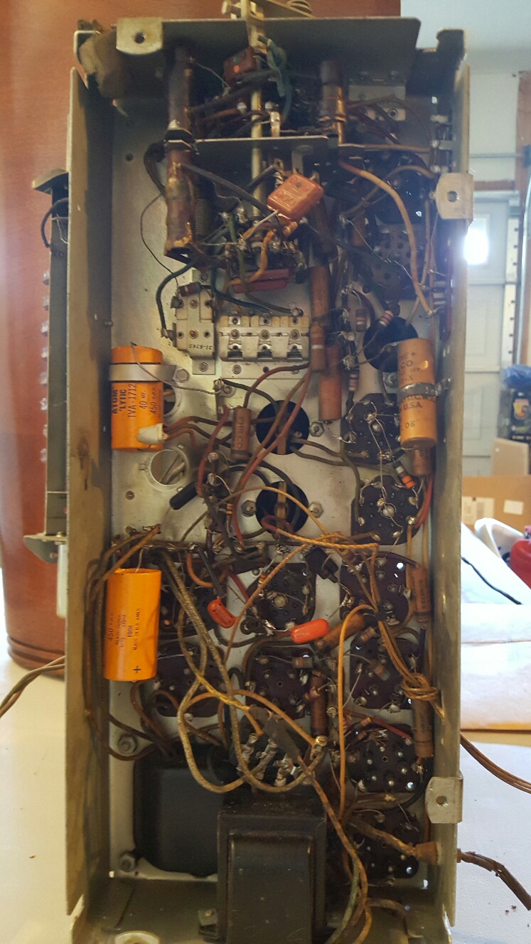

lost part of pic on last set
Yes your right it does need a cord! The two orange thingies that say  Atom Lytic are replacements from the 60's or 70's  The littler orange thingies are replacements too from abt the same time. Would probably replace the Atom Lytics and the rest of the wax/paper caps.
The name ofyour town looks familiar we may have a member out your way that could lend a hand. Maybe one of the moderators could have a look.
Oh the other thing to keep an eye out for is the rubber coating on the wire disintegration generally 1939-42 set have this issue. I've got your sets sister she's curvy.   http://philcoradio.com/gallery2/1941a/#Model_41-300X
It too is suppose to be playing but I want to have a look before I use it.
Hi Rick. Welcome. It has had some work done on it. The two large orange looking electrolytic caps on left and the two orange smaller caps in center are newer. Over all it doesn't look too bad except you do have some rubber covered wire that is rotted. The other older paper caps should be replaced also.

Last, some words of encouragement--the underside of that set looks relatively unmolested. Go at a comfortable pace when replacing components, and you should be fine. I usually unhooked a minimum of components so I didn't lose my place, and I went ahead and replaced pretty much all of the capacitors and resistors under the hood of mine (I had to unsolder 90% of them anyway to get to another component), but others have done differently, so your mileage may vary.
