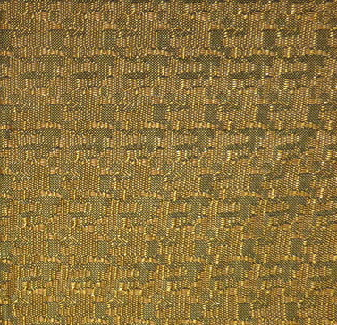

I looked a round a bit more and found this one that seems somewhat closer in texture, but not so much in color (more silver than gold toned). I've never done it, but maybe it could be dyed? I know some people have even used a really light coat of spray paint...
http://www.ebay.com/itm/ANTIQUE-RADIO-GR...1737814649
It's hard to say though - I've been disappointed on more than one occasion when trying to buy grille cloth using just photos of the fabric in isolation (rather than in a radio).

On first glance, Nathan, the first photo in your post just above (post #10) showing the cloth from the auction site looks like it could be a decent replacement. But I would be questioning two things: the size of the pattern, and the thickness of the cloth? Some of that upholstery fabric is pretty thick and will muffle the sound. Plus the proble of trying to make it more of a gold color.
