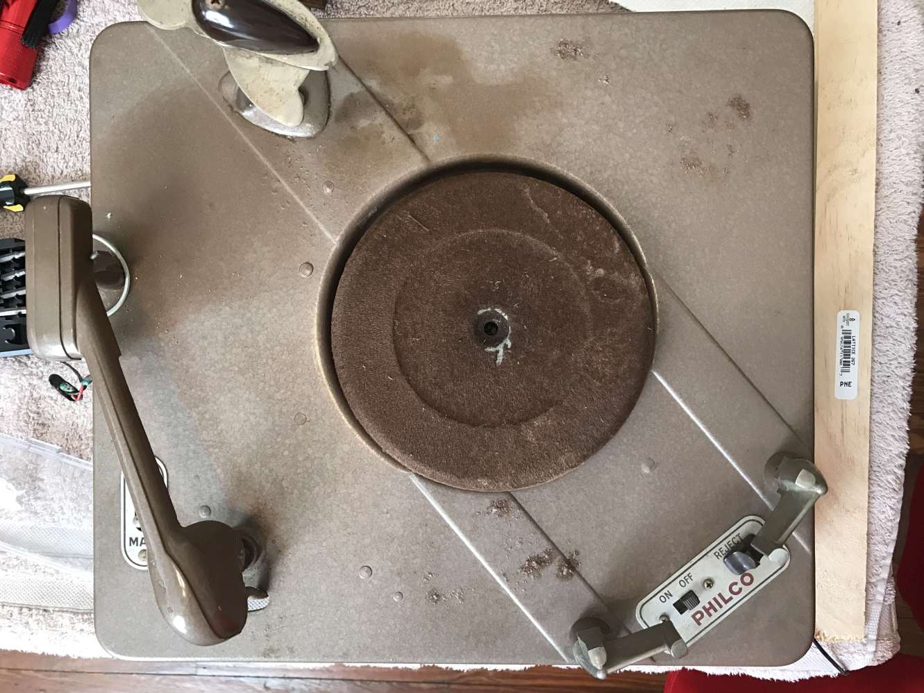

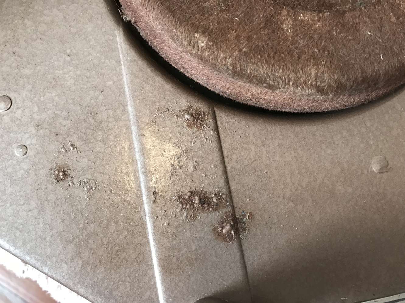

I recently got a 46-1203 and the turntable surface has some bad rust 'bubbles' that have emerged from the paint. The fuzz on the turntable itself has also gotten into quite bad shape.
Does anyone have suggestions on how to repair of spot-treat this? I used some hammered gold rust-oleum on my 40-185's escutcheon and it looks great. I'm sure some hammered silver would look nice on this one, but I wanted to see what experiences other people have had before I execute. Any suggestions?
Also, how can I re-do the fuzz??

Hi Frazier and welcome.
The fuzz call flocking doesn't look too bad. A lot of times it's gone completely. Years ago it was common to cut out apiece of felt and place it between the platen and record. Kirk (oldrestorer) would have some sage advise on flocking and paint. He likes old record players.
GL
Welcome to the forum, the corrosion under the paint will have to be removed by breaking the bubbles and sanding the area. Then you will need to put on some rust killer. If the damage has pitted the metal you may have to fill the defects with Bondo and spot repair. The only other way is to completely strip and repaint the turntable. Flocking is very easy but the first purchased will run you about $30 for the supplies. As Terry said, the platten looks pretty good to me. Flockit.com is good for the supplies. I do not use their glue since it is expensive. I use spray paint in a similar color to the flocking. Just spray paint the platten and apply the new flocking with the squeeze bottle they sell. You will have to scrape the old flocking off before applying any new. I usually apply two coats of flocking.

What should I use for the spot repair after I have stopped the rust? Rust-oleum hammered Copper, or is there a paint-on solution?
Also, if I do decide to strip it, how should the process go? Regular paint stripper, then the rust-oleum?
Last, which flocking would you suggest? Suede-Tex or soft-flock?

Questions and answers:
Yes to Rust-oleum hammered (SIlver) not copper but that is mostly for a full restoration. As for a brush on you would just have to try to color match the original with oil based paints.
You would use some good paint stripper and strip everything. Then sand lightly and wash with mineral spirits. Then prime wil metal primer. You could use the rust killer primer to save one step. They have it at Home depot in a spray. Then light coats of the finish coats.

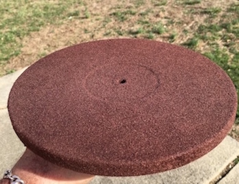

Suede tex is my favorite.
Remember that your Platten has aged and the color of the flocking has faded. You should use brown flocking but it will be a little brighter.
 Here is a pic of the brown flocking.
