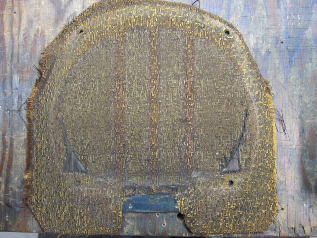

Well the chassis is now working so now I can work on the cabinet issues. There is some loose veneer that needs re-gluing, but I'm not going to redo the entire cabinet at this time, just want to enjoy it through the holidays. One thing that I do need to replace is the grill cloth. It is frayed through in several places. I cant seem to find a match for this pattern. Its kind of a two tone copper color with a little black mixed in. Definitely original to the radio. After I locate a replacement, what is the best way to attach it to the cardboard backing?

The closest I can find at Radio Daze (or anyplace for that matter) is GROC2. The pattern is correct but mine is more of a copper or bronze color.

I have used toner and/or dye to tint this pattern and it has worked well. The spray toner (for wood) better than the dye.
(11-24-2016, 05:07 PM)Mike L Wrote:  The closest I can find at Radio Daze (or anyplace for that matter) is GROC2. The pattern is correct but mine is more of a copper or bronze color.
I have searched for that design also with the copper and bronze threads mixed in and did not find any. Todays reproduction cloth from Kenny Richmond is way way to gold and looks horrible. I would go with the cloth from RD that is for the philco 90.

Russ, what color toner did/do you use to...tone down (pardon the pun) your cloth?
Well ,I used that cloth in the Strat and I made it more red with one of the "Classic" toners, probably dark walnut. It is not hard to do. Just stand back at least a couple of feet & don't overdo it.
