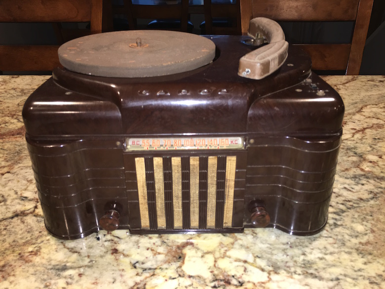

I thought it looked like a turntable radio.

 I just looked up the picture... IT IS a Garod 5AP1Y! I do have the phono cabinet..
I was thinking if a totally different radio....
Dont short it out since I have the male plugs...
