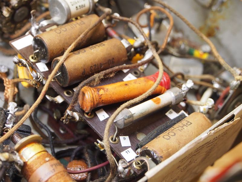

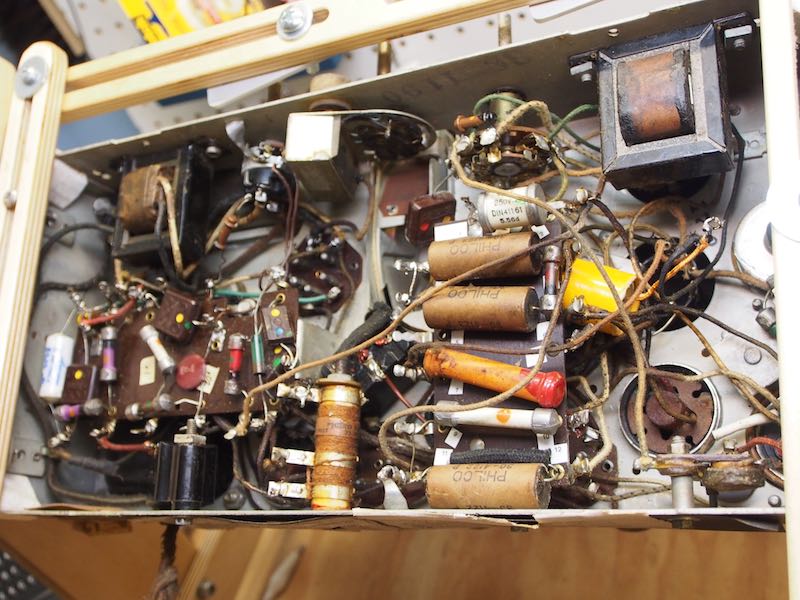

I'm wondering whether these Philco paper caps look like they've already been restuffed?  I expect the ends to be yellow and waxy-dull looking, but instead they are black and hard-shiny looking.  The caps don't seem to be coated in wax.

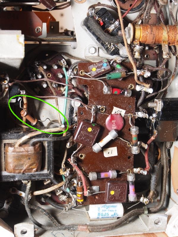

Also, in this last picture, there's a 10K resistor with one end hanging loose (circled in green).  Does anyone recognize which resistor it is on the schematic?  My schematic (NostalgiaAir) is pretty lousy.  And small.

No they do not look like restuffed to me. let's wait for other opinions.
Agree with Mike, the paper caps do not look as if they have ever been restuffed.
Lots of older Philco paper caps used some sort of hard substance on the ends. It is very difficult to unpot these, but not impossible. Heat will soften the end cap material...but caution must be used so as not to overcook the cap and scorch it (been there, done that, have scorched caps to show for it).
Looking at the pictures I would say the caps were not restuffed.  You can also examine where they are soldered to see if it is new or tarnished.
Attached are some schematic pdfs, I downloaded from the Radio Museum that should help you identify where that resistor goes.
Looking at the schematics and your pictures, I think it is item (resistor) #53.
Bill
Loose wire by Yellow Capacitor ???? Picture Number 2
Alright, thanks guys. Not that familiar with Philco components. I was comparing to a 28C I picked up recently for parts, and all the 28C's caps look the way I expected (coated with yellow wax). So these made me wonder.
All three caps are lead down through vias in the circuit board, so I guess I'm going to have to unwire the board and get a look underneath, to find out if they're original or have been resoldered. Many of the contacts along the edge of the board have clearly been resoldered.
I think the resistor may be part #53. It seems to be heading in the direction of the center tap on the volume control, but it doesn't quite reach. ???
I use the old wax so mine do look like that when done... The tell is the thin new wires coming out..

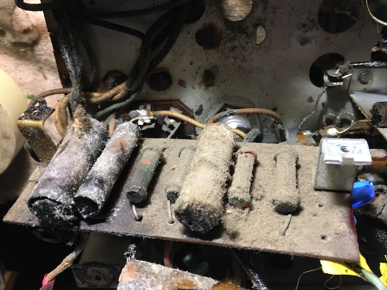

I literally just finished flipping a resistor board..
 What a PITB!
 24 connections removed just to flip the board...
UGh!
