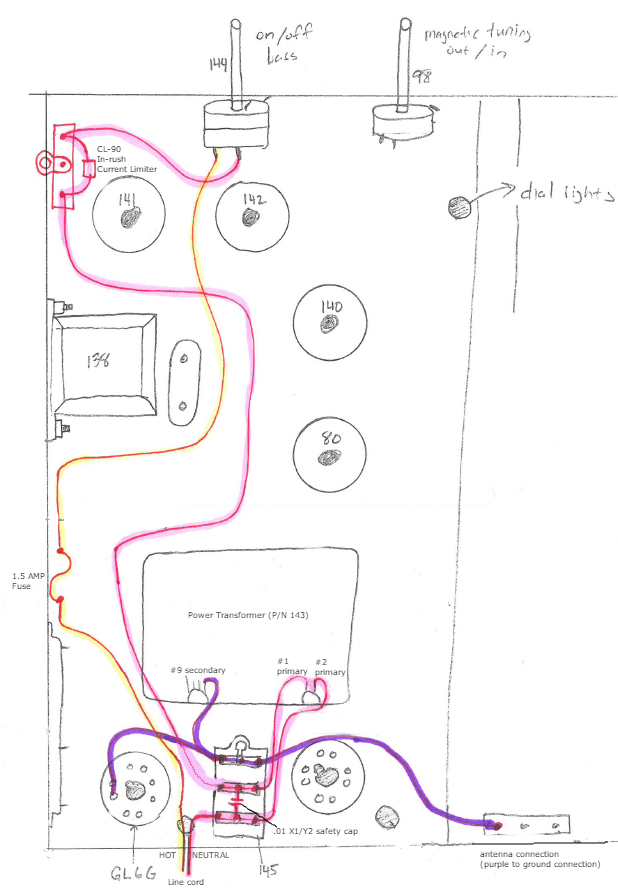

1) install a polarized plug with hot leg connected to a fuse before the power switch.
2) install a fuse on the hot leg of the power cord before the power switch.  The radio draws 165 watts at 115 VAC (as listed on the blue label in the cabinet) so its amperage is 1.4.  I will plan to use a 1.5 amp slow-blow fuse to keep it as close to the draw as possible.
3) Replace the 2 .015 caps in the bakelite block (part 145) that were originally on each side of the line to chassis ground with 1 .01 uf X1/Y2 safety cap - this would be after the switch across the line. I will continue to utilize the existing bakelite block as a tie-point for neutral side of the AC line cord and the primaries of the power transformer.
4) install a CL-90 in-rush current limiter after the power switch by adding a new 3 point terminal strip in an un-used existing hole on the chassis.
Below is a rough diagram on how I plan to do it. The yellow highlight is the hot lead of the AC line and the pink is the neutral side. The purple shows ground connections.
Are there any issues with my plan? Did I leave anything out?  Thanks for your thoughts! -- Andy

Don't see any diagram so it may not have posted. Your plan of restoration seems reasonable.
Are you planning on restuffing the original electrolytic cans? If so, it might be a good idea to use metallized polypropylene 630V film caps for the two 8 uF caps connected to the rectifier filament. These caps are subjected to very high ripple current, and modern miniature electrolytic 8 uF caps are not designed for such service. The film caps are available here:
https://www.tubesandmore.com/products/ca...ylene-fast

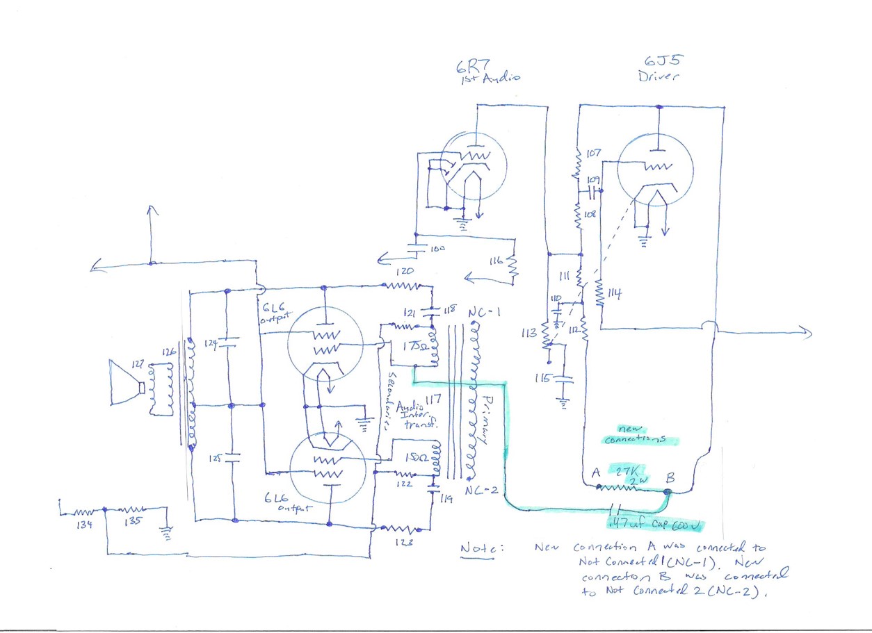

Your drawing is pretty close, but the .47 coupling cap connects to the wrong point. It should go to the point marked B instead.
The 27K connects to the same places as the primary did, and the coupling cap goes to the plate side.

I have an open primary on my audio interstage transformer - Philco part # 32-7865N.  The secondaries test fine. I am checking with Heybour to see what the cost would be to have one recreated as Gary does not have one on hand at PTOP. while I am waiting on heybour, I thought I would take a shot at Ron's modification B to the audio interstage transformer when the primary is bad. Below is my sketch with Mondial's corrections noted above (I deleted the original picture he references since it was not accurate):
I have also been talking with Gary at PTOP. I mentioned I was planning to do mod B and he didn't think that was the best route. Here is what he had to say:
"Not sure if that is the best way as it is a single plate to push-pull grid DRIVER circuit and not just a plain interstage audio coupling circuit." Gary suggests a DRIVER type transformer and says the spec's are not too critical on type if I am just trying to get it working.  I would like it to work the best it can given i don't have a spare audio interstage transformer (the primary was open on the parts set audio inter. transformer I have too).
What do you guys thinks?  Thanks for your help  - it is really appreciated! -- Andy

Yes that looks correct now.
If you want to do it right, you really need to have a new transformer made, or find a good one from another chassis. It is not your usual driver transformer. Note that it has two separate secondaries with each driving its own 6L6.
 The reason for this is that negative feedback is applied from the opposite 6L6 plate to the bottom of each secondary through caps 115 and 119. Without separate isolated secondaries you cannot accomplish this, and the output stage will not work as designed, with higher distortion and reduced speaker damping.
Until you find the proper transformer, the resistor mod should work, but you will not get full output. You can also try replacing the resistor with a low current  audio choke of 20 Henries or more. This will give more drive and greater power output.

Thanks Mondial. I haven't heard from Heybour yet, but I hope they are able to recreate one for a reasonable cost. I was really hoping the parts set would have a good interstage transformer but same issue.

If you have another parts chassis, there is a 20 H low current choke present in the power supply. It is marked 138 on the schematic.
If it is good, it will make a great replacement for the 27K mod resistor. Just connect it the same way as the resistor, between points A and B. It is not shown on your schematic, but point A should also connect to the B+ supply from cap 80B.

Mondial - thanks for the idea about using the choke. I have added the connection to the elctro cap on 80B. I have good news from Heybour whom I am checked with to recreate my audio interstage driver transformer (part number is 32-7865) in my 38-116, Code 121 which has an open primary. On the code 121 it is part # 117 and on the code 125 it is # 102 on the parts listing - so it works in codes 121 or 125.
Mondial has been very helpful as I developed a plan B if I could not find a transformer from a junker or one from Heybour. After talking with Heybour they will be able to recreate the transformer. They offer a price break for the additional transformers if I order more than one. So - do any of you need a audio interstage driver transformer like mine? If I order just the one I need, it is $50. If I want two or three the cost is $40 for the additional ones. So, if you need one, I can order it and you can pay me back the $40 - saving you $10 off the normal cost. Let me know ASAP as I will be placing order order tmw, Thursday 4/6.
