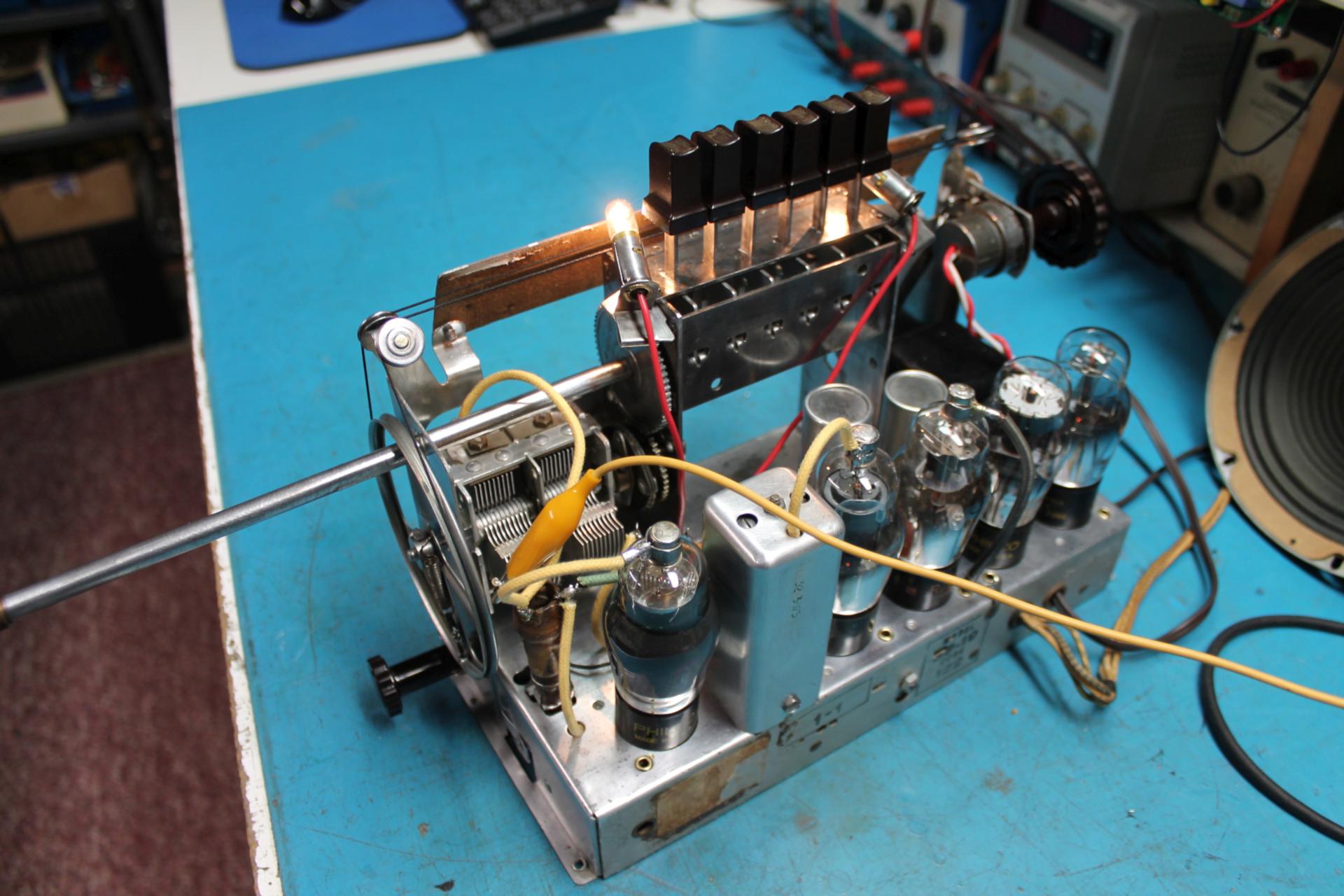

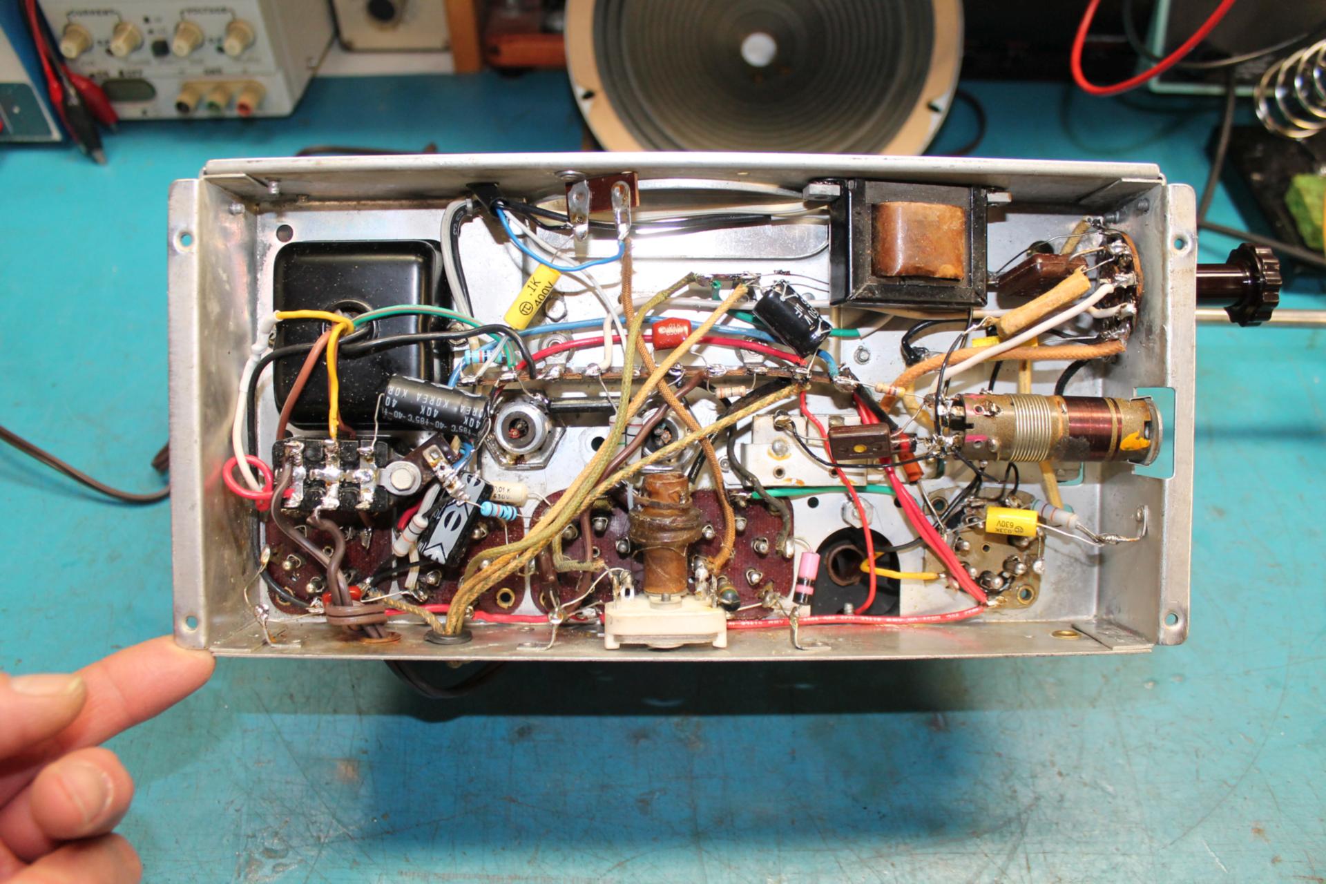

Hi guys. I just did a complete electrical restoration on the 1939 Philco console and it has hash noise across the broadcast band. It's present on the shortwave band, but not as prevalent and it varies with the volume pot. It's not smd with this if can type. This was a bare chassis up restoration and I did a triple check against the schematic on the wiring and component values and all look good. All caps, except micas have been replaced, along with most of the resistors. I also performed an alignment procedure more than once. So now I'm wondering if there may be some critical wiring paths to be aware of. Or maybe a faulty tube? A leaky new cap? I have test equipment, including a scope, but I'm not sure how to trace and isolate this problem.
Any help would be appreciated.

No. It's an internal problem. I installed X1Y2 safety caps on the line in and ran this radio off an isolation transformer. I've done scores of restorations and have isolated all the area noise sources. The hardest one to track down was a dimmer on a lamp two floors up and on the other side of the house!

I't similar to the sound you get on FM when there's no signal present. Called hash in the old days. It's there, even when placed near to my AMT3000 xmitter.

Ok the short answer is to connect a clip lead to the chassis. Connect the other end to pin4 of the 41 tube. With the set on it should go  quite. If not your issue is in the audio output stage. Next take your clip lead and connect it to the grid cap of the 75 tube. Same as before should go quite if not issue is in the 1st audio/det stage. Do the same w/the grid cap on the IF amp, Mixer and finally the ant lead. This will show which stage is noisy.
Turn the set on and to a station and then turn it off. From the monument you turn it off there is a brief monument that it's still playing. Still hear the noise?? If so it coming from the ac line.
