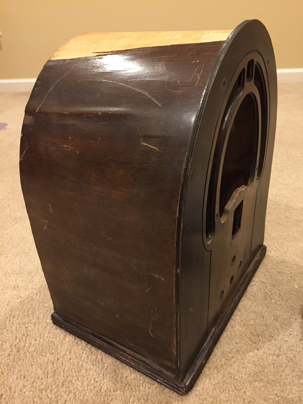

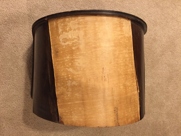

Hi Folks. I started working on my first Philco, a model 89 code 123, and as you can see the veneer on the top is totally gone and the sides are buckled and separating. What's the best way to remove the veneer completely (I'm guessing that's the best option) and where can I find a good replacement. Many of the veneers that I have seen are almost paper thin while the original looks to be about 1/32" thick. Also I'm not sure about the wood type. Walnut maybe?

There are two ways that often work to remove old veneer. One is heat as from a heat gun or hair dryer. The other is moisture, ie : lay a damp cloth over the section you wish to remove and let it rest there until the veneer is loosene enough to remove. Often a combination of the two works best. Don't let moisture get into any other glue joints such as between the front panel and arch woods.

I think your assessment is correct, the veneer needs to be removed completely. It is very difficult to veneer a curved surface. If using wood glue, the veneer needs to be clamped, something almost impossible to do with the curve. One option would be to use contact cement. The problem would be trying to get the veneer all the way into the groove in the front panel before it sticks to the wood. Another way is to use wood glue and activate it with a hot iron. The best solution would be to replace the wrap-around entirely. If you want to go that route, I can help. I will be sending a PM.

I think that the veneer over the arch is like that on a model 81, it looks like some sort of tight grained, blond, hardwood like maple, poplar, or beech. Knowing Philco that's probably what they used since they intended to slap shaded lacquer over top of it, the fact that it's also a thick veneer would also indicate this. The model 89 was a step up from a model 60, which was a step up from a model 80/81, so they used the fancy veneer on the front panel and used the cheap stuff over the arch, whereas the 80/81s used cheap veneer on everything.

Arran is correct, Philco used a cheep veneer on the wrap-around, toned dark to look like Walnut. It fooled a lot of people LOL.

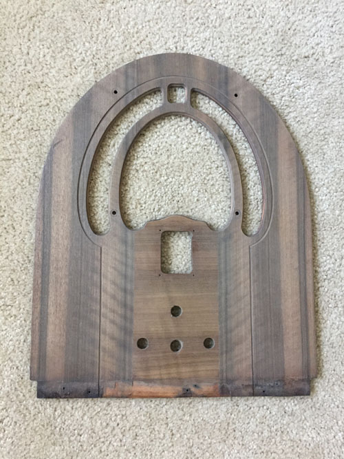

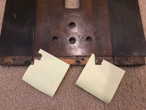

Well, after weighing my options and getting input from the forum I decided to order a new arch from Steve. I really wanted to keep as much of the old cabinet as possible but I don't have the tools (or the skills) to rebuild the arch properly. I was able to remove the front panel but the veneer under the trim is a little beat up. I think the trim will cover most of this but I have some lifted veneer that I'm thinking needs to be glued down before I remove the lacquer. Any suggestions on what glue and method is best for addressing these two spots?

Dave, try putting a few drops of wood glue on a business card and slip it under the loose veneer and work it around a little. Use C-clamps and wood blocks on the front and back to clamp. Laminated counter top material makes good clamping blocks. The laminate will not become stuck to your veneer or you can use wax paper under your blocks.

One trick I figured out years ago is to wrap the blocks in either saran wrap or a plastic bag, glue doesn't stick to plastic bags nor saran wrap. Glue residue comes off with warm water and a brush. I was going to suggest a hypodermic needle and syringe to inject the glue, but not everybody knows where to get one, and it probably isn't necessary since the section that needs to be glued isn't that deep.

Got a little surprise today when I tried to dry fit the arch. The slot in the original front panel is 1/8" but the new arch is about 5/32". Luckily I have the small Dremel router attachment and I was able to widen it (slowly & carefully) with a 1/8" bit. Ready now for clear coat and grain filler. Steve, you mentioned applying clear lacquer first then the grain filler. Will the filler adhere well to the clear coat. That was my only concern.
