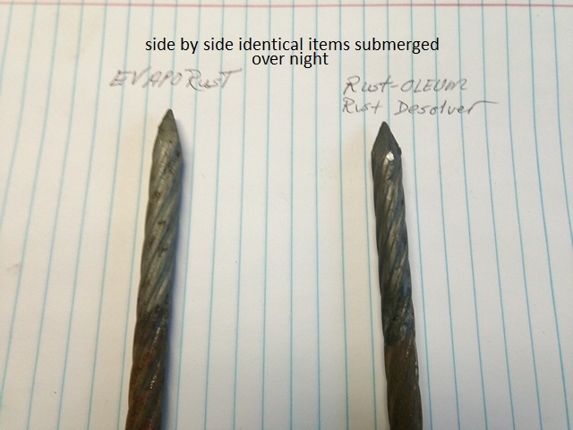

rustolium "rust Disolver",, i tested this along side of another brand.
this **does not** require you to keep the item submerged like another brand called Rust remover.
I did a thread on Foxthunderbirdcougar forums about this and many other good products.
it does more than just remove rust, it eats away the stuff that doesnt belong.

link here, to see pics though you set up your user name
http://www.foxtbirdcougarforums.com/show...t-Disolver
pictures of the same thing over at that link for you to view.
evaporust did not do well for dipping only.
