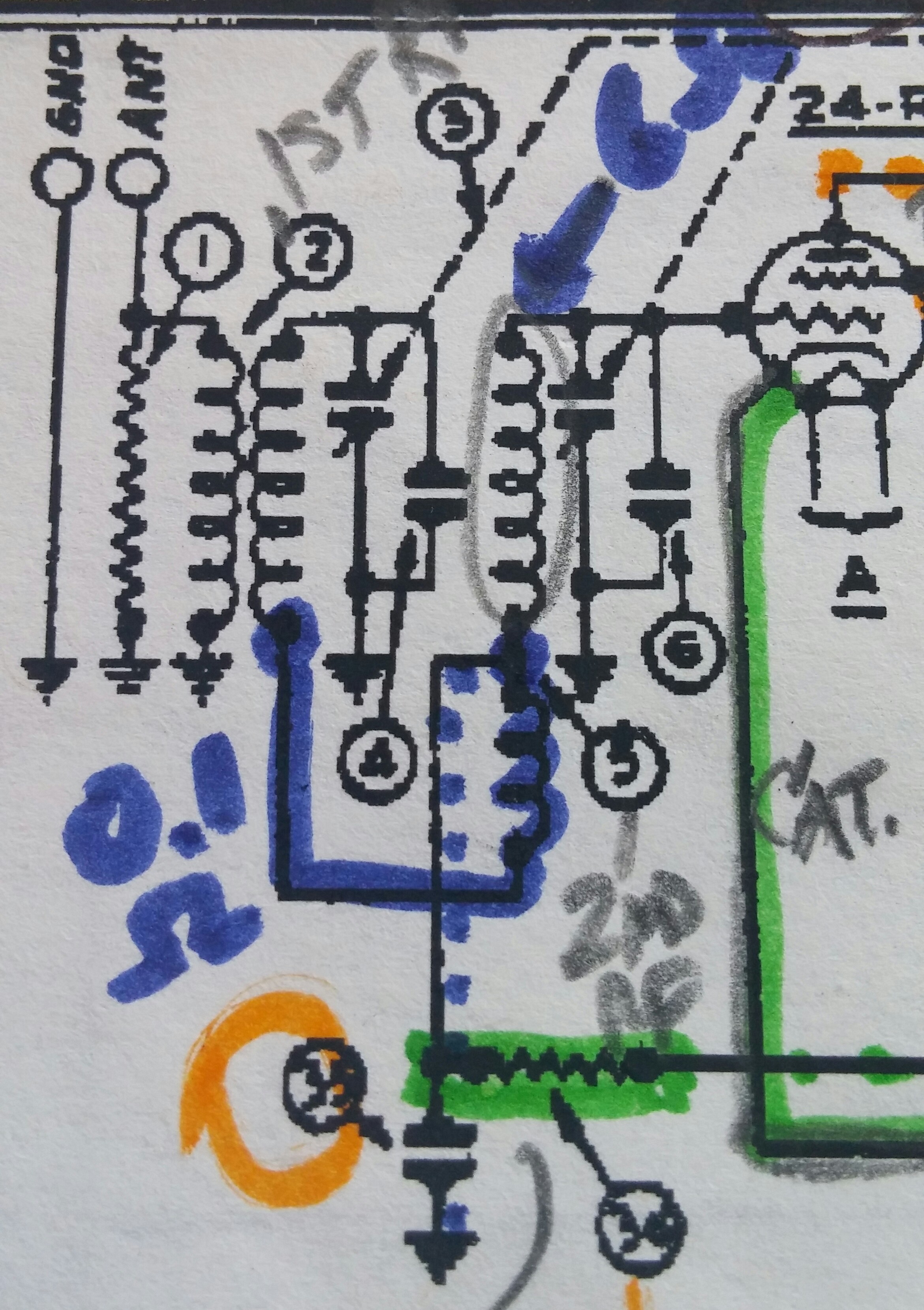

Hey guys....I've been troubleshooting the 90 (1-47) for awhile and need suggestions.  Problem=no signal or volume control UNLESS I ground either side of trimmer#11 to ground, then full clear signal returns with volume control as well.
 I've checked:
1. 80 tube and ecaps read good.  All coils are intact...HOWEVER 2nd RF has 2 coils from #5: the one to RF grid is good (6 OHMS).  The other runs from #5 to secondary of 1st RF.  THIS ONLY SHOWS 0.1 OHMS....is this open?? SEE ATTACHMENT OF SCHEMATIC

The RF coil resistance seems normal and would not cause the problem you are describing. If it measures 0.1 ohm it is definitely not open.
