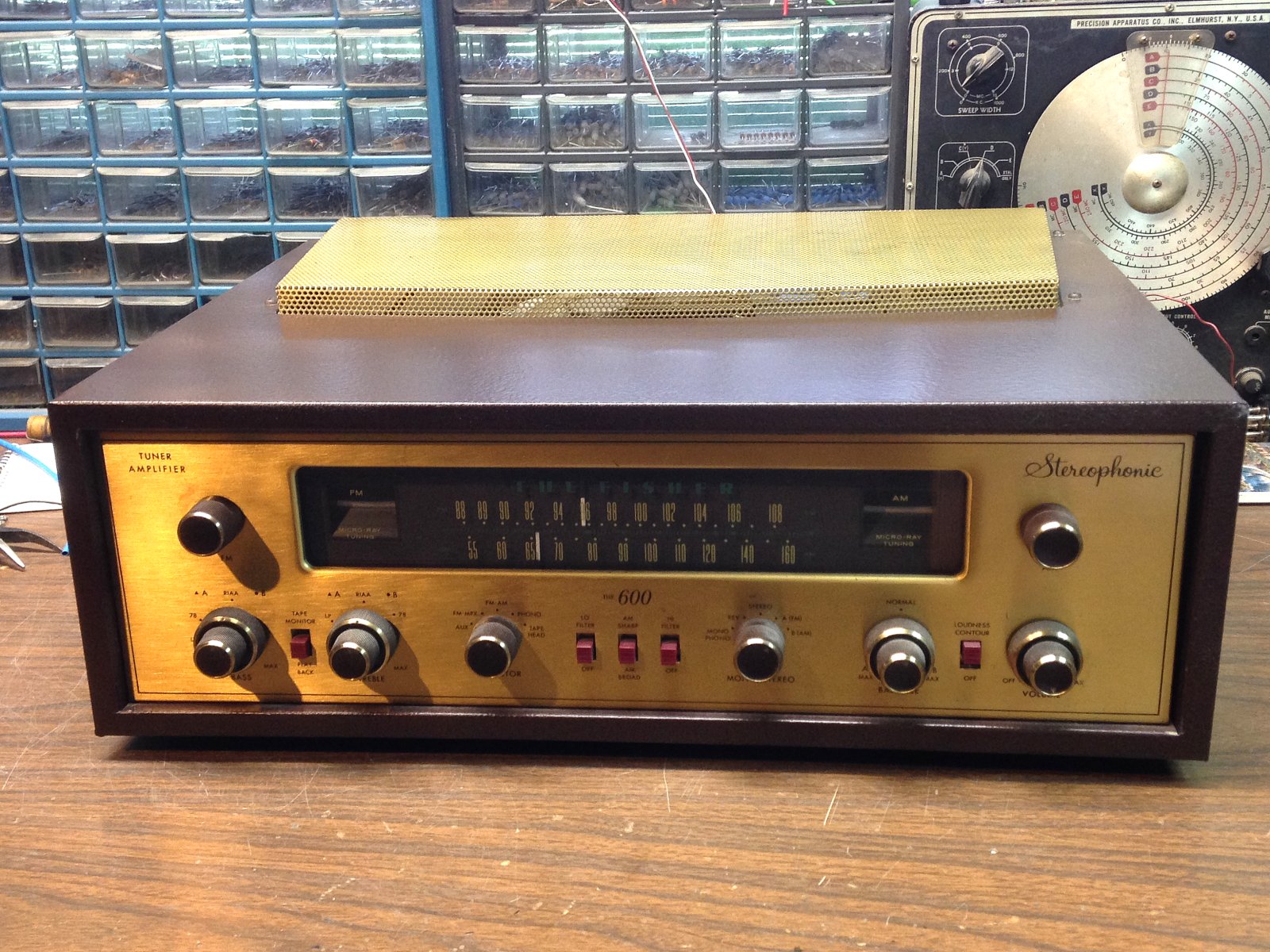

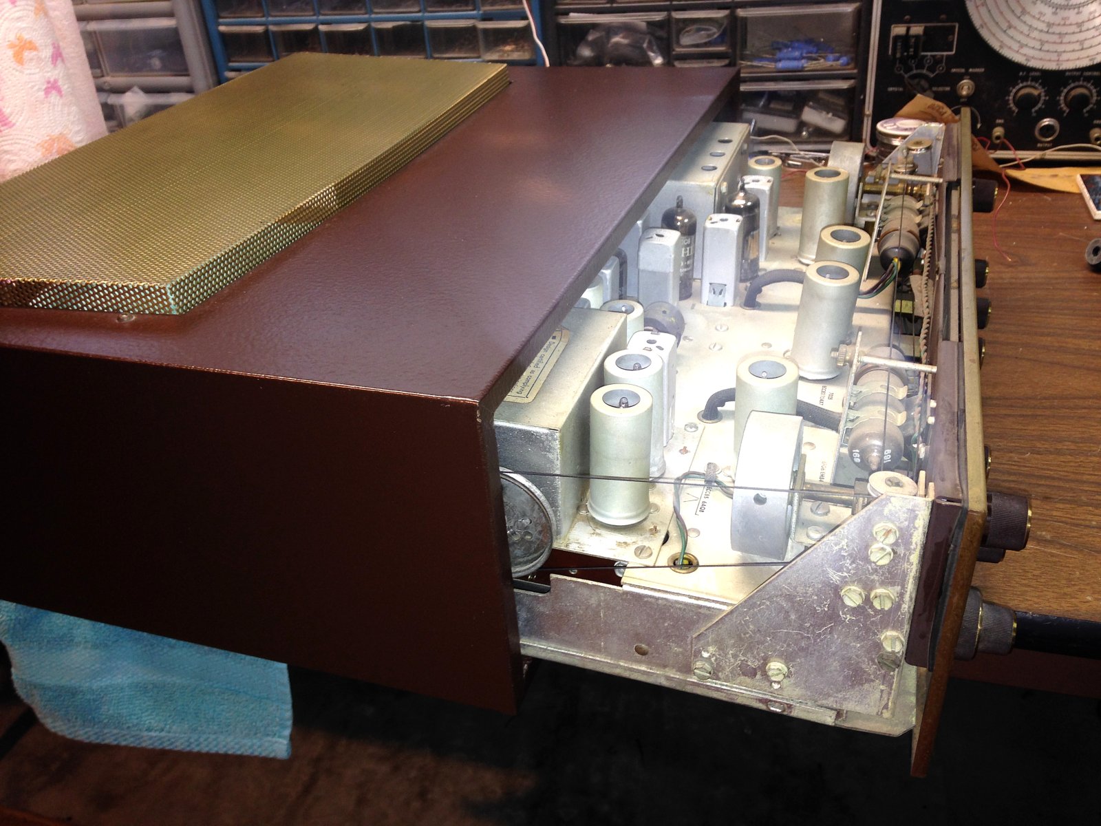

The receiver is held inside its metal (!) cabinet by the four screws which go through each of its four rubber feet. There are also four small wood screws underneath; don't bother removing these as they only hold two wood strips which help to hold the TA-600 in place inside the cabinet. It is the four long machine screws which pass through each of the four rubber feet which need to be removed in order to remove the receiver from the cabinet.
Once this is done, the receiver may be pushed and pulled from the cabinet.

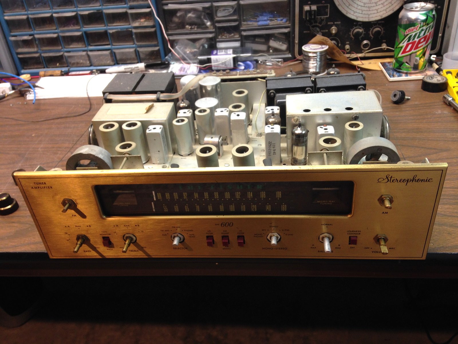

[Image: http://www.philcoradio.com/images/phorum...00_002.jpg]
Here is how it looks outside the cabinet.
[Image: http://www.philcoradio.com/images/phorum...00_003.jpg]
The front panel is made of brass. The panel on my set is in excellent shape with only a few minor scratches.

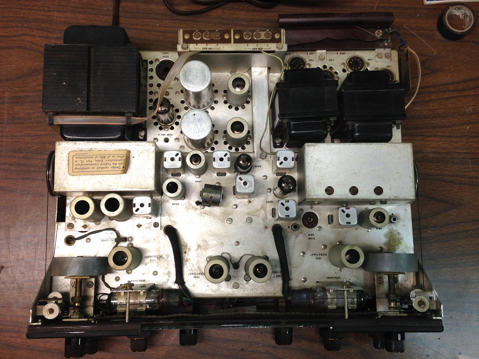

A look at the top of the chassis:
[Image: http://www.philcoradio.com/images/phorum...00_005.jpg]
The bracket which holds the AM ferrite rod antenna is made of plastic, and was broken in shipment to me.  I will glue it back together with epoxy, and I will put a piece of plastic across the back of the broken area to give the bracket extra strength. I will probably do that when I am close to being finished with this unit.

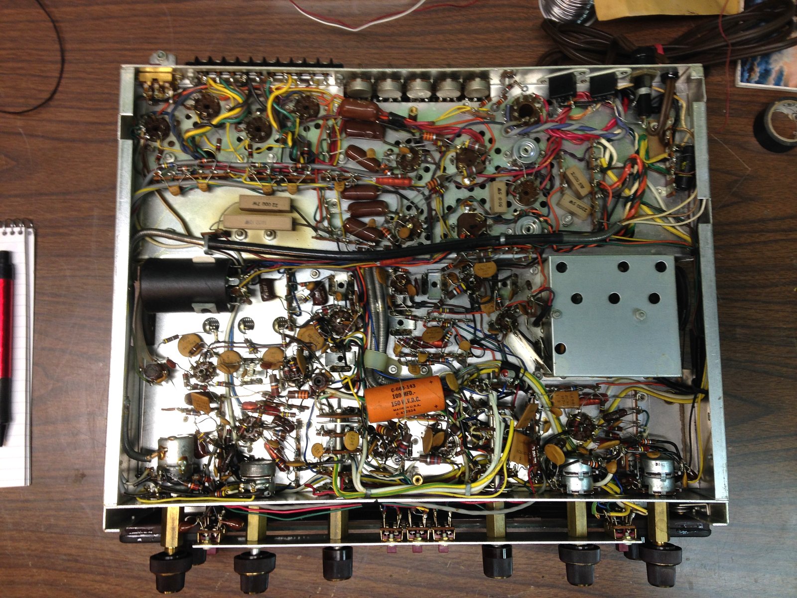

[Image: http://www.philcoradio.com/images/phorum...00_006.jpg]
Question:
Would you recommend replacing the brown molded Mylar caps, or leaving them alone? (They look like Orange Drops, only brown.)
All of the electrolytics will be replaced.
I will also replace the line-to-ground "Black Beauty" death cap.
I did not intend to bother the ceramic caps.

Ron, does the TA-600 have the selenium rectifier bias and DC filament supply like the later models?
If it were mine, I would leave the mylars alone. As you said, they are some other manufacturer's version of the Sprague Orange Drop.
Pretty much all the US cap manufacturers of the time bought their Mylar film from the same supplier ( Dupont),
so quality should be comparable to Sprague. I have tested several brands of the early dipped Mylar caps and they all test the same, with very low leakage. I have a bunch of NOS dipped Mylars of the same type and have been using them as replacements for years without a single problem
Mondial
The TA-600 uses hollow state rectifiers - two of them (5AR4/GZ34 for the amplifier section; 6V4 for the tuner section). No selenium rectifiers that I can see on the schematic. The 500-S and TA-800 were the first to use solid state rectifiers. The use of solid state rectifiers was continued into the 500B, 800B, 500C and 800C (as well as the 400, I believe).
Two of the 12AX7 audio amp tubes obtain their (DC) filament voltage from the 7189 cathode bias. The other two are tied into two of the three AC filament strings.
Thanks for your advice on the mylars. It looks like it would be a nightmare to get to some of those. It will be bad enough replacing the electrolytics.
