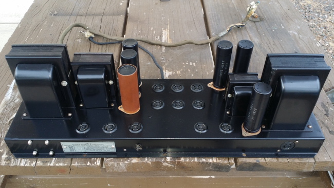

I have started another Strat chassis restoration. It will take a while.
I have started a blog post with pictures, videos and such that will touch on many of the aspects that make this radio special.
http://www.russoldradios.com/blog/anothe...estoration

Thanks guys. It will be a lot of work - again.
Updated chassis deconstruction and Allen Bradley controls.

Updates posted, variable IF, resistor kit and continued deconstruction. Almost ready for the chrome shop.

Updates on the Power/amp chassis including rebuilding the original filters.

Power/Amp all done - less building a new interconnect cable.

The chassis is back from the chrome shop.
Now where do all of those parts go - - -
http://www.russoldradios.com/blog/its-ba...estoration
